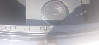

I have a Rockford Fosgate P300-12T. It fit perfectly in the trunk lower opening. Will connecting it to the 12V accessory location work? Is the 12V wires big enough guage for 300 watts and a proper ground?

I would run 8 gauge to the battery which is just to the right of that picture

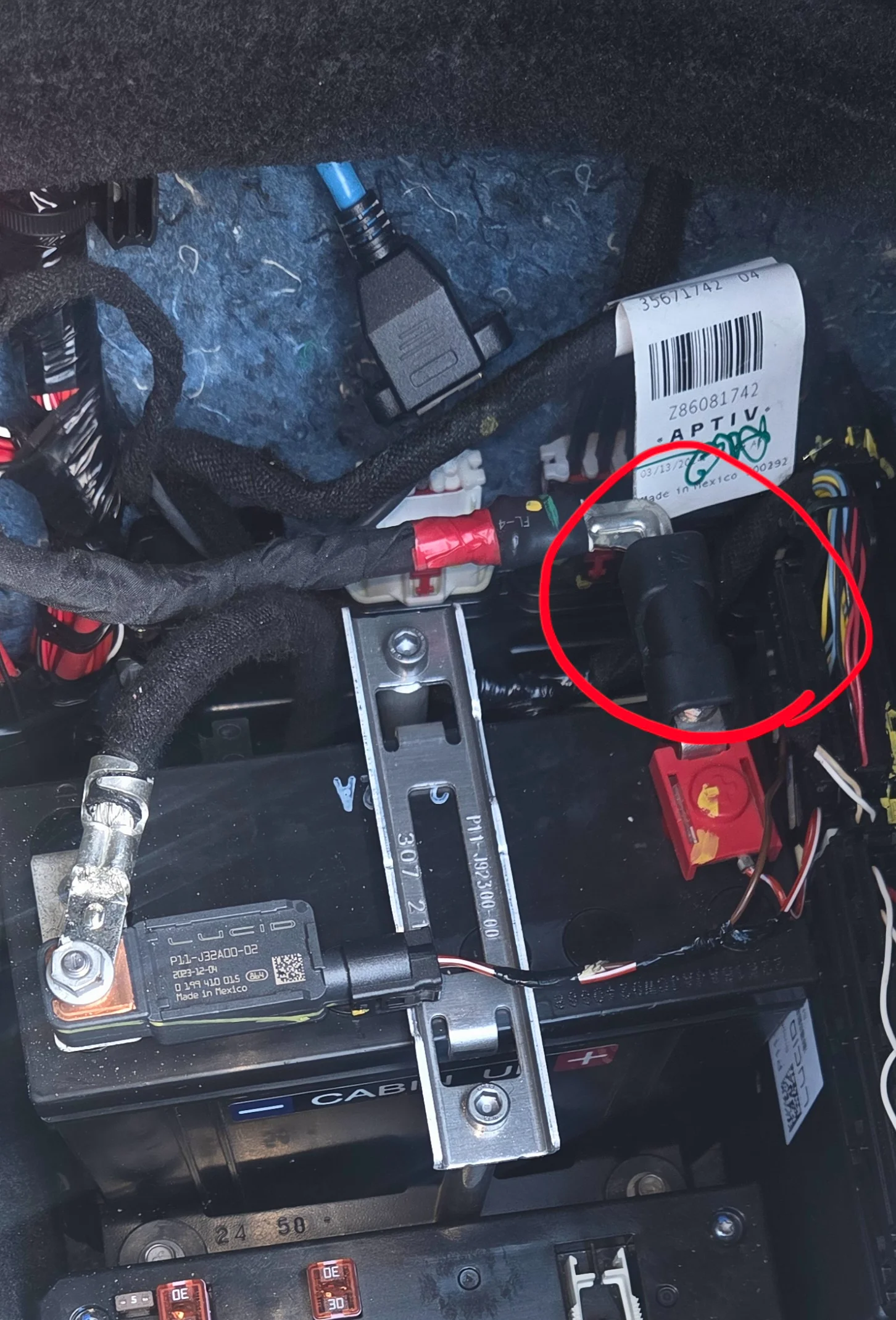

How do I remove the black sleeve circled in the attached picture? Also, I have read that if the 12V battery gets disconnected, it could mess up the car. How do you ensure that the connections going to the positive terminal do not get loose while you wire in the power connection for the powered sub?

Yes if you lose 12v power the car is dead
I’m unsure if simply reconnecting addresses this but based on the 12v “jumper “ point I think resuppling 12v would be fine
Not sure about any reboot time once power is restored
Not sure about the part that you circled, but I popped up the red cover on the terminal, removed the nut, installed my own cable with a ring connector on the post and screwed on the nut again. Don't think I ever had to remove the cable that is on the post. Lastly, put the red cover back on.

Thanks. I read that if the 12v gets disconnected it could be bad for the car. Seems like the red clip below is the place to connect power.

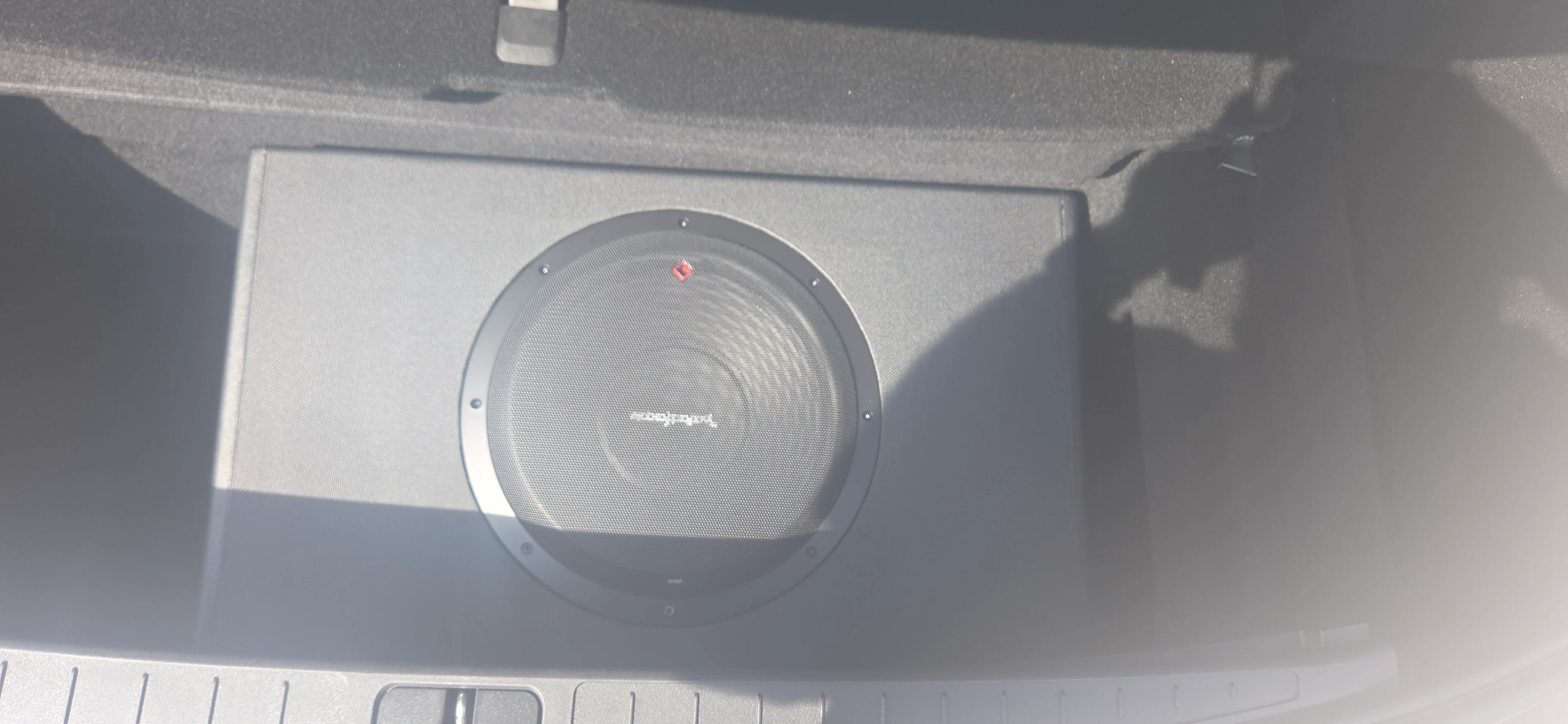

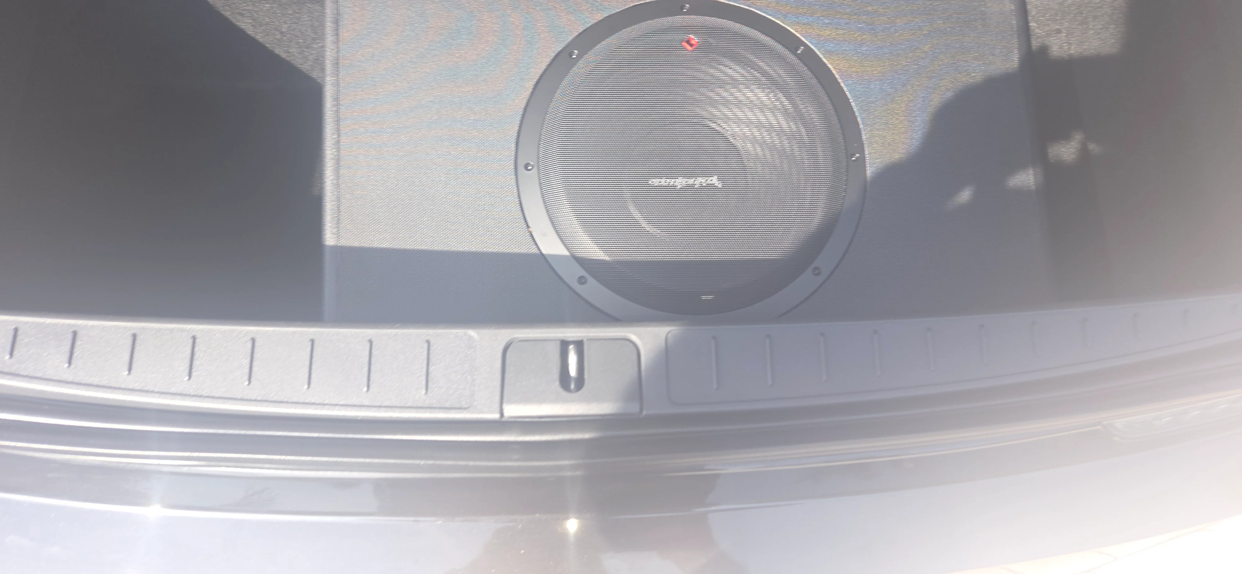

Thanks. Will try that and respond. I am putting in a Forgate P300-12T powerd sub. It fit almost perfect in the lower deck of the trunk, with the lid closing with no issues. Had it in my last car and it made a huge difference. Once done, I will send pics.
Please document the whole process :) I forgot to do it myself, but it could be a benefit for future sub installations.
For sure. Just needed help and want to help other people too.
I did talk to Lucid about adding a powered sub and if it voided the warranty. They said as long as done right and no shorts happen, that there is no problem tapping into the 12V battery and using the point near the trunk latch for a ground. They know of many other owners who have successfully done the same thing without voiding their warranties.
