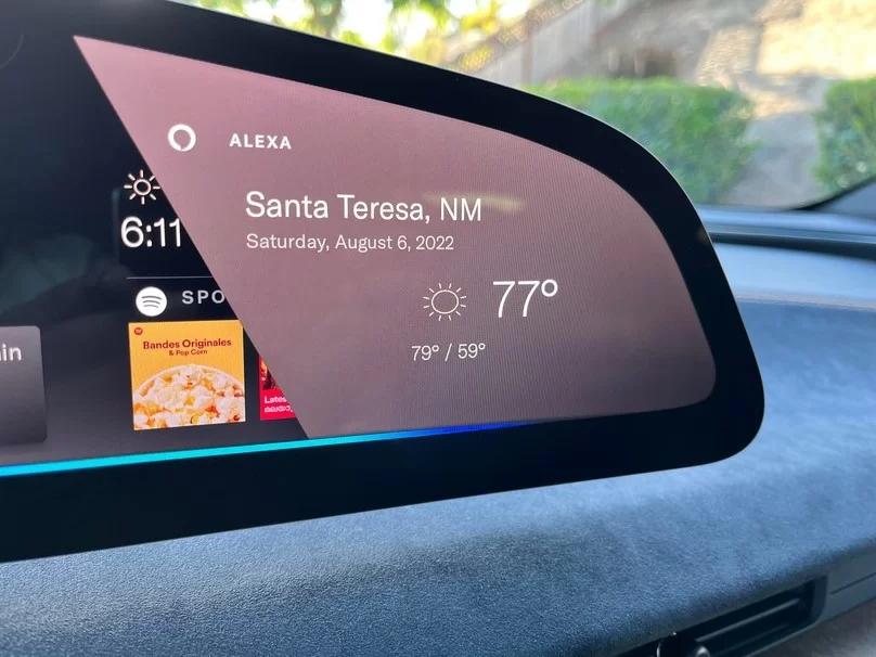

I really don't know what's going on at the back end of Alexa. Starting today morning, it thinks I'm in Santa Teresa, NM! It tells me the weather forecast for that place instead of San Jose, CA! I have asked Alexa countless number of times before this for weather forecast and it's always replied correctly with the weather for San Jose, CA up until today. When I ask Alexa for my current location, it spits out the right location/street in San Jose, CA.
Before someone asks, no my GT is not connected to the WiFi at home with some weird VPN setting that makes it think I'm in NM. I have never entered my home WiFi credentials.
Are you asking “what’s the weather” or “what’s the weather in San Jose”?
I’ve had this happen and it’s given me some random location when asking “what’s the weather” but when I ask for the specific location it’s works. It’s stupid, I know but a possible workaround until Lucid/Amazon get the GPS data properly.
Lucid should’ve just paid the licensing for google voice / assistant. Alexa isn’t ready for cars
