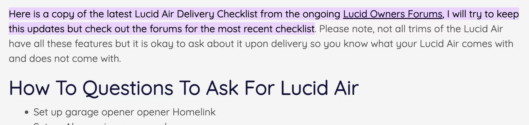

Thanks to our wonderful members for compiling the lists of checklists for delivery, particularly @SaratogaLefty with his post HERE and subsequently @zkhan2 with his list HERE. I'm going to post the most recent checklist as some of the earlier items no longer apply.
