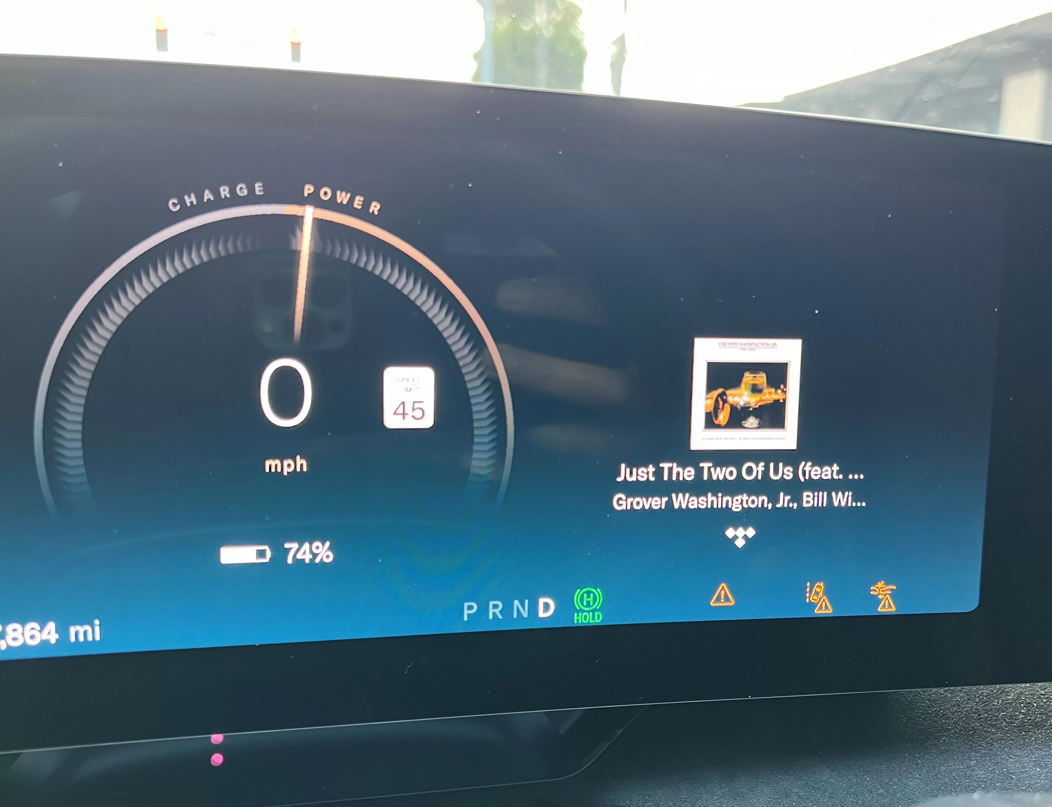

Updated this morning, decided to make a Costco run during lunchtime. Temps in the low 90's, parked and kept climate running. Came back in about 1.5 hrs, when I went to drive the below two icons (ignore the dusty screen, waiting for the weekend for a bath) were showing and speed limit signs were not recognized during the ride home (about 20 min). I believe that they are lane departure and forward collision warning were not functioning, I didn't notice if any text popped up as well, if it did, it was quick. Rear cross traffic was still working (different sensors in the rear). Haven't rebooted or checked since getting home. I've had such errors when DCFC at the peak of summer last year but they clear right away. Has anyone else had these errors and had service do anything that can address them?
Looks like I encountered the same issue on my way into the office this morning. I don't think it is temp related … my car was outside last night.
Are you adjusting traction control? I believe those are the same ones I see when you move it off Full.
I noticed them after I backed out of my driveway but they went away after began my drive.
Were you parked facing the sun?
Just tested it; the attached are the traction control lights. The yellow exclamation ⚠️ wouldn’t be lit if that were the case.

Nope ... They came on as I started my drive to work. It wasn't sunny yet. Issue occurred again this morning so I have an appointment to have it checked out on 7/10.
The warning lights are for:
a) Lane departure protection disabled or system fault detected
b) Collision protection fault detected
c) System alert.
Service suspects possible sensor or calibration needed.
c) System alert.
Will be interesting to hear what actually caused the issue. Maybe it was lingering and just a coincidence it happened after the OTA install but if the OTA triggered it and the only way to fix is via a calibration then that's annoying because that means you have no choice but to go to the Service Center which is what the whole OTA process is meant to avoid.
Hopefully its just coincidence but I did get some random big orange message pop up on the cockpit yesterday so quickly that I never actually go to see what it was. This is the one thing that does annoy me with the Lucid. If you miss the message too bad so sad. You can't see \ find it anywhere. It's the same issue when a message pops up then moves to the explanation mark icon. The icon just stays there and no way to know what its griping on about. They should add a "System Messages" section under one of the cars settings menus
