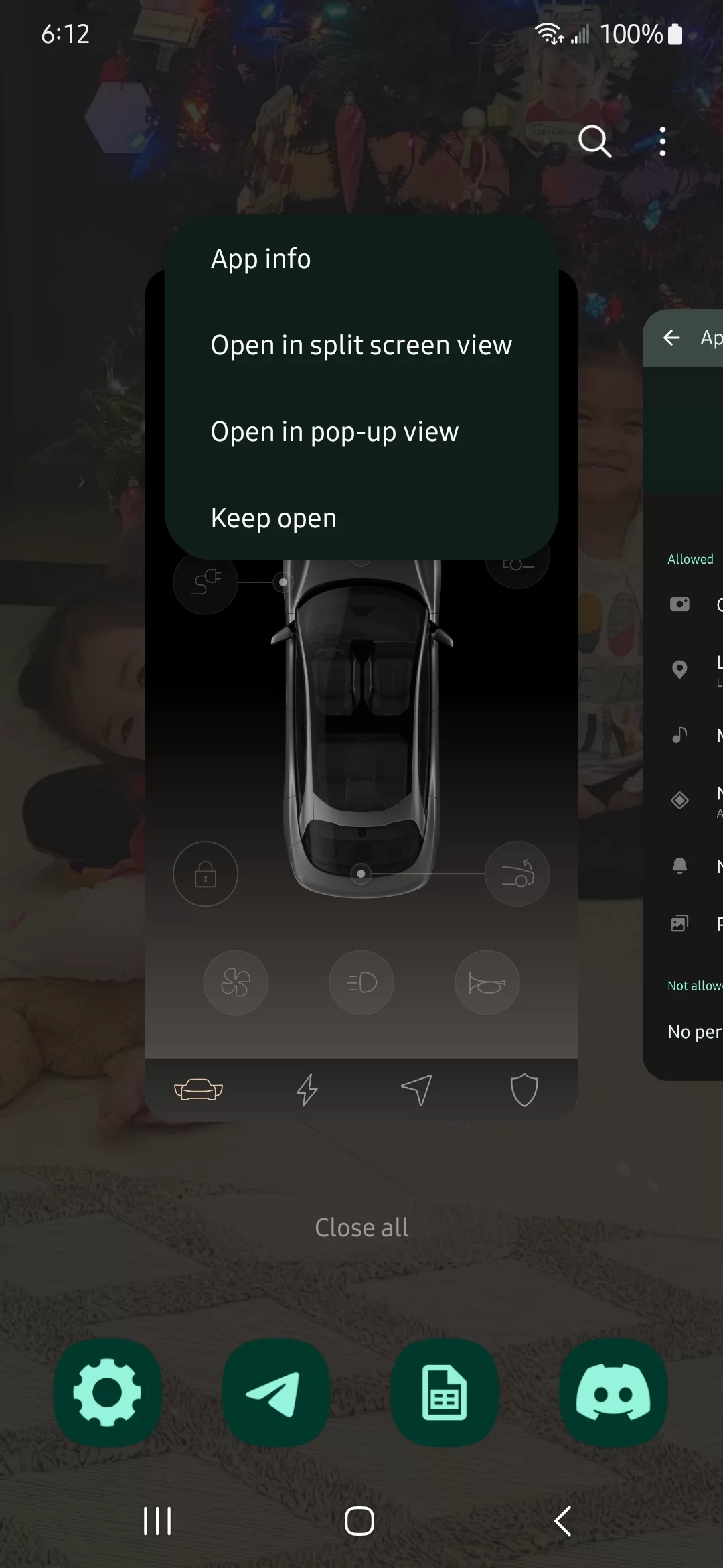

Android needs to have app never go to sleep in order for it to work. See picture below for option. You need to select keep open.

Open the app then do the following:
Could you explain how you got to the App info screen ? I found it on the phone under apps but can't find the screen you show with " keep open" is the circled L a button ? mine is not.
Open the Lucid app. Then go into your recent apps from your home screen. Tap on the Lucid Logo and it should bring up the menu. This is on a Samsung S22 though, no idea about Pixel, but it should be very similar.

Hmm. I'll try changing location to "Always" and seeing if that helps it a bit. Pixel doesn't have the Keep Open toggle 😕
