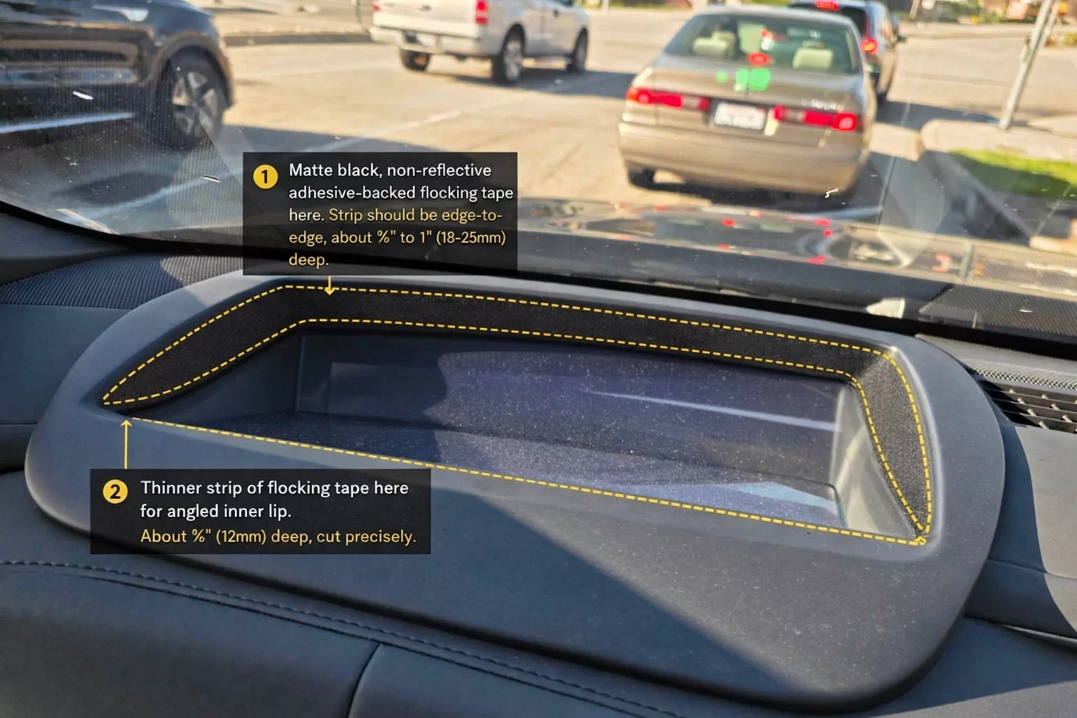

Here’s a possible solution:
Buy this:
This is the same glare mechanism seen in:
  • Fighter jet HUD hoods
  • Aviation HUDs
  • BMW / Audi / GM HUD complaints
  • Camera viewfinder ghosting
https://www.bhphotovideo.com/c/product/1364750-REG/japan_hobbyE4E078A5-A7BE-4642-9A26-7E36AE263560.webp_tool_jht9538_light_trap_material_flocking.html/?ap=y&ap=y&smp=y&smp=y&store=420&lsft=BI%3A6879&gad_source=1&gad_campaignid=13534612267&gbraid=0AAAAAD7yMh2sLPdnIR5djJzzwaJ2MVSDC&gclid=Cj0KCQiApfjKBhC0ARIsAMiR_IsWEbssv-ZwpFtQKfb3Q4KBGLbk0UxMCwOw6zCb4z1vKg67aKeUZVgaApqTEALw_wcB
Apply to the areas indicated in the attached photos.

That won't really help with the reflection of the frame in the window though. That plastic frame outside of the flocking is a problem too.

Did this offer any improvement? For me, the artifact of the top of frame (upward faces surface) is the most annoying thing. I don’t seem to have a problem with the blue bubble as long as my seat is high enough.

By the way, your lens looks dirty, like mine. Unfortunately, on mine it’s under the lens where I can’t clean it.
