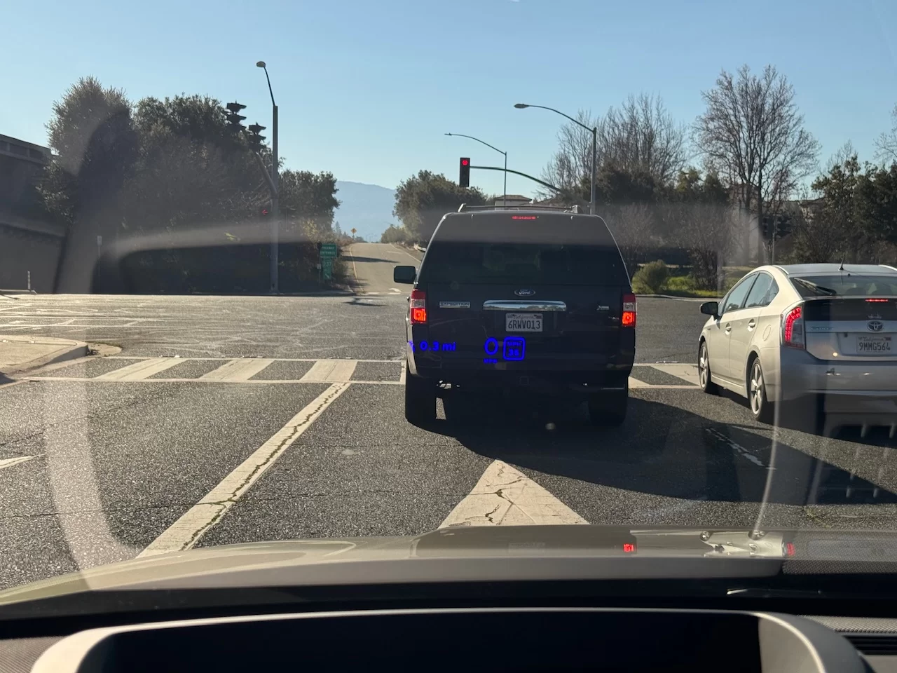

@RLead8 @RandomDesign @ClearlyLucid You are all partially right. Reflections are coming from both the inside sides the frame as well as from the top surface of the frame. It all depends on the angle of the sun. @RandomDesign even in your own pictures, the right hand side of the HUD reflection is coming from the inside side of the frame. I’m adding my own picture where you can clearly see the reflection is from both inside and top surface (at the top of the HUD reflection).

The discussion was about putting a light blocking material only on the insides of the frame and whether or not that would eliminate the reflection entirely. Even in your picture most of your reflection is the outside/top part of the frame. Even the top of the reflection you talk about (the bottom of the frame when looking down at it) is a reflection of the outside part of the frame (that entire top left corner) that wouldn't be covered by the template that was posted earlier in the thread.

Based on this pic I would say most of the reflection is from the top of the frame, although I agree it probably depends on the angle of the sun. My flock/Alcantara material is arriving tomorrow morning. Sunday is supposed to to be sunny. I’ll try and post some pics of the experiment.
