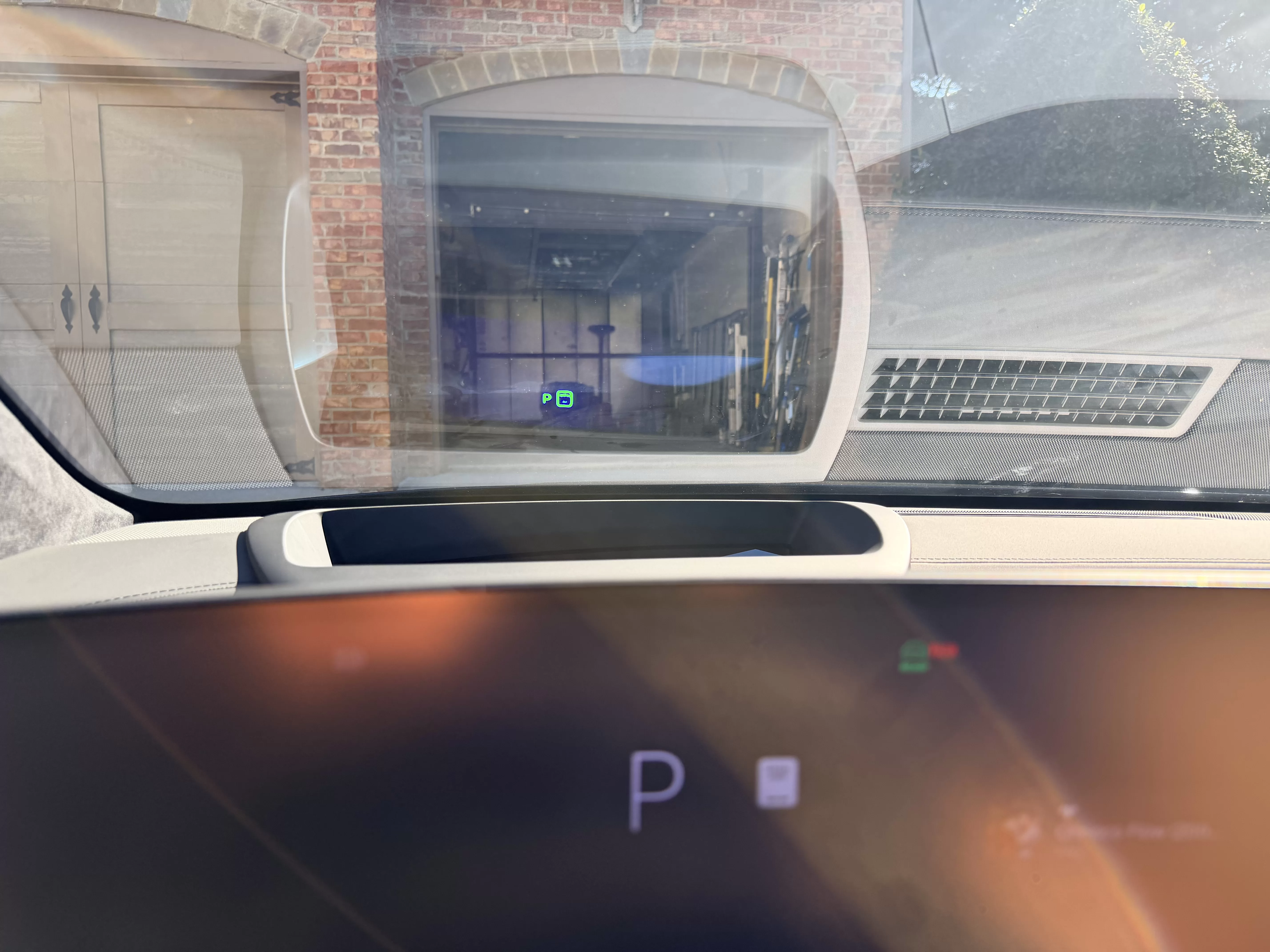

Every car I’ve driven has bad dashboard reflections depending on the angle of the sun. If the HUD reflection wasn’t there, the dash reflection seen on the right side of the photo below would replace it. Yes, the HUD may be more noticeable, but it becomes background noise. I use the HUD, and I love it for navigation. I’m hoping for AR features, but I know full well that it may never come.

The discussion was about putting a light blocking material only on the insides of the frame and whether or not that would eliminate the reflection entirely. Even in your picture most of your reflection is the outside/top part of the frame. Even the top of the reflection you talk about (the bottom of the frame when looking down at it) is a reflection of the outside part of the frame (that entire top left corner) that wouldn't be covered by the template that was posted earlier in the thread.
In the HUD reflection nearest the top of the windshield, the left side starts with the outside part of the frame, then transitions to the inside part of the frame. You’d need light absorbing material on both the inside and top of the frame.
Yes, but again you were coming into a conversation about whether putting material only on the inner edges would stop all of the reflections. Which it clearly won't from both my image and yours.
You are correct. Simply focusing on the inner edges is not sufficient. Both the inner and top edges will need to be dealt if you want to reduce the reflections from the HUD casing.

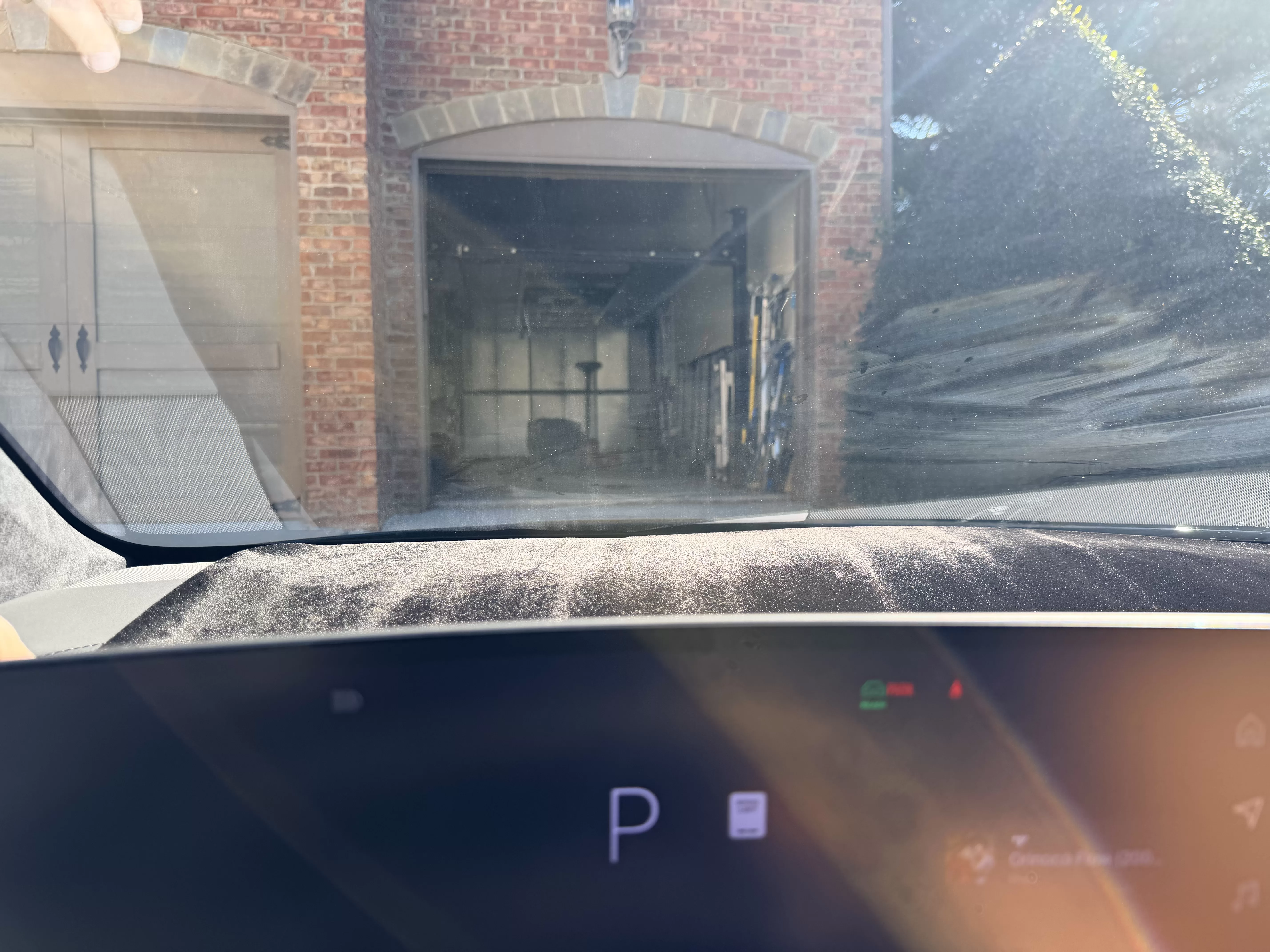

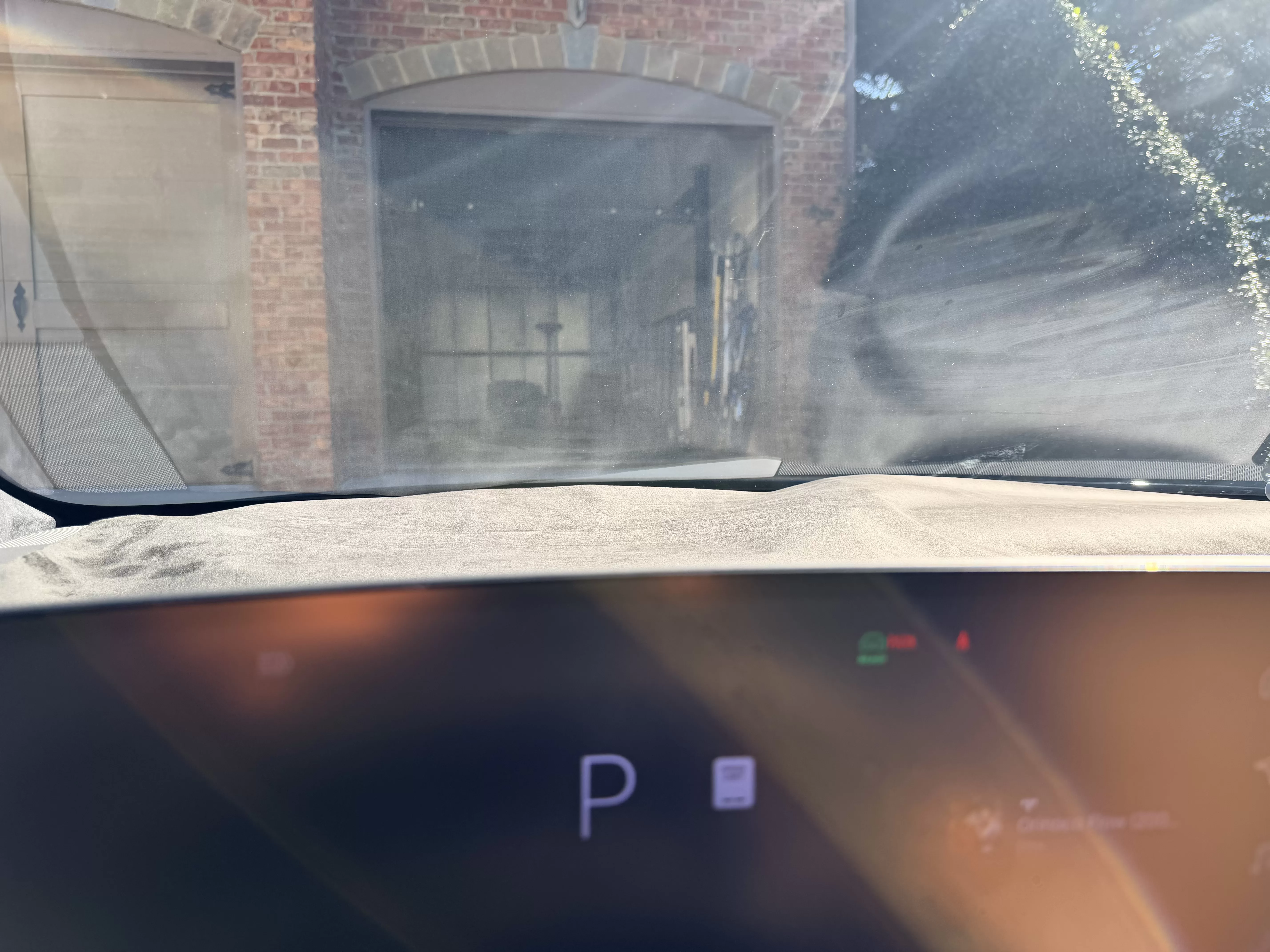

So, the flock materials from Amazon arrived. I decided to take 3 quick pics before Sunday Funday and football games. I’ll wait to cut this out when it warms up a bit in Atlanta later in the week. Both materials do a good job killing the reflections. I may take this to my PPF tech. He can probably install it a lot better than I can. Then there’s the issue of longevity. How does the adhesive hold up in the sun over time?
Pic 1: Baseline with no material. Mega reflections.
Pic 2: Velvet flock material, similar to what would be in a jewelry box (this has too much sheen)
Pic 3 : Alcantara material (I thnk this is the best. It has no sheen, although it does show brush strokes.)

Did you put it on the entire dash? The vent and dash reflections appear in the baseline photo but don’t appear in the other two photos.
He's just testing the material's reflections and laid it over the whole dash.
That makes sense. Looking closer, I see the material laid on the dash. Reducing the entire dash reflections and not just the HUD would be nice. This should go into Lucid’s design!

Judging from the second and third picture, an improperly cleaned windshield is as bad as the HUD reflection.
Yeah, the windshield didn’t look that dirty when I took the pic, but it definitely needs cleaning.

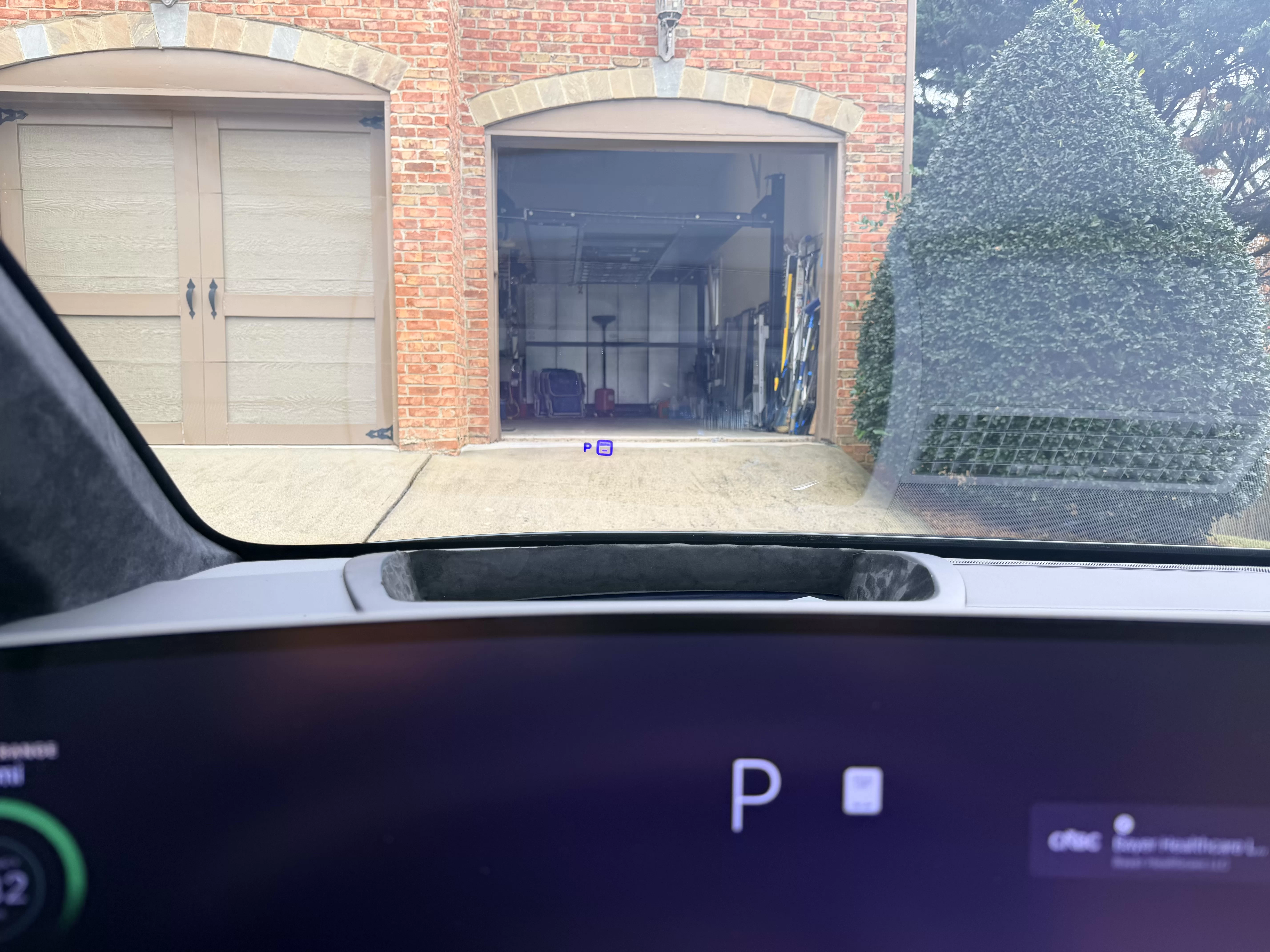

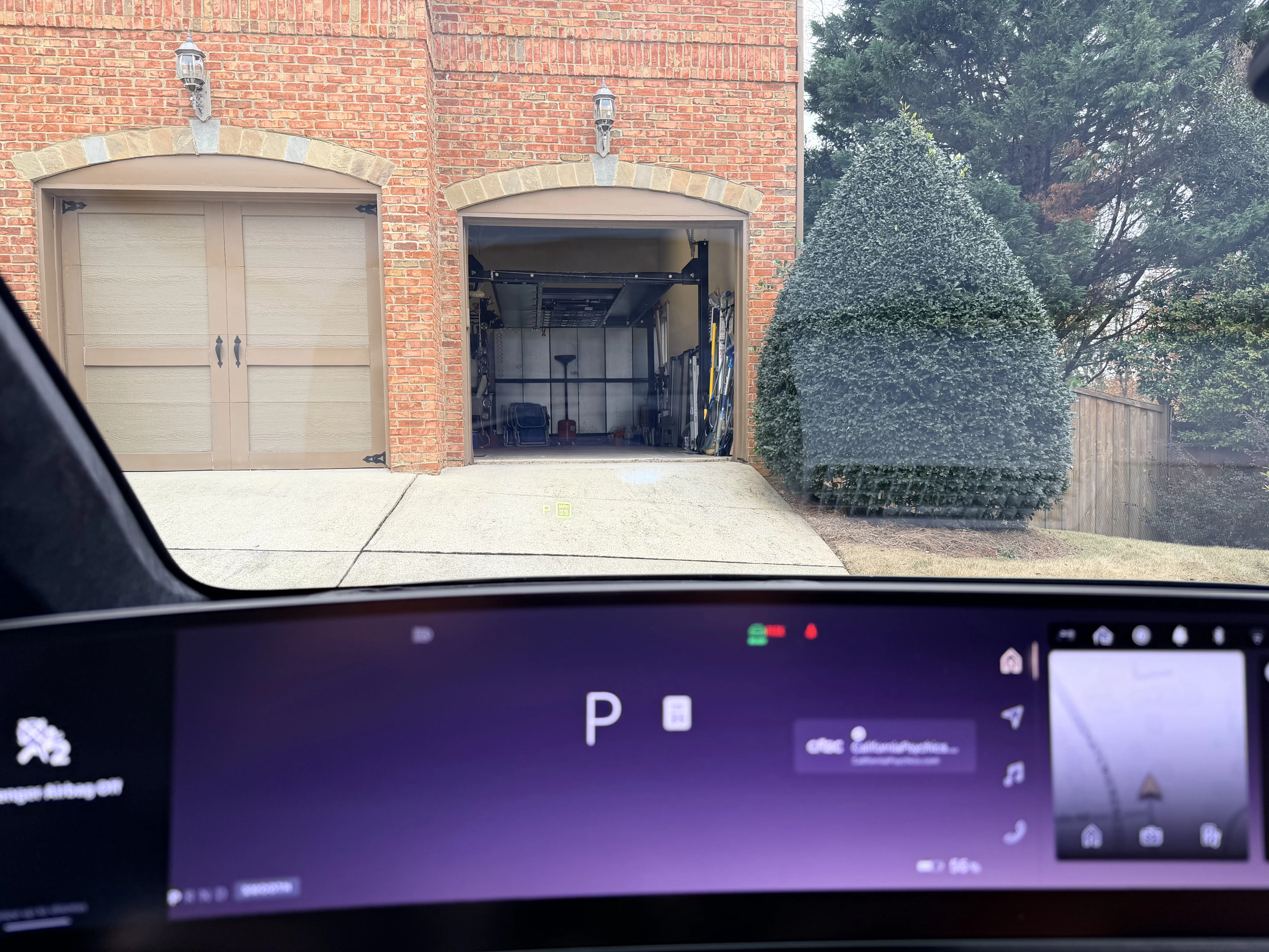

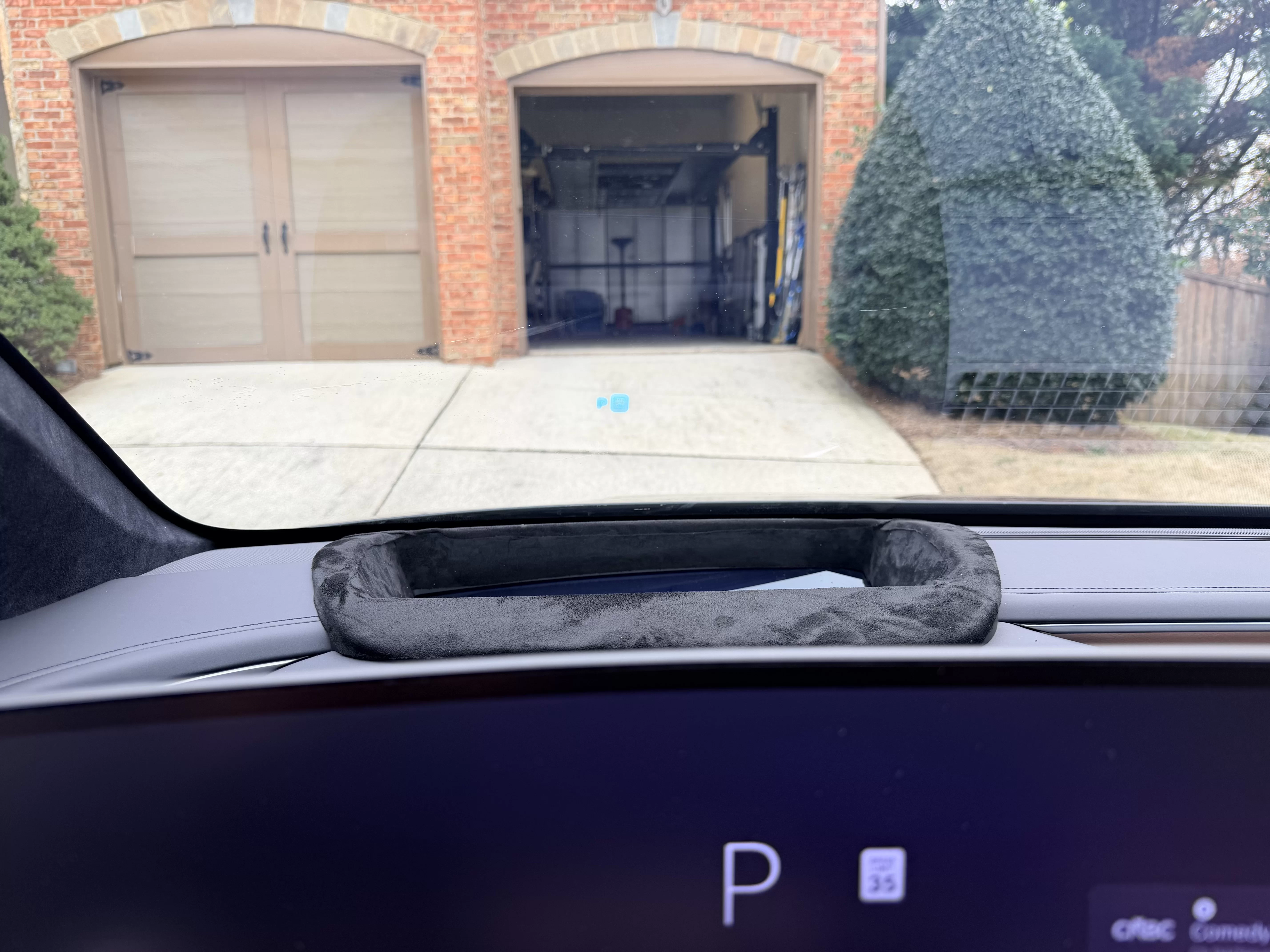

So. I finally finished putting the Alcantara material on the top of the HUD frame. From what I can see it has totally eliminated the HUD frame reflection in the windshield, although today is not a sunny day (we’re about to get snow in Atlanta).
Pic 1: Baselline (very sunny day)
Pic 2: Alcantara applied to top and inside walls of HUD frame. No reflections, although, overcast day. Will need to take a pic on a sunny day. For comparison you can still see the dash defrost vent reflection in the windshield on the right.
Pic 3: View of windshield from normal driver’s position. Note that you can’t see the Alcantara covered HUD frame from back here.
