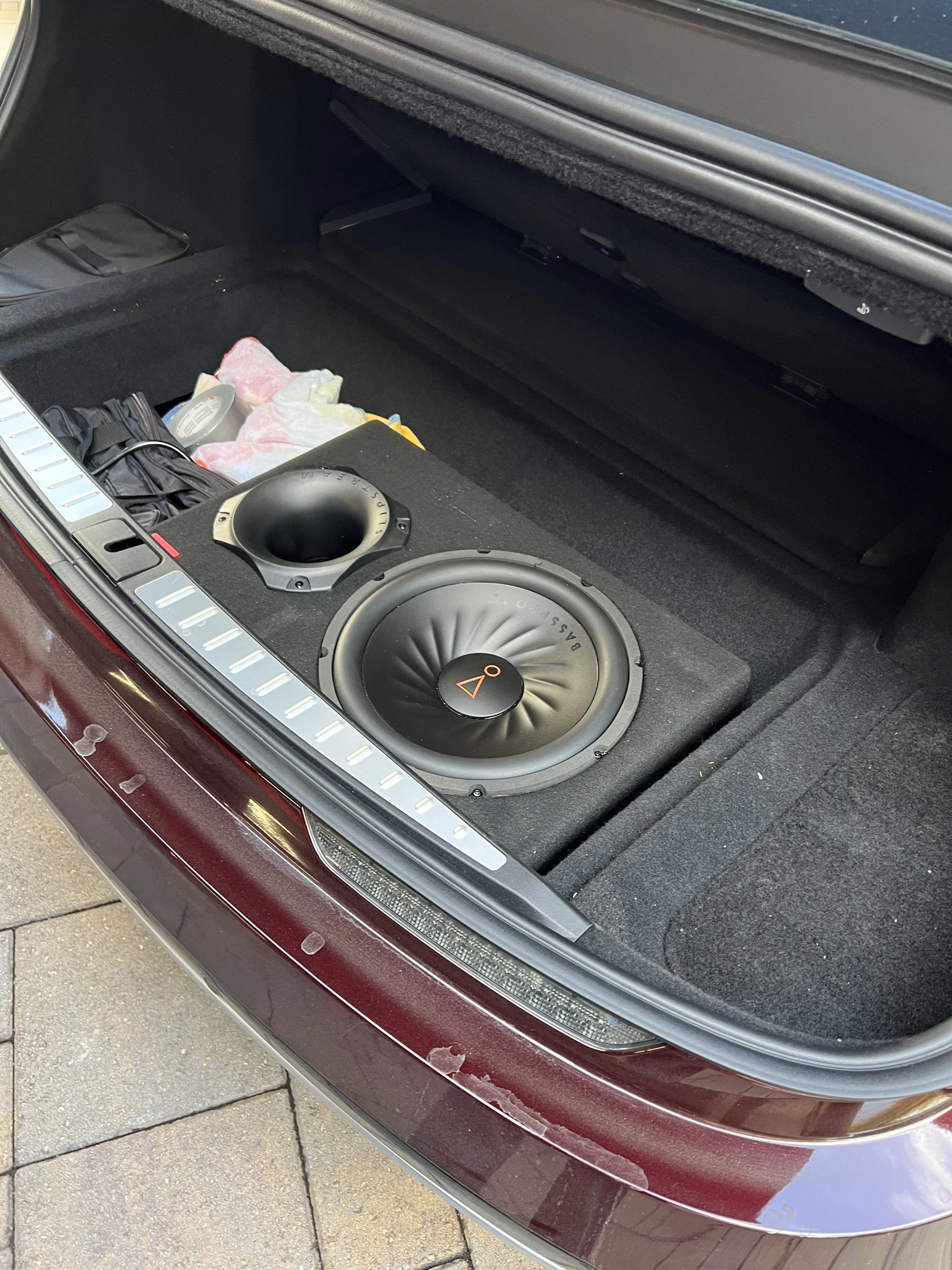

Below is my novel solution: I purchased an enclosed self powered 12 inch JBL subwoofer from Amazon. I originally intended to place it in the frunk but ran into too much difficulty plumbing the wires from frunk to cabin so instead I placed it bottom enclosed part of rear trunk.

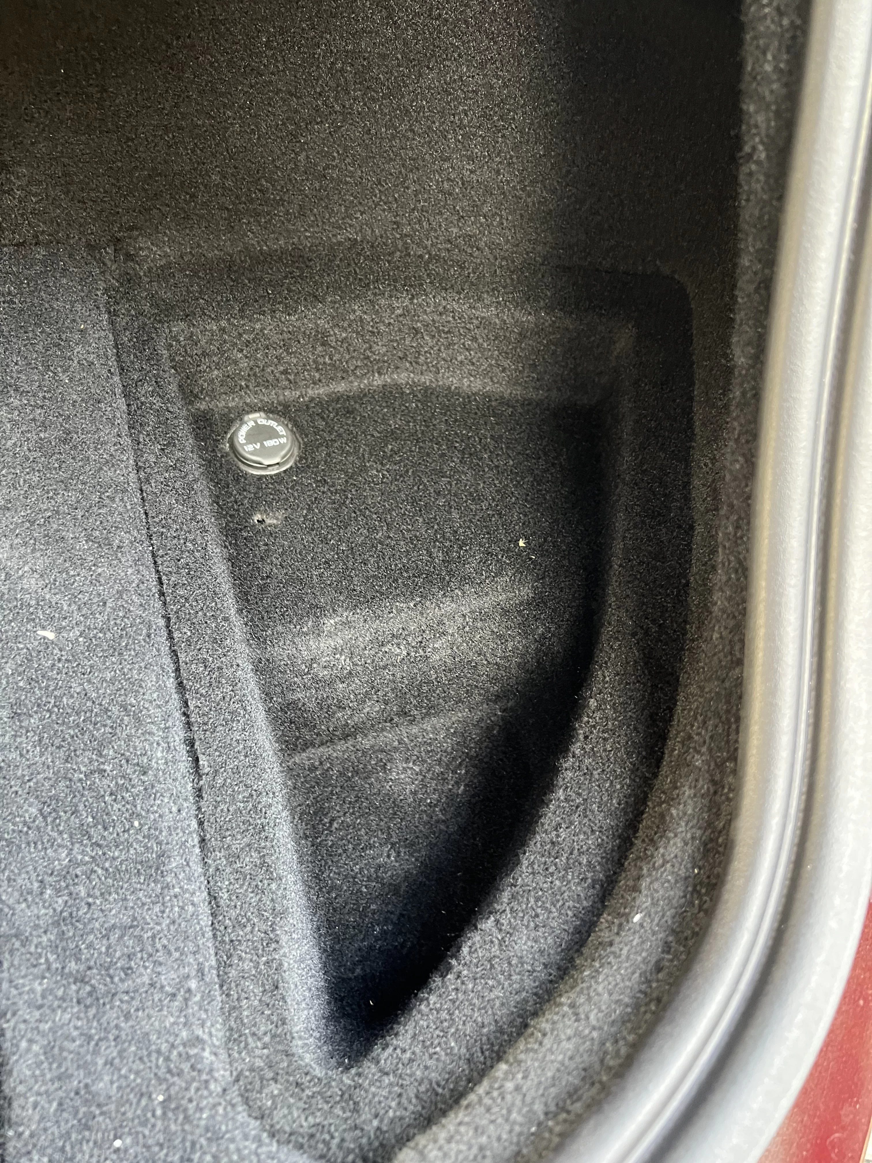

I took the power supply from the right sided 12v outlet. It is switched meaning power shuts off about 30 seconds after you lock the door and walk away from the car. To access it just pull the trunk liner straight up and take a parallel feed.

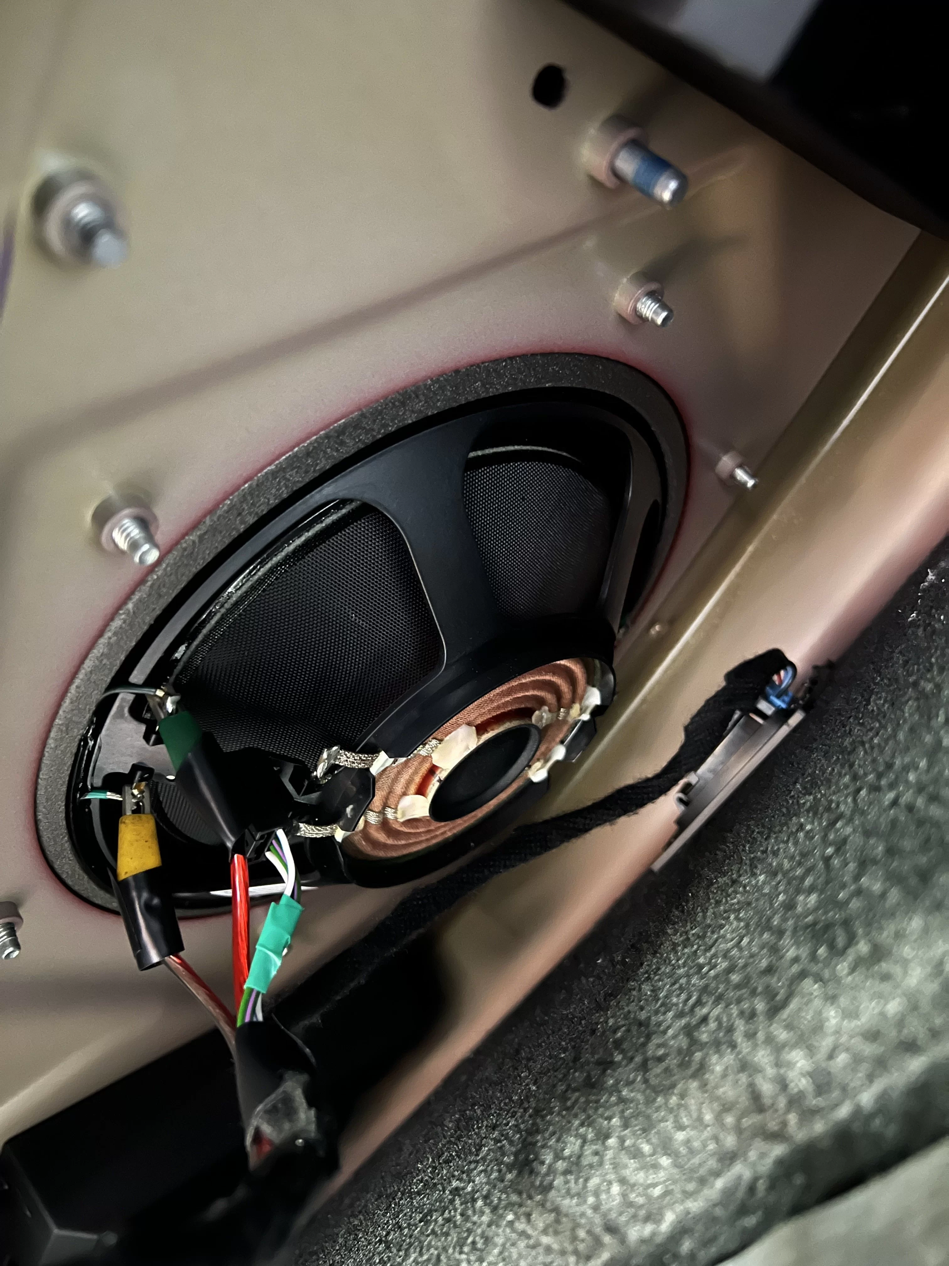

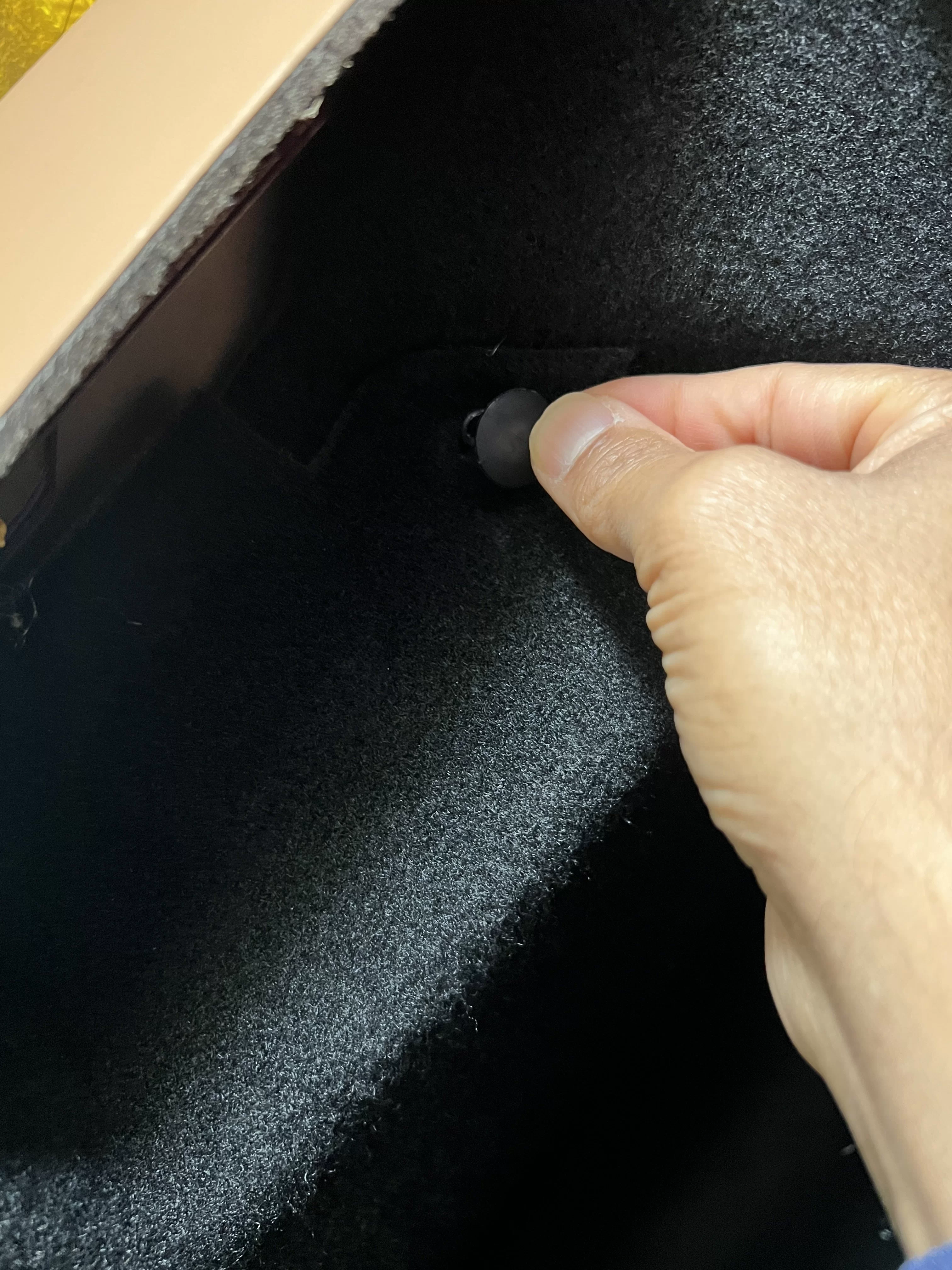

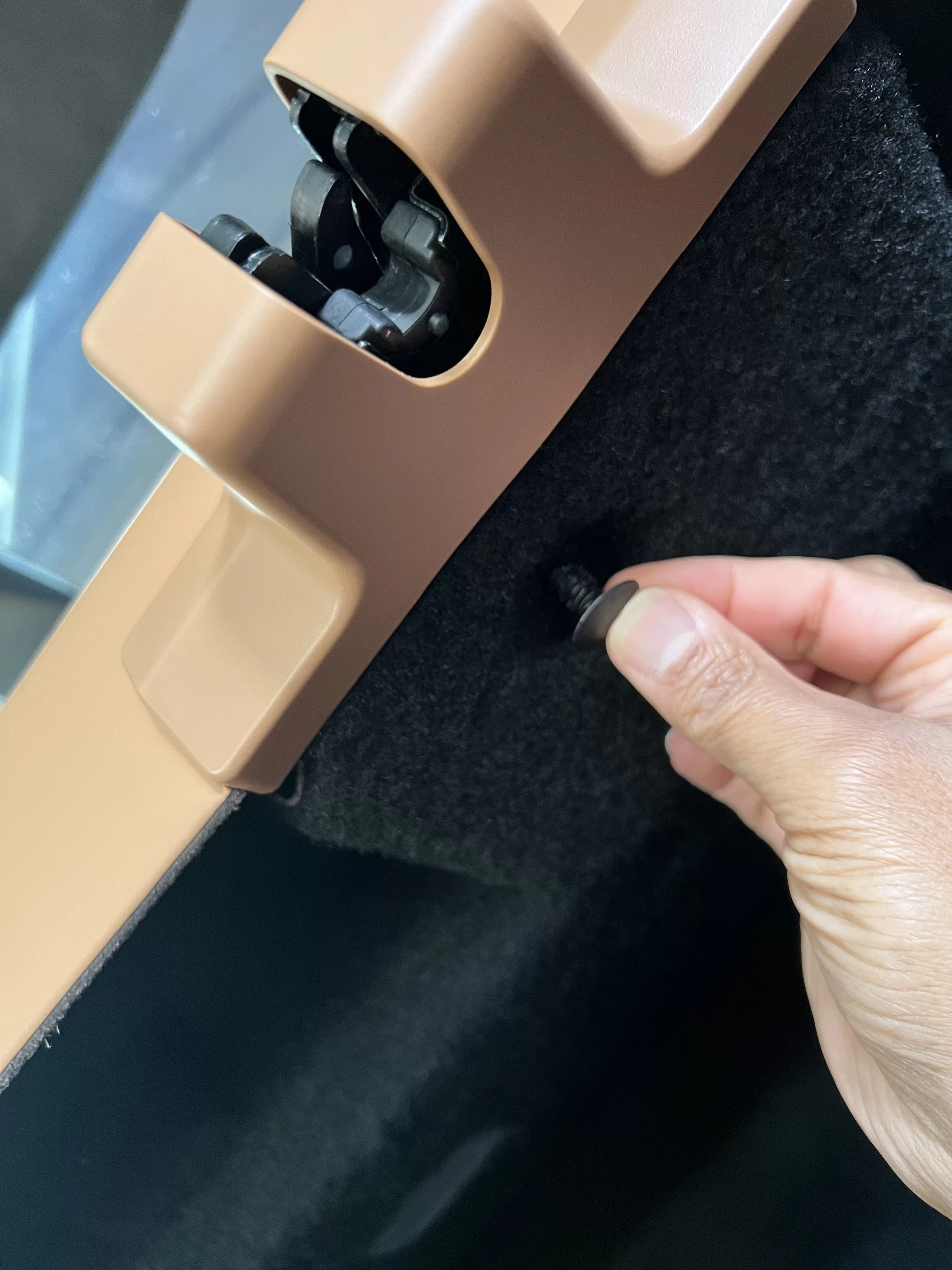

I removed the trunk liner just behind the rear seats to expose the Lucid subwoofer below rear package shelf- use screw driver to pry out plastic plugs

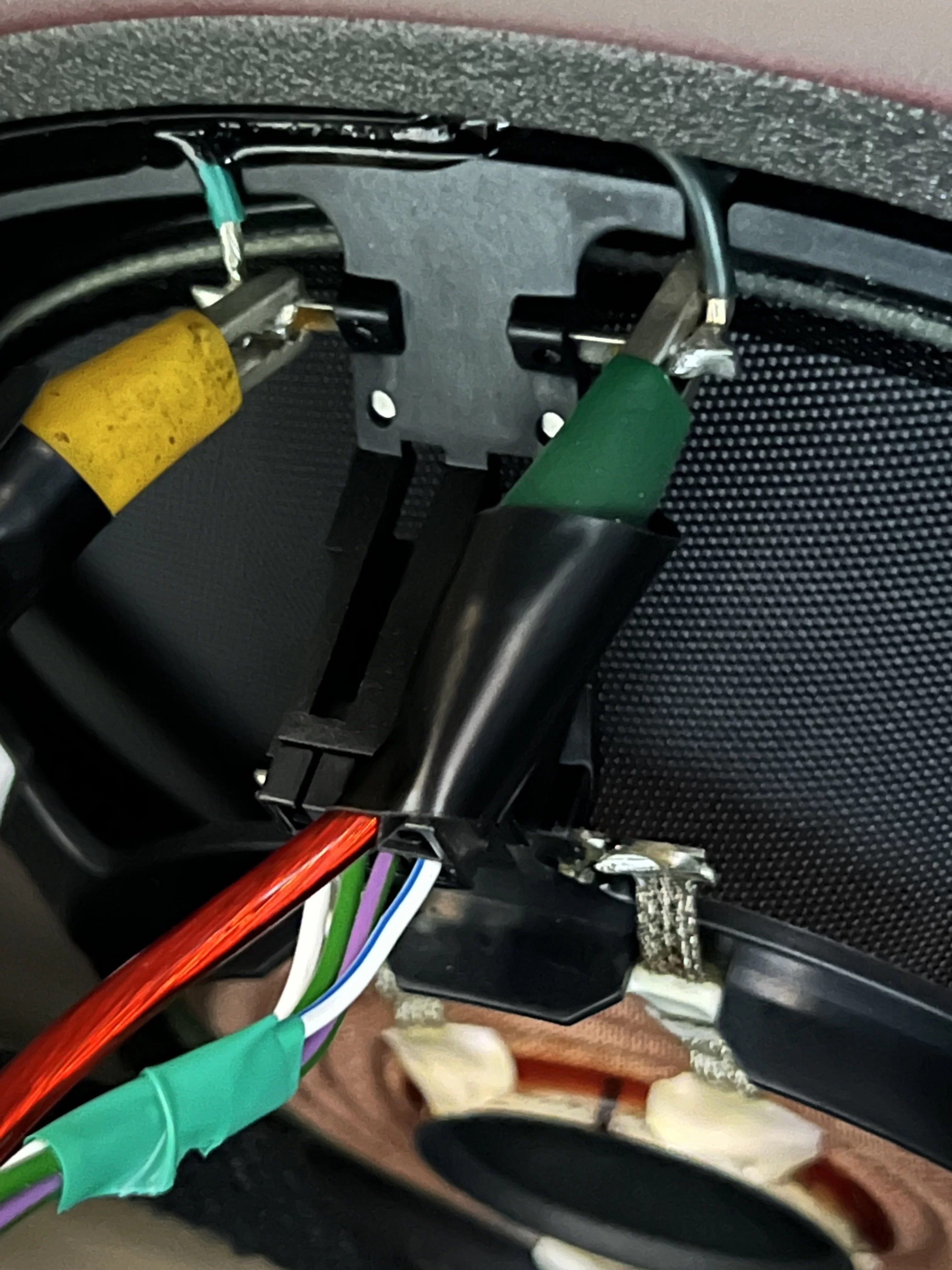

This gives access to subwoofer's wire leads. I used two aligator electric clips to take a parallel feed to the JBL subwoofer. I did not cut lead or disinstall native Lucid woofer. At some point I should probably go back and solder them...

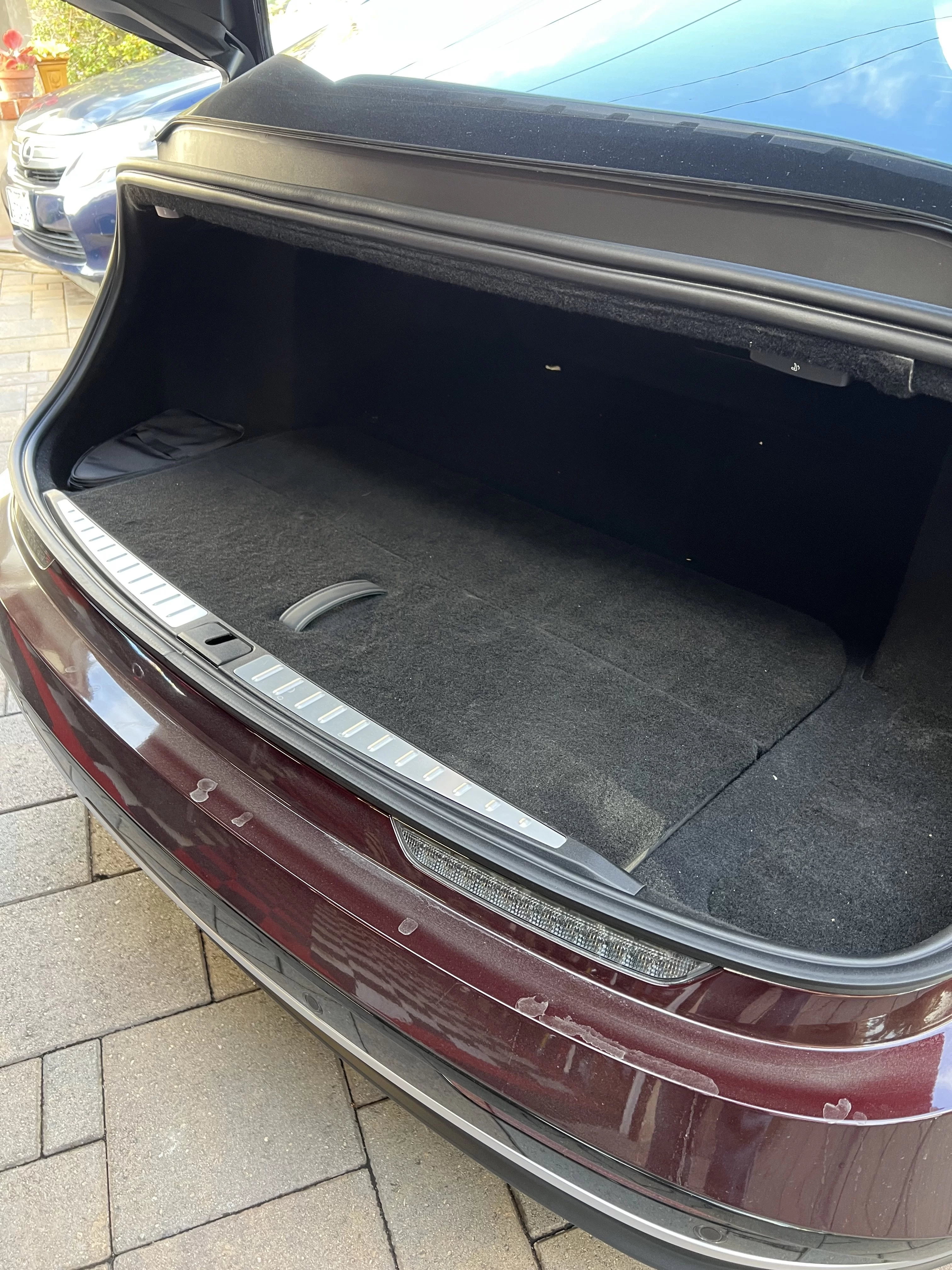

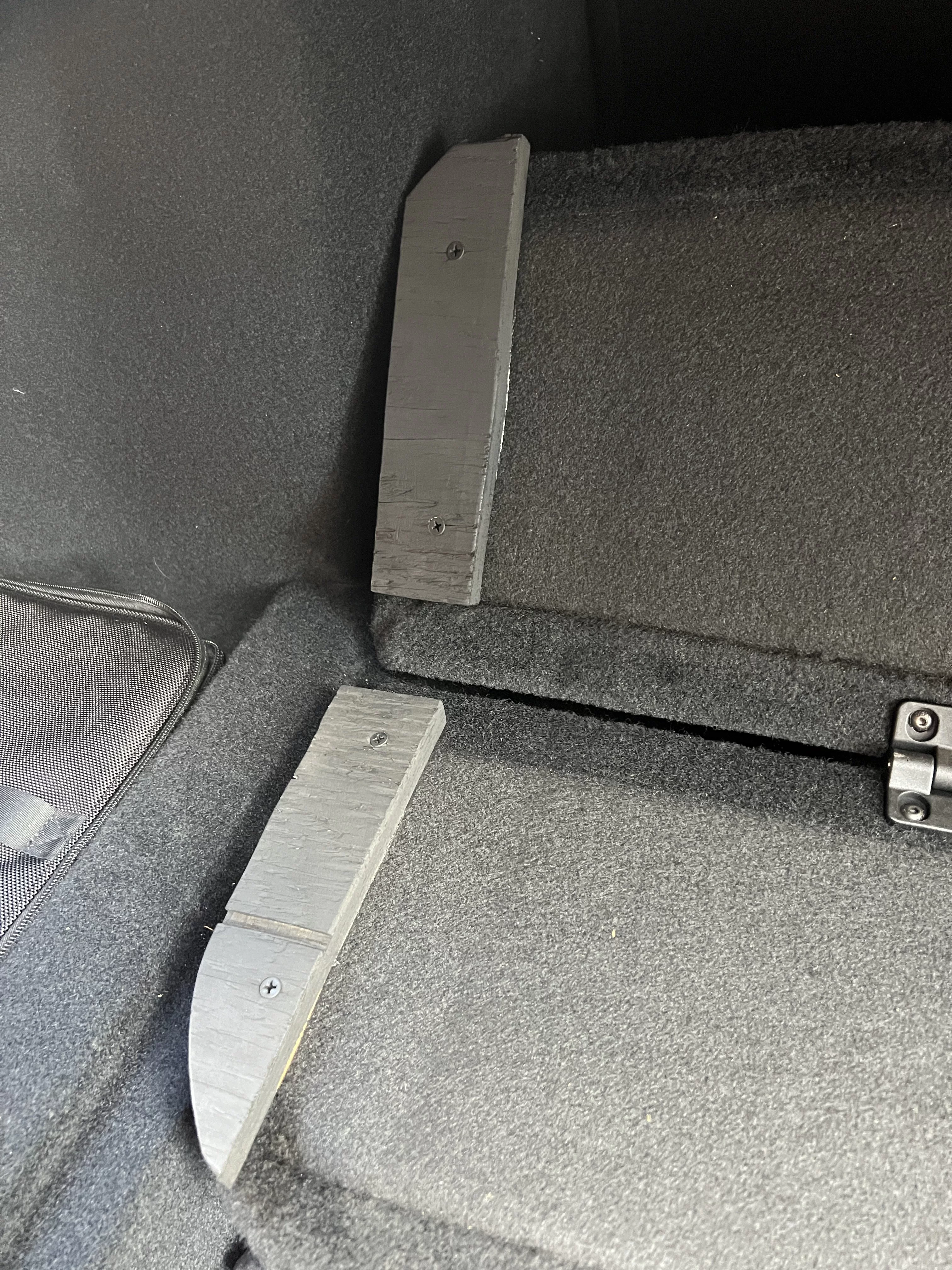

Next I turned my attention to the trunk partition cover as is was now touching the JBL subwoofer below. I cut and installed plywood in the same pattern as the partition cover to clear the subwoofer's elevation and yet not have the partition cover slide around
With the modified partition hovering about the subwoofer, everything looks relatively factory stock
The sound is now truly phenomenal and bass notes, whether one is seated forward or aft, are exactly what you would expect of a car of this price. This was a low cost (<$300) endeavor and took me a day to complete. Hope others will find this of benefit,

Interesting setup. Why not disconnect the rear sub entirely and take the output from each voice coil? You’re running that JBL in parallel this way. I’m curious how this ends up sounding.
Another thing I noticed is that you loose most or all of the rear trunk well. True ?

Can you show the power tap in.
@smistry007 already explained that the power tap is from the 12V cigarette lighter outlet (also see its picture above).
I guess you want continuous tap then if you lift that 12V outlet panel up (tray), you can see the 12V battery underneath.

This looks very interesting. So now you’re running two subwoofers. Have you tried just using your new JBL and not the original?
Do we know the size and power of the original subwoofer? Do you think the issue is the size of Lucid’s subwoofer or it’s power or possibly the cabinet it’s built into?
The native subwoofer has a tweeter/ midrange in the middle of the woofer baffle. I didn’t want to cut any wires nor did I want to disconnect the native speaker arrangement for fear of ruining the Dolby atmos spatial imaging.
You loose about have of the lowers trunk space- perhaps less if you buy a smaller subwoofer
