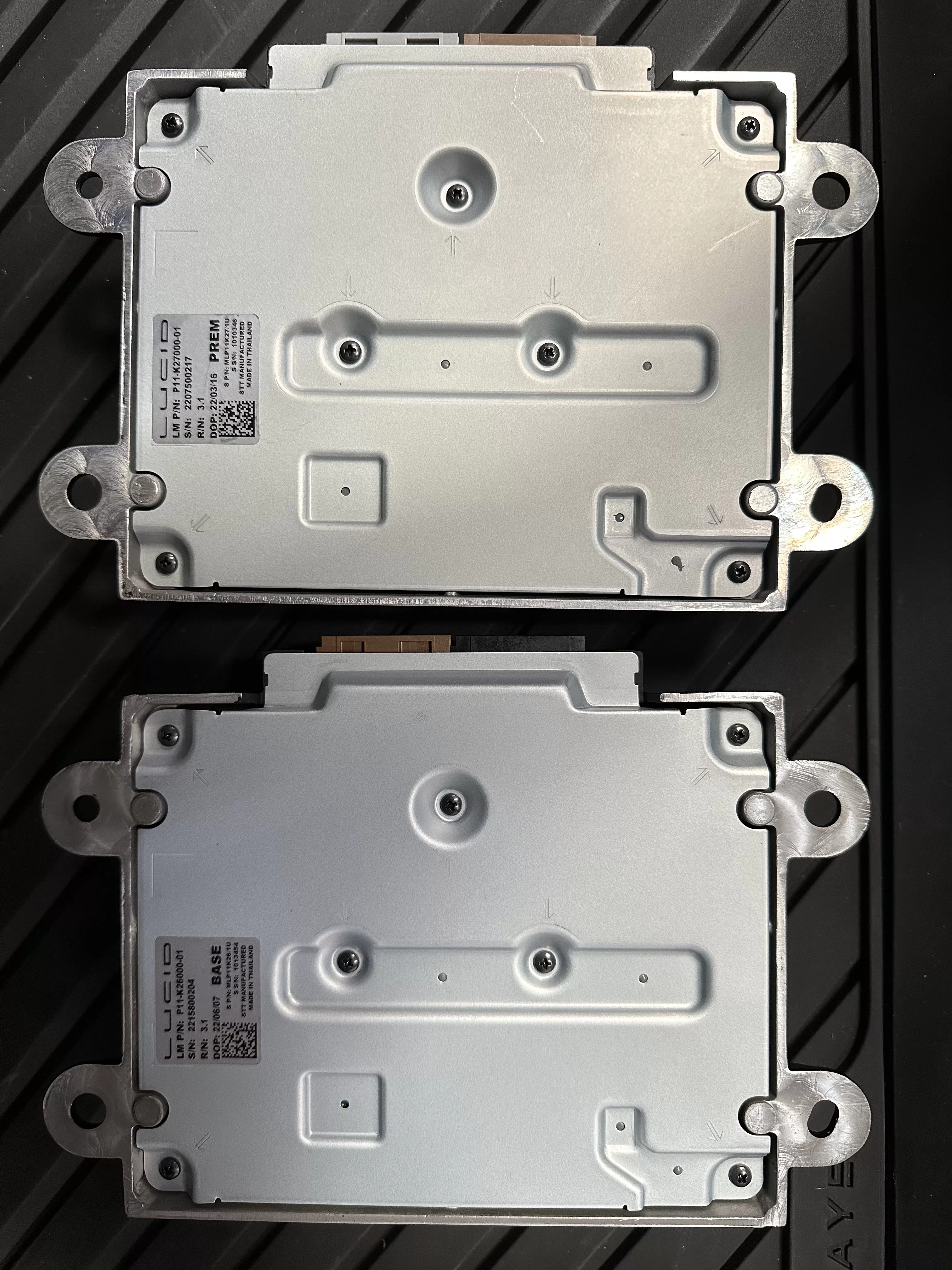

  • Dual DSP Ampliiers (SSP)
    • The Base Audio system basically has a single Class D DSP/Amplifier. The channels are actively managed so no passive crossovers in the car. The SSP audio system adds an additional DSP Amplifier to cover the Atmos channels primarily. Note the label for "BASE" and "PREMIUM" on the amps.
    • View attachment 9417

I will post more on the build later. Basically the approach was to take the amped signal from the factory dsp and run it into an aftermarket dsp/amp. I did upgrade the 8 driver and amp. It's definitely better but potential will be limited by physics. I decided not to do a more extensive bass mod because of the space it would take in the trunk.

For this next part, i will review things to know about the power amps. As stated before, the factory system consists of 2 Class D DSP Power Amps. One for the base system and one for the premium system. The factory system is fully active crossovers for each channel at least for the premium system. For the Base system, it's unclear if they will simplify the setup with some passive crossovers to save discrete channels. I suspect to the "Detuned" systems that have all the hardware but will be software limited, they will basically program it to kill the atmos functionality and the height channels but use the same power amplification. Not sure how thoughtful they will be about the tune from there. You will see below the factory amps alongside the aftermarket amps. For this build we used the Mosconi Pico series. Each amplified channel is mapped to an input side on the mosconi pico, and from there can be signal corrected before being re-amped to the drivers.
To allow mounting of the aftermarket amps in the same positions as the factory amps (so as to use the factory cables back to the drivers, a mounting plate was created to "shift" the factory amps over to the side. The offset levels were required to clear the other rear surround drivers.
You will see the final mounting positions of the factory and aftermarket amps here inside the trunk. This setup is clean, consumed no extra trunk space and fit within the existing trunk trim. Elegant!
