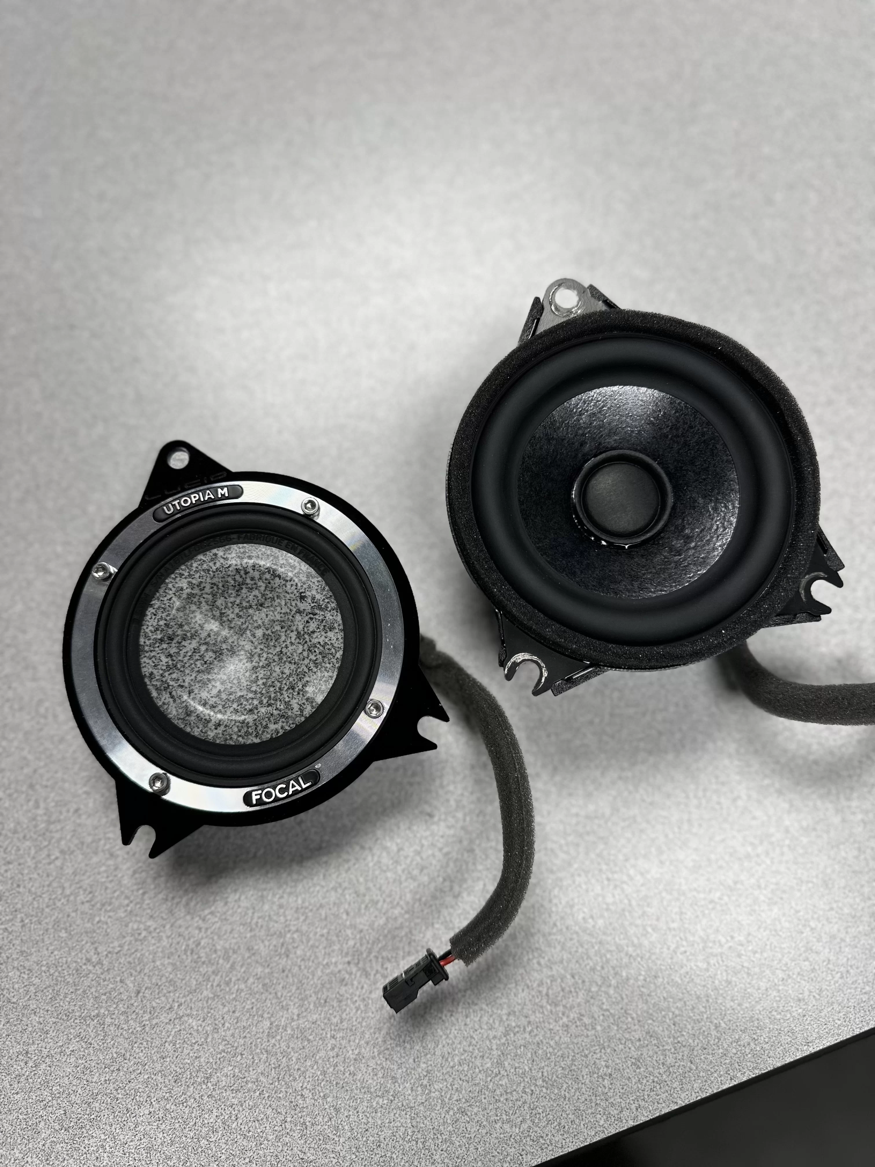

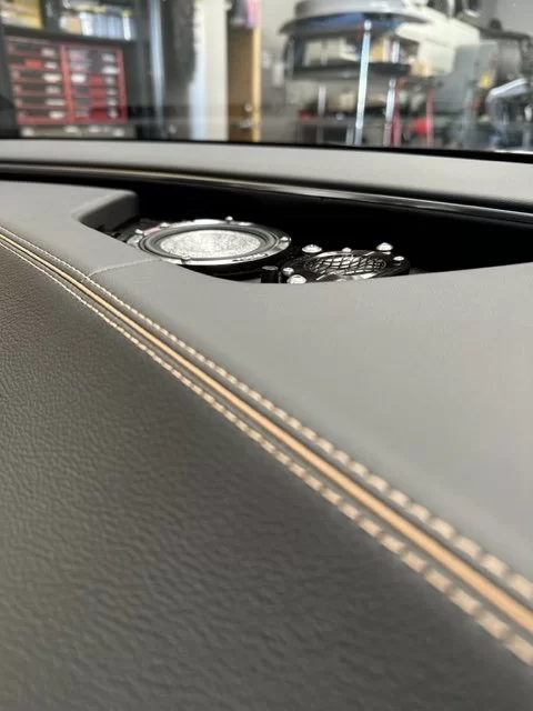

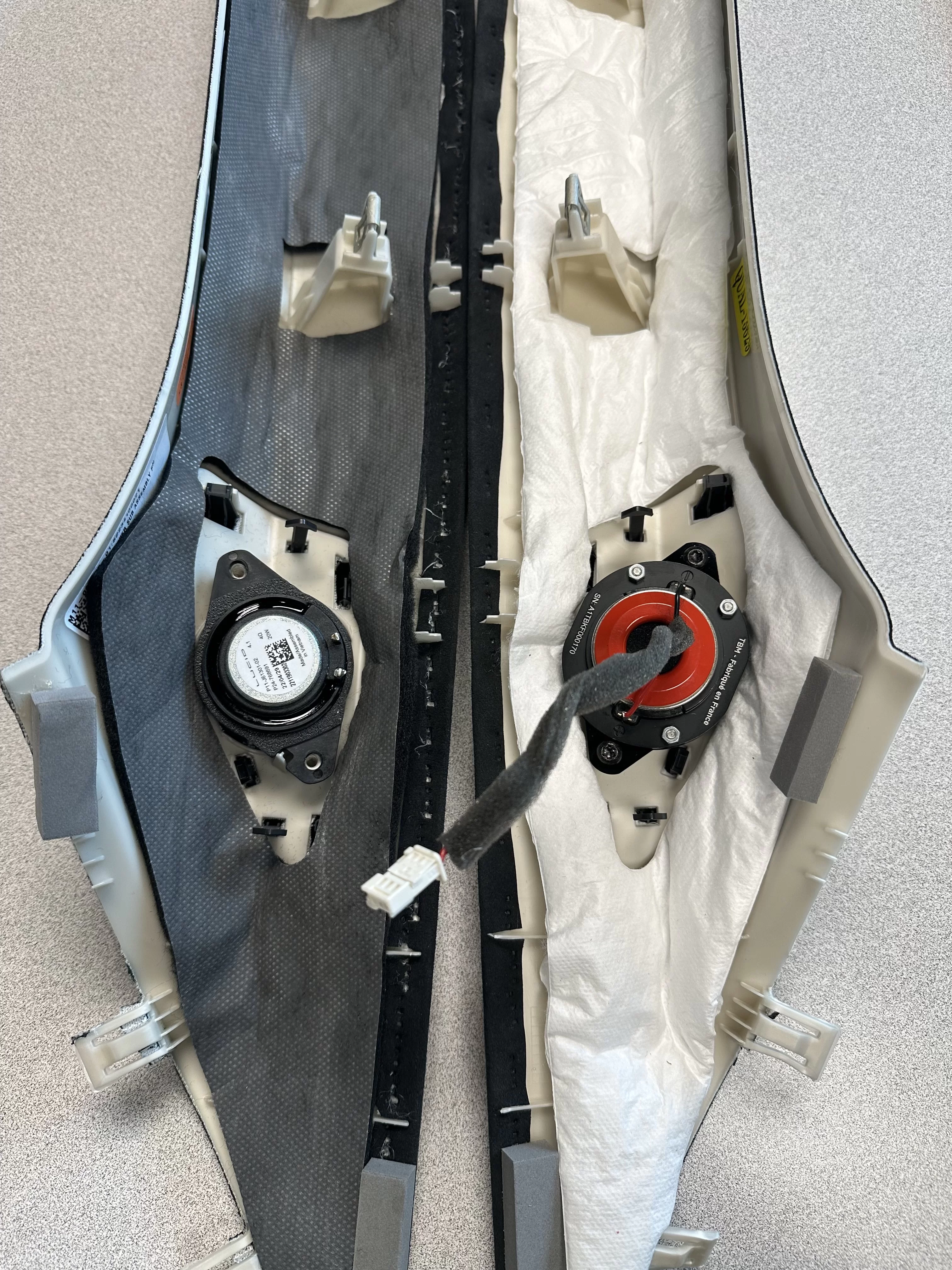

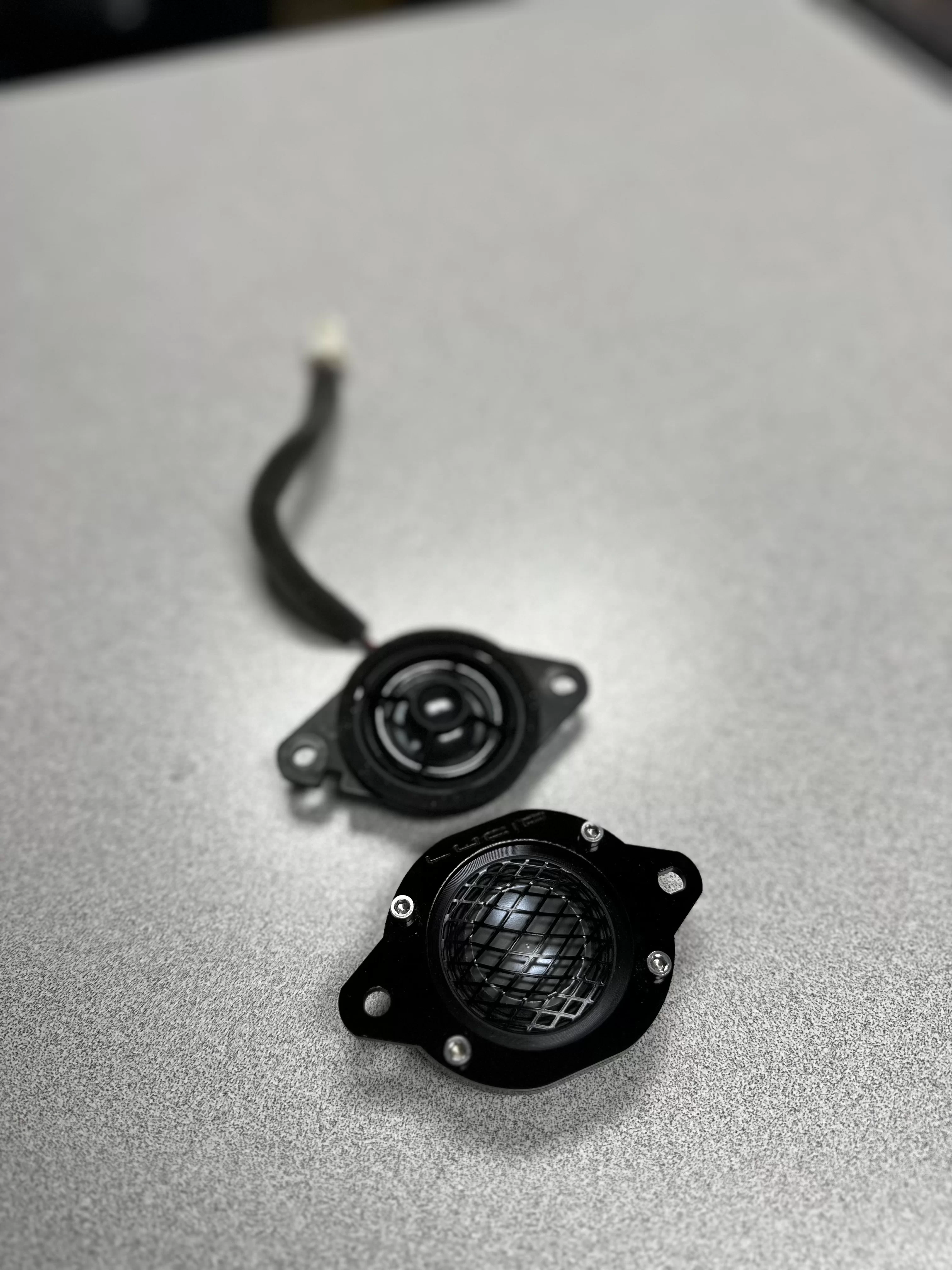

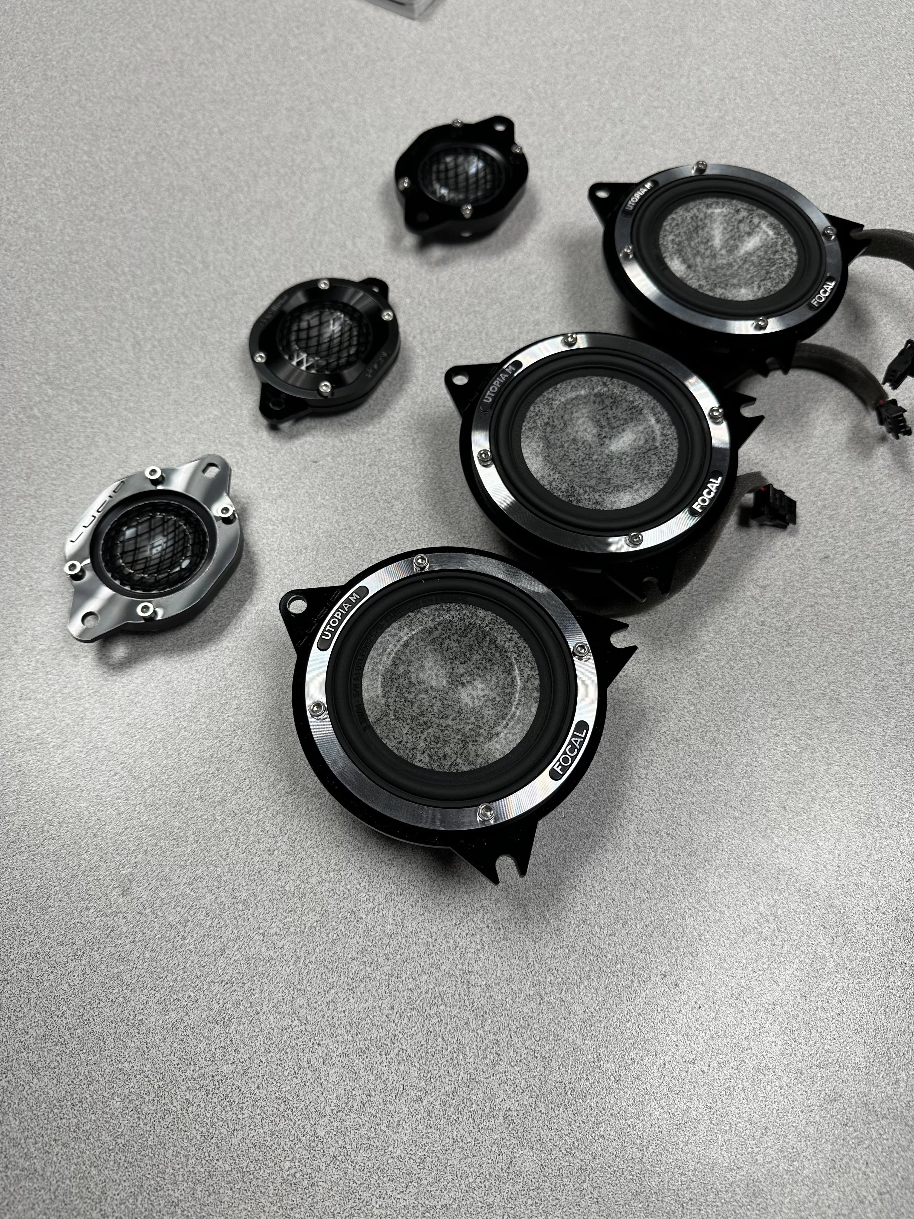

For my build, I used top of the line Focal Utopia TBM tweeters (1") and Utopia Mids 3.5". Here they are side by side with the stock tweeters and mids.
"View attachment 9531
Here's the full set - 3 sets because the center channels needs to match. If you don't have atmos, probably save yourself the cost on the center channel.View attachment 9533
Note that the custom laser cut adapters have already been mounted to the aftermarket drivers to fit into the lucid factory holes.

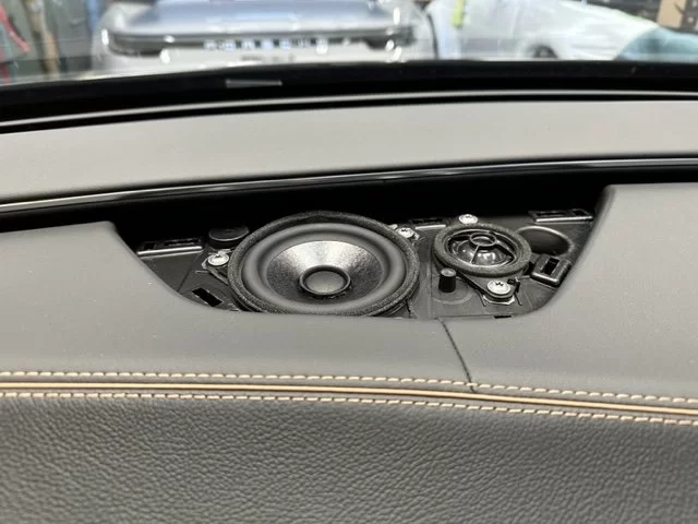

Below is how the A pillar that houses the tweeters look.
Here's one of the front mid's and center channel set.

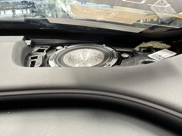

I did not address the factory mid-bass that's in the front footwell.

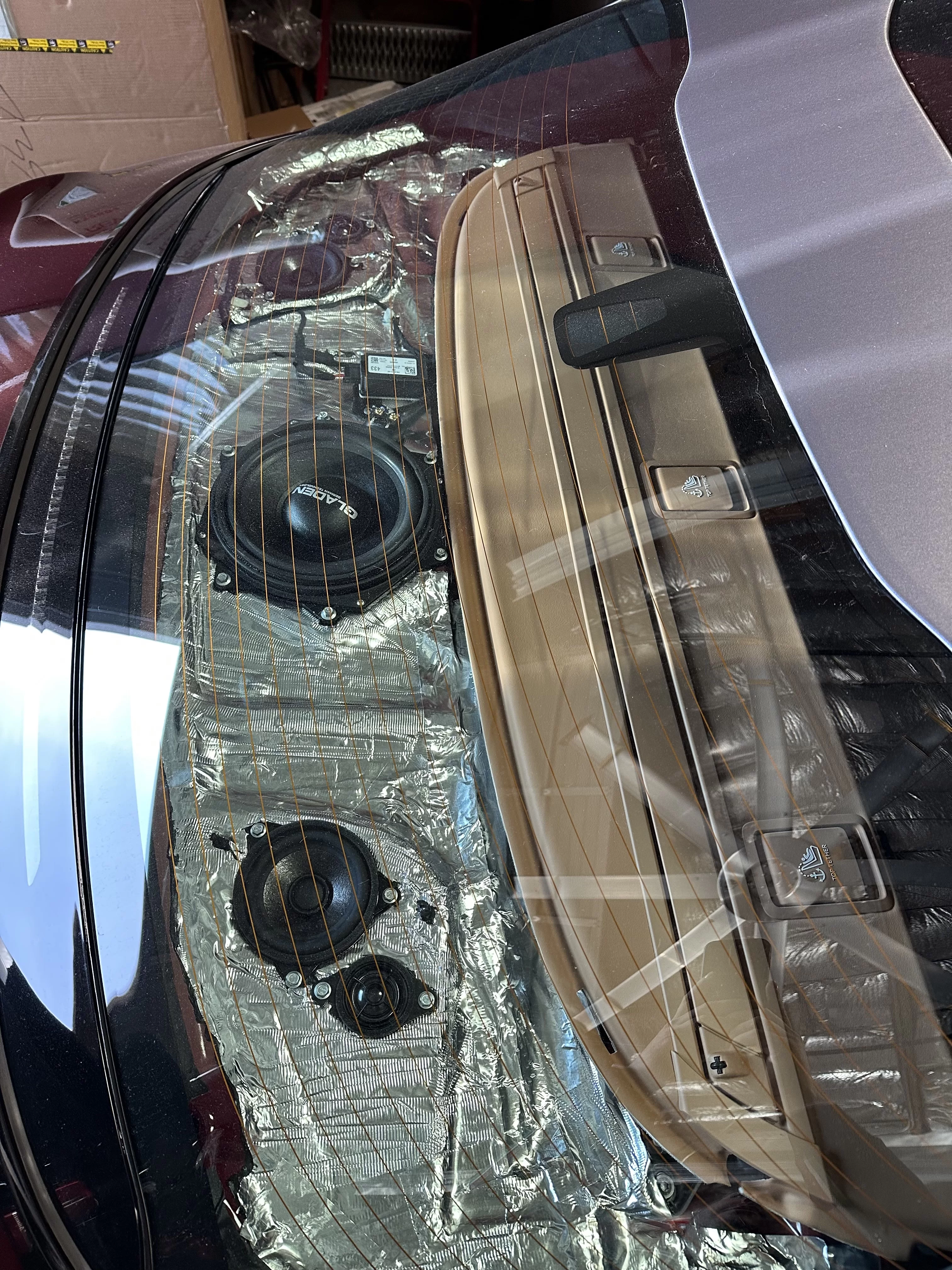

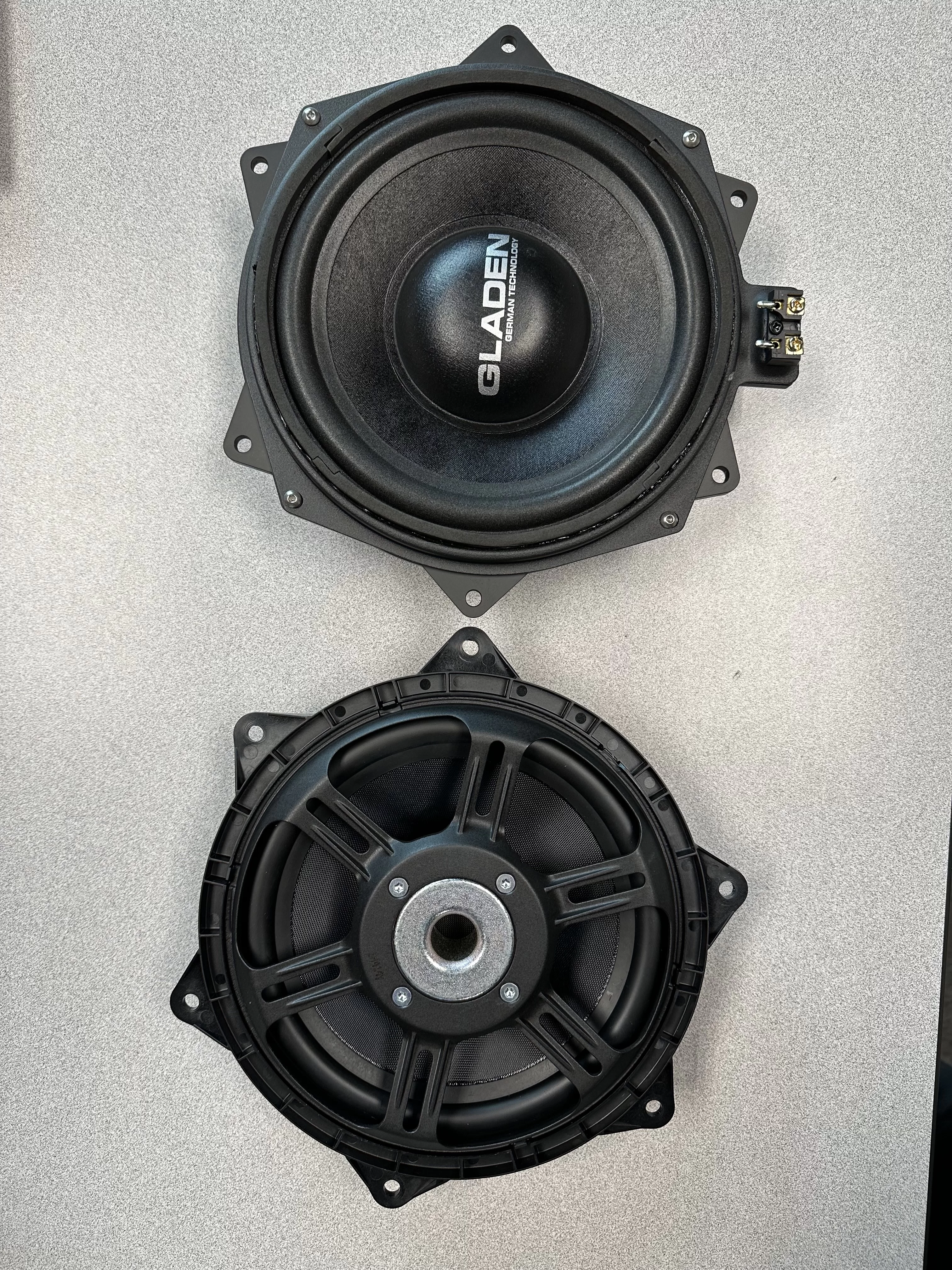

For the Sub, we chose an 8" Gladen One 202 BMW speaker (it's really a woofer that can accept a lot more power). This Sub is sold as an aftermarket upgrade for BMW's by Gladen Mosconi. See below to compare it against the stock Sub. Note the custom adapter that's been mounted to it.
Finally, because we are going to run 200 watts into a Midbass playing as a sub we sound treated the rear deck.

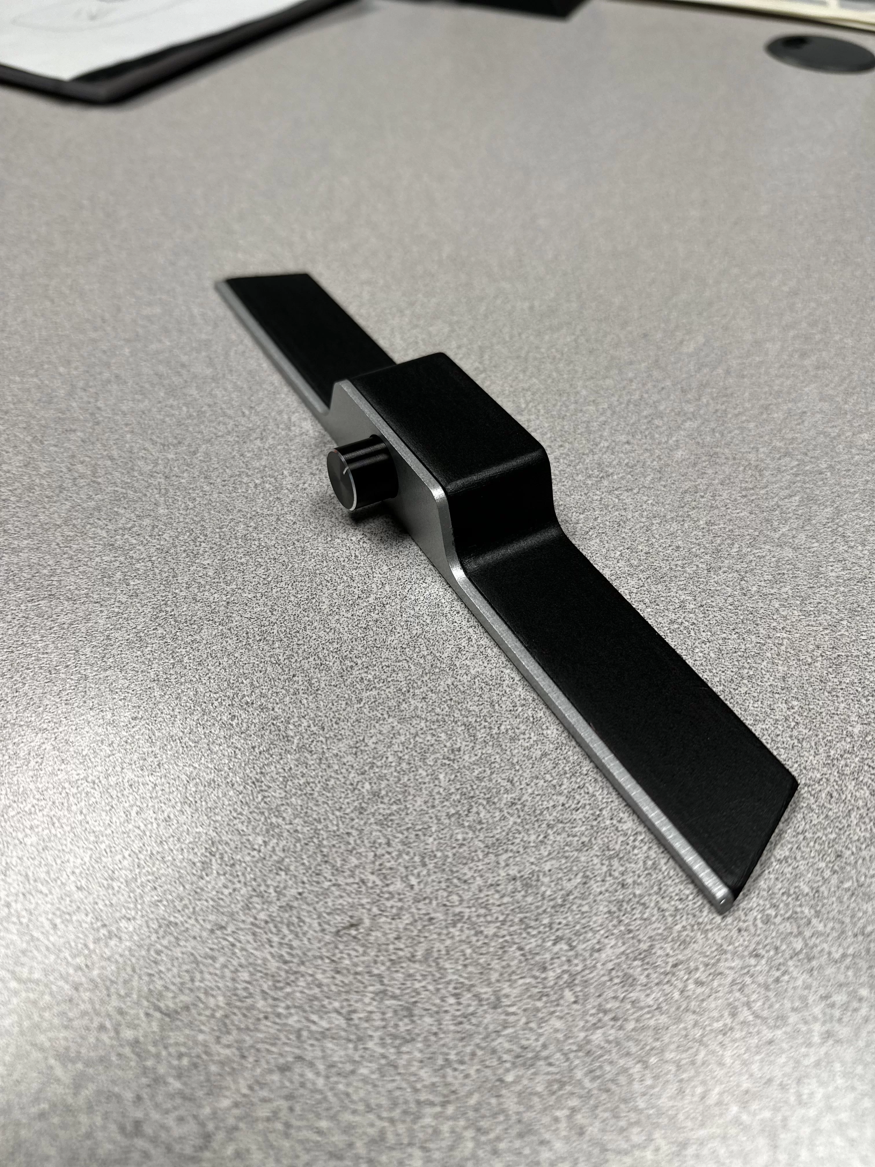

A nice touch for additional bass control was a custom mount for the bass control switch. This was mounted behind the pilot panel. Looks like it was part of the original design!

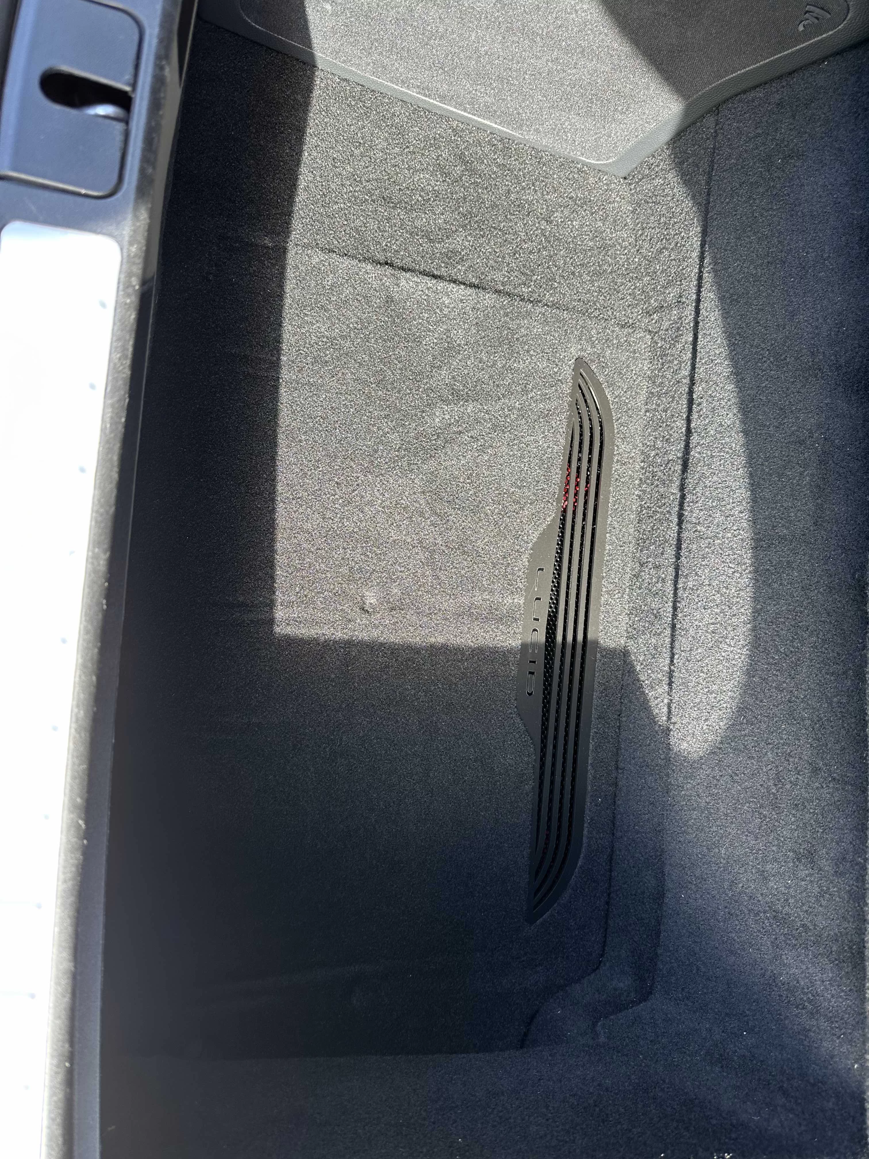

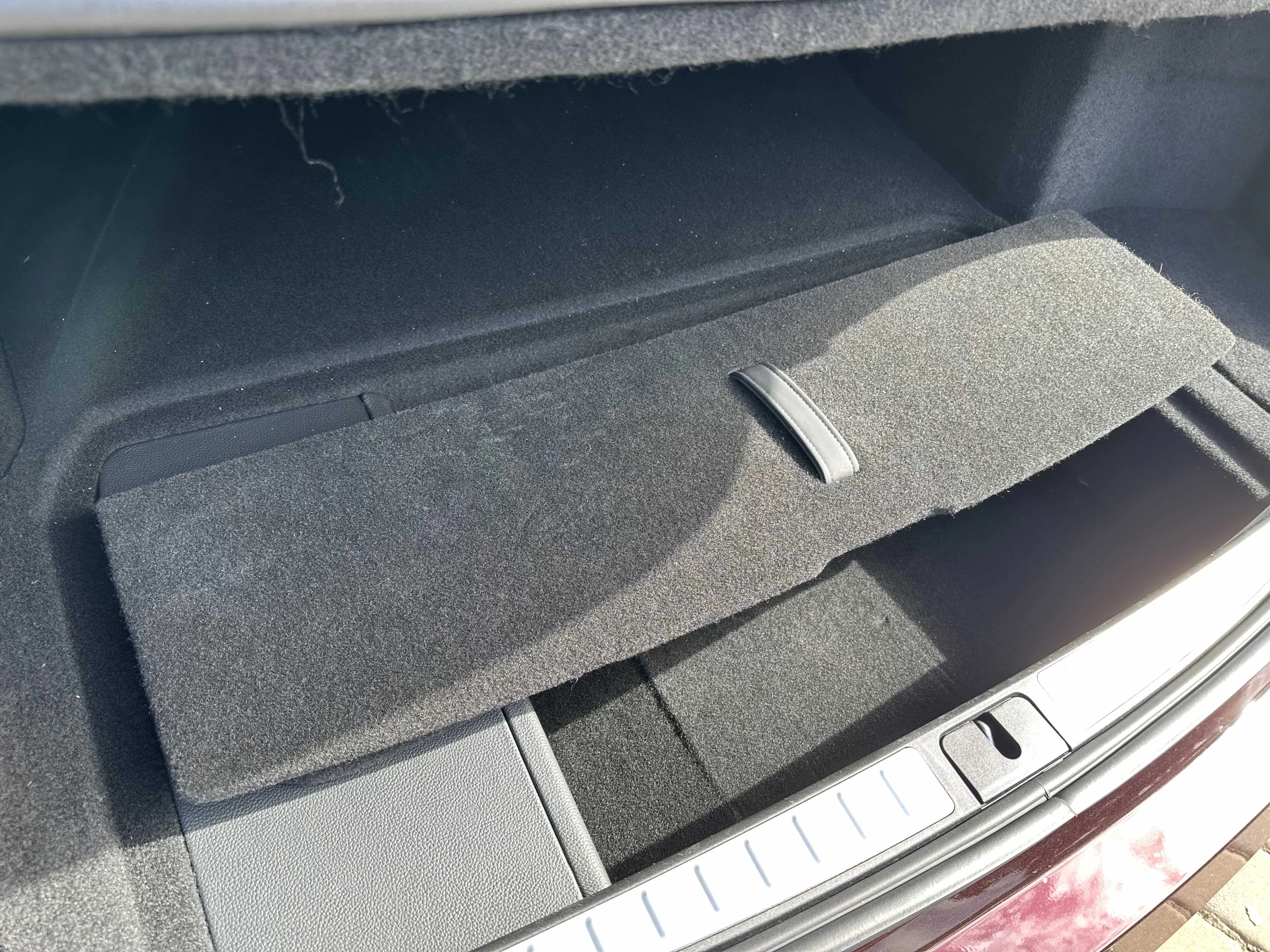

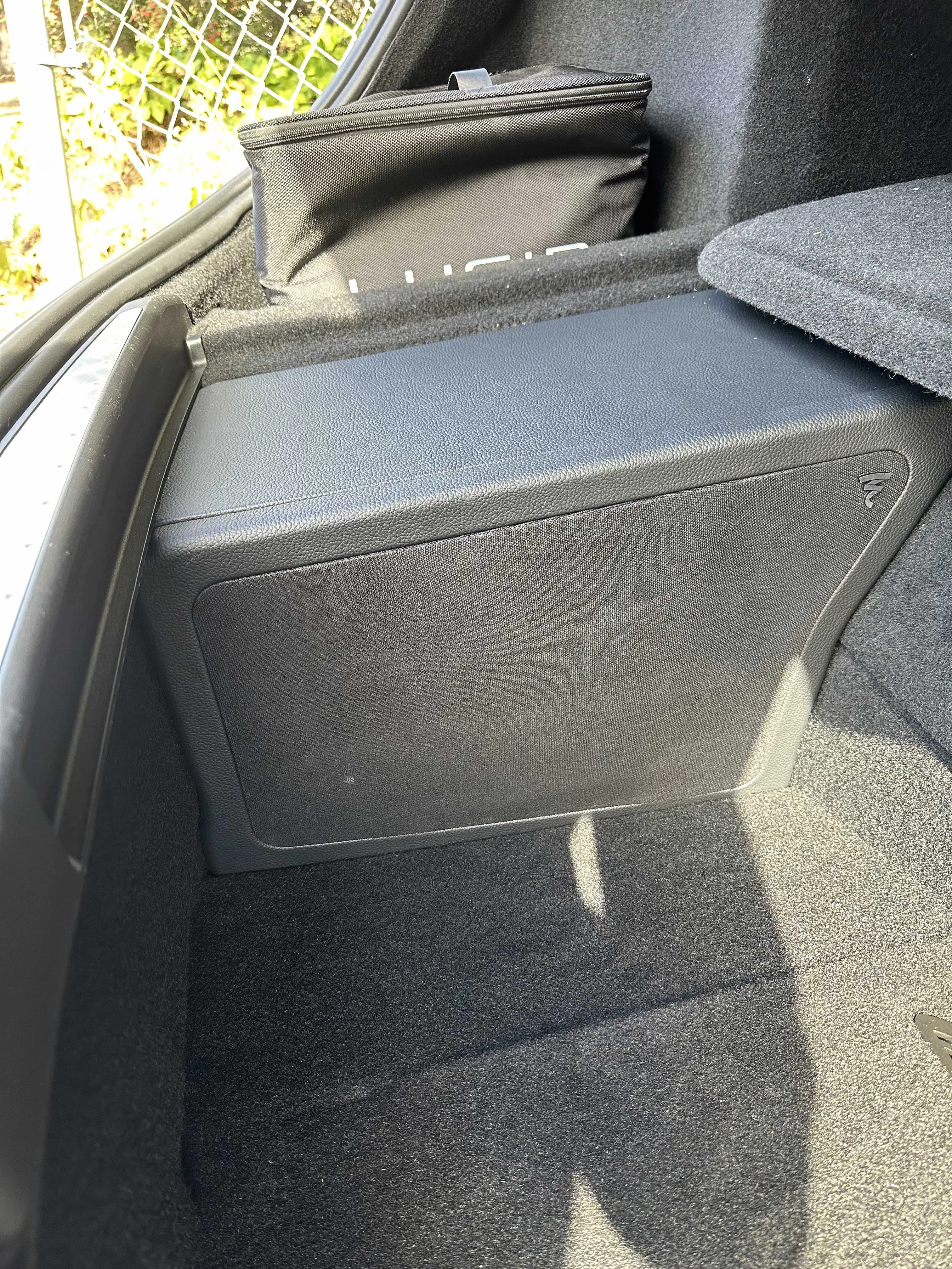

Step 1.) Custom subwoofer enclosure built into the left corner subtrunk well. It's a sealed enclosure for a Focal Utopia 10WM Subwoofer. It extends under the bumper beam to where the charger cable sits to save subtrunk space. As you can see the charging cable sits on top of it now (though i don't really carry it with me anyways normally)
to properly experience the bass, i generally open the pass through between the rear seats down, but an additional modification was made to the trunk liner to allow soundwaves to pass through the liner through where the factory "sub" driver was located. Without this modification, the factory trunk liner does not allow acoustic pass through. This fills the cabin with bass instead of having it narrowly projected through the rear seat pass though. part of the trunk liner was cut and matching carpet was placed over it (it's hard to tell it's different)

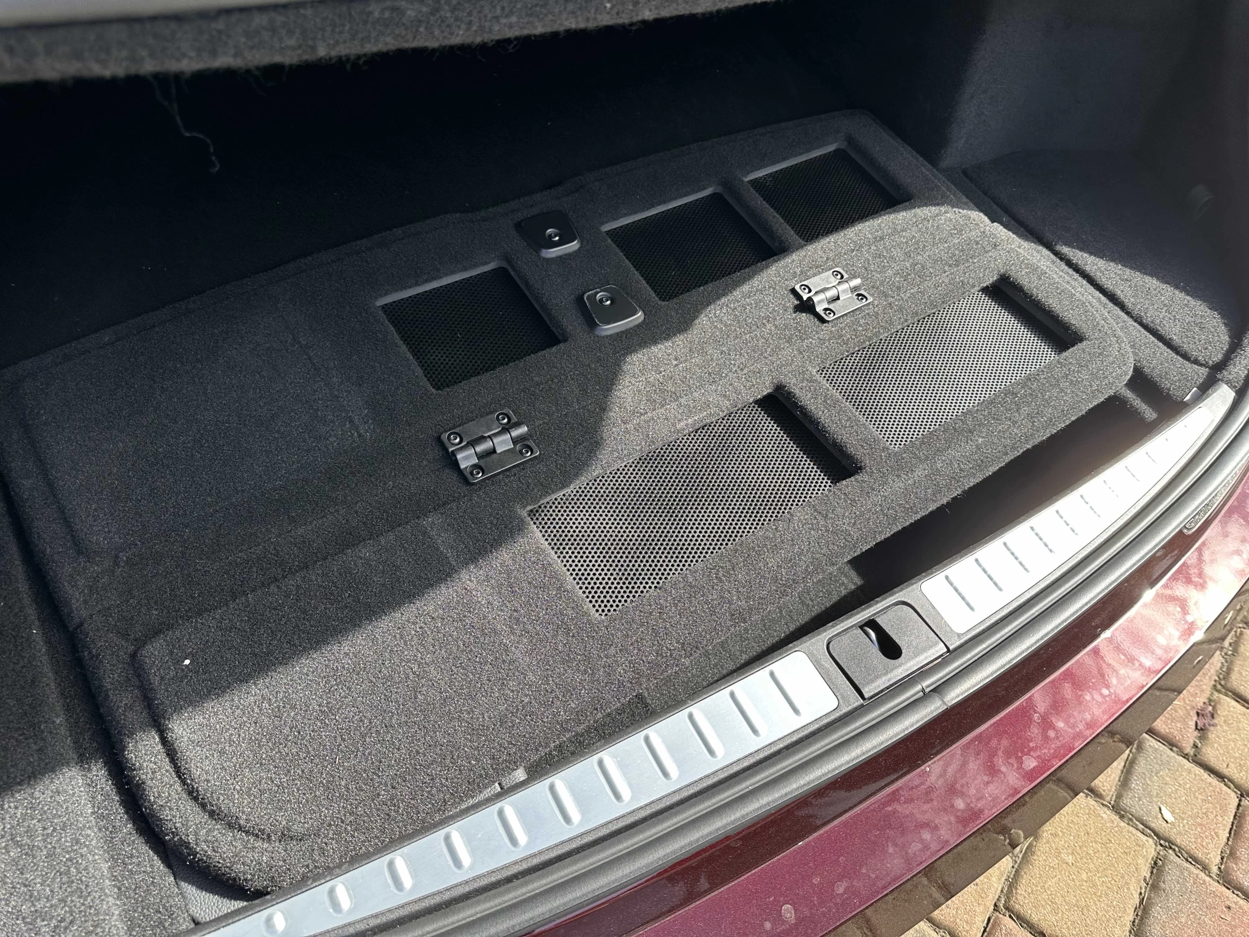

A custom sub trunk cover was made to allow the bass pass through. You will see how it is constructed in the photo below including the matching carpet. When placed in on top of the sub trunk, it looks exactly like the stock one, but allows pass through of the bass.

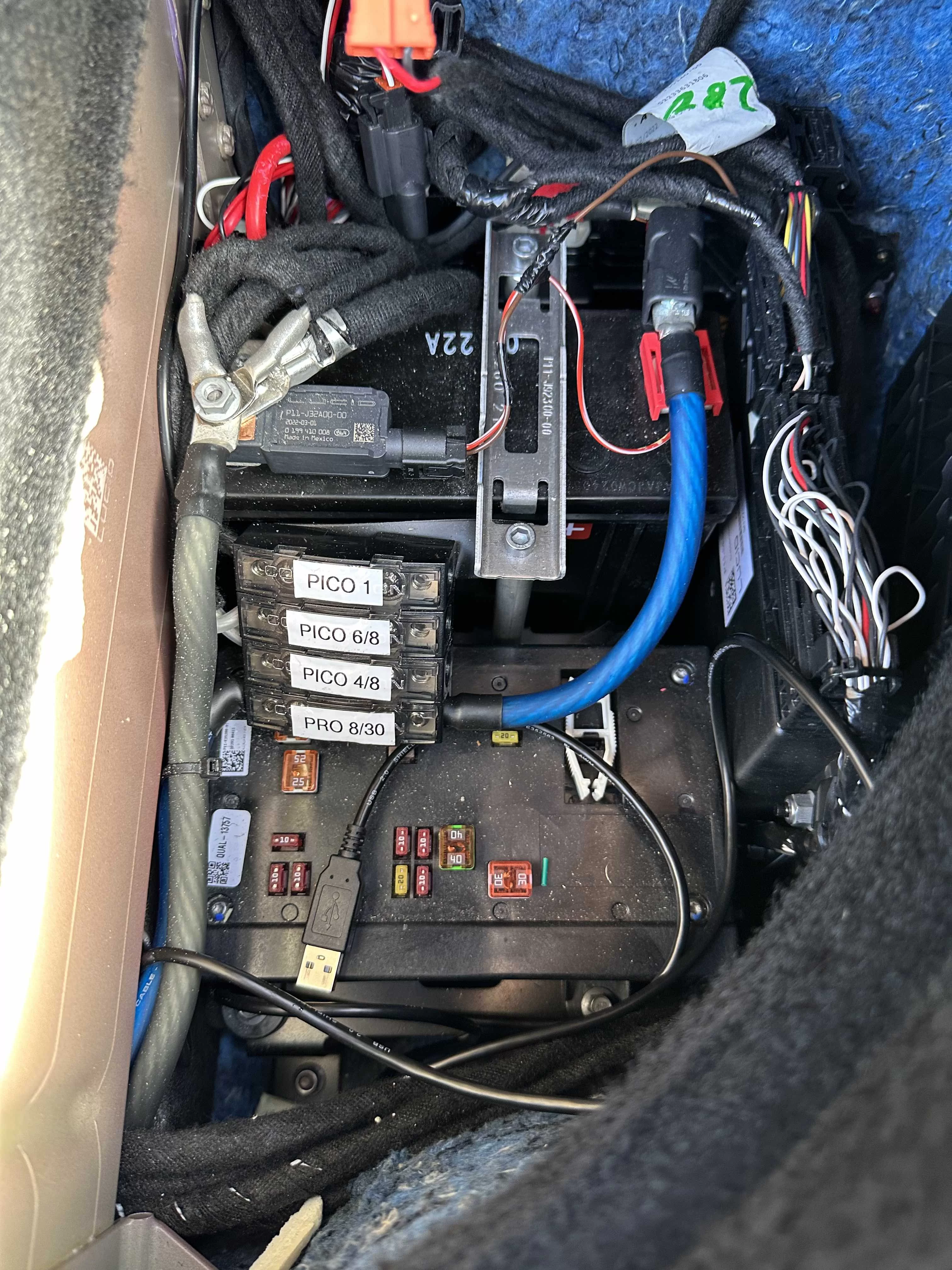

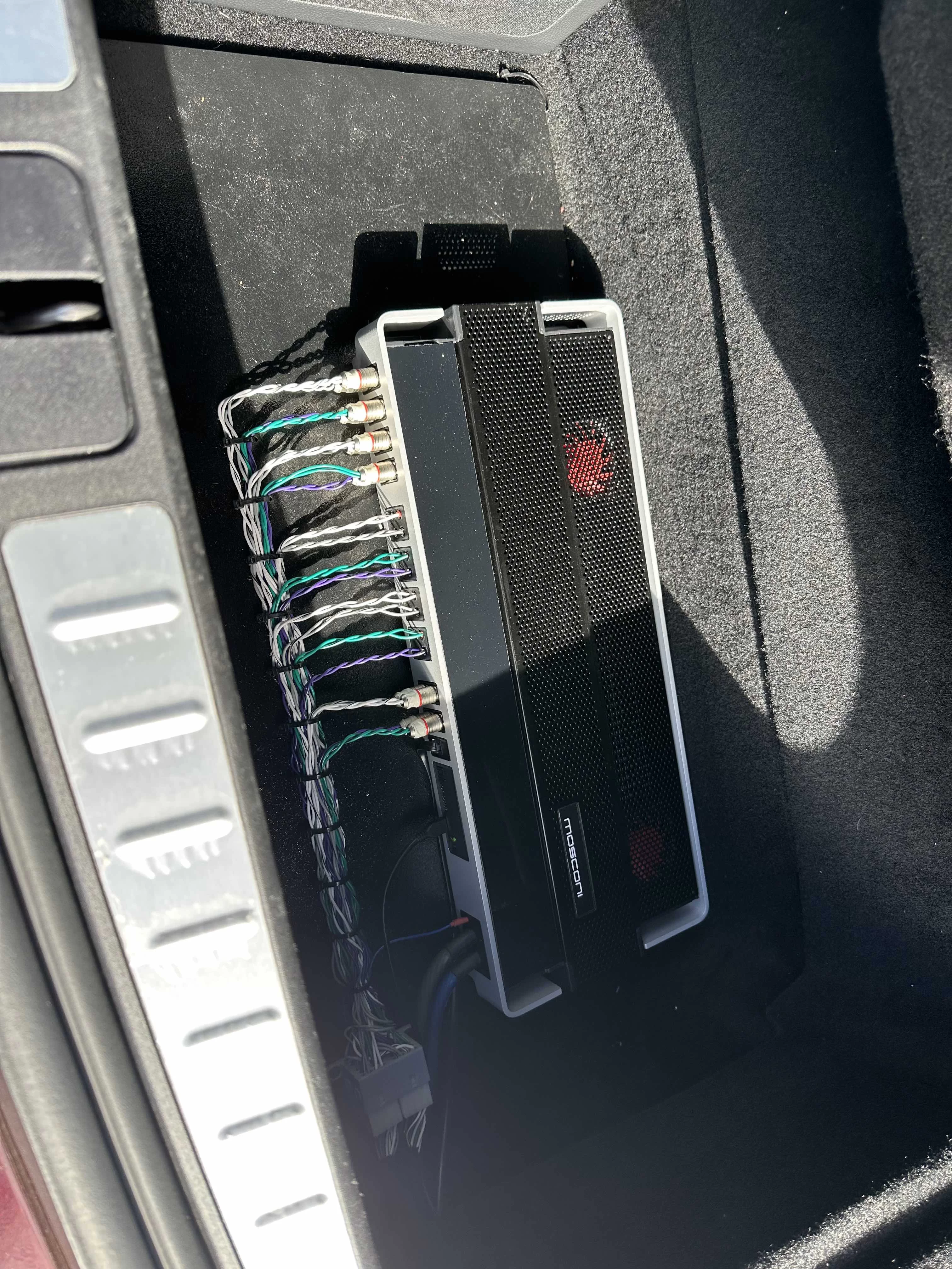

Lastly, I decided that the original Class D amps powering my front stage left something to be desired. So they were replaced with a monster 8 channel Class AB amplifier with built in DSP. Unfortunately, the AB amp is not compact like the Class D amps and could not be mounted next to the factory amps. (not that there was space for another class D amp anyways) So it had to be mounted in the sub trunk. See the amp rack below as well as the custom trim cover for the sub trunk.
You might ask, how did the power work out for so many aftermarket amps including a less efficient 8 channel AB amp?
Actually quite well. We did not need to install any extra batteries and the voltage was stable coming off the rear battery alone. That suggests the DC to DC converter provides a steady buffer for the little battery in the back. As you can see by the fusing it's now running 4 after market amplifiers.

  • Excellent speaker placement for a car. The location of the of individual speaker components were extremely thoughtful to minimize standing waves, reflections, reverberations etc (in laymans terms it means that the speakers are not fighting each other when playing music). It was clear the audio system was part of the system design and not just an afterthought of (where do i jam these things into the car?)
    • Particuliarly, as others have noted, the front stage mid-bass drivers are in the footwell panels (it's actually around the level of the dashboard, which makes it expensive to modify since the dash would need to be disassembled to access the mid-bass drivers) This positioning is ideal for imaging since it's wide and deep and not in the door panels which would narrow the stage and doors are notorious for footwell standing wave issues and imaging problems.

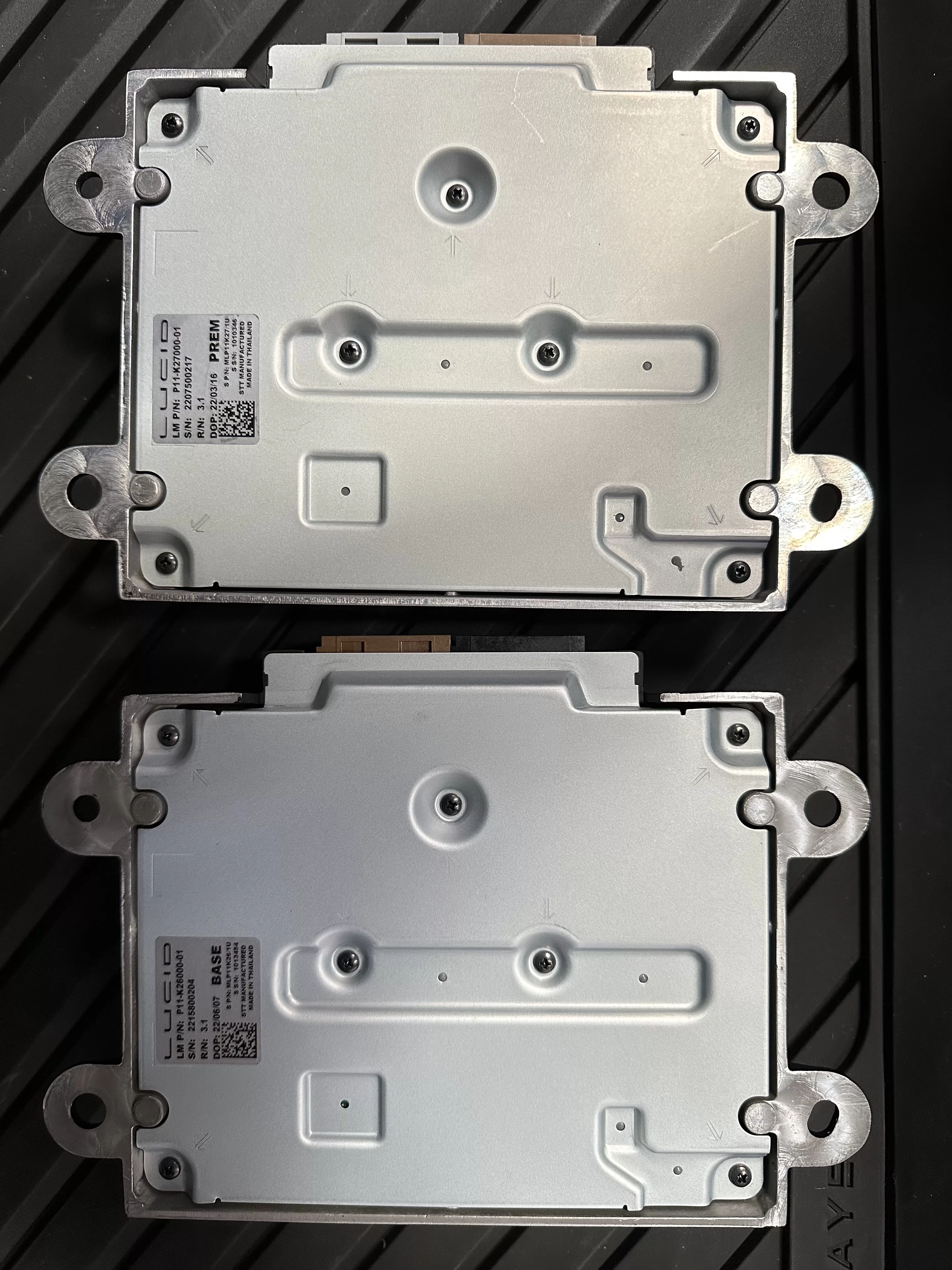

  • Dual DSP Ampliiers (SSP)
    • The Base Audio system basically has a single Class D DSP/Amplifier. The channels are actively managed so no passive crossovers in the car. The SSP audio system adds an additional DSP Amplifier to cover the Atmos channels primarily. Note the label for "BASE" and "PREMIUM" on the amps.
    • View attachment 9417

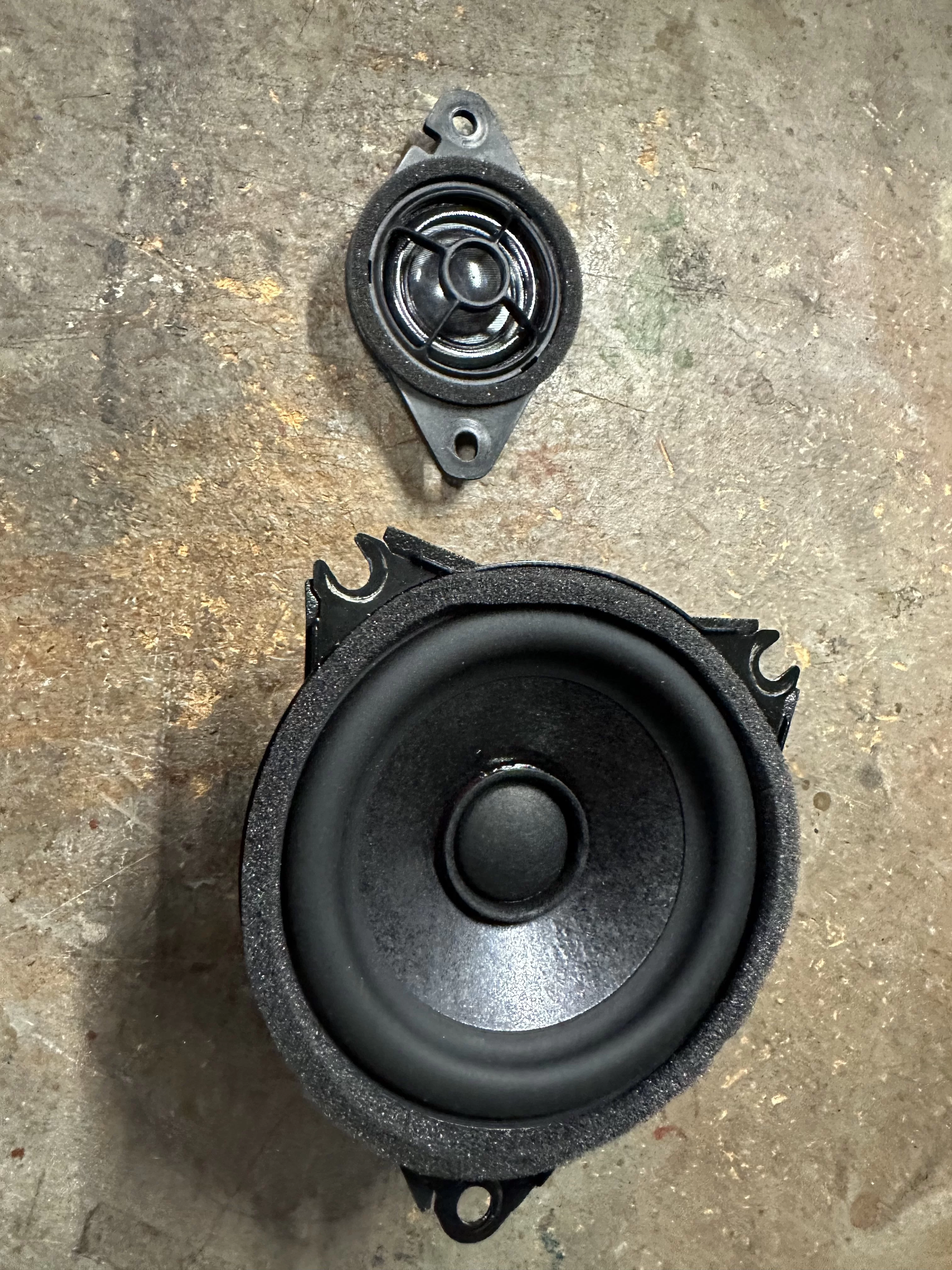

  • Quality "OEM" Drivers.
    • The drivers are quality on par with OEM upgraded European sound systems. E.g. B&O or Burmeister for Mercedes. Pressed metal chassis and ferrite magnets. (The Sub / Midbass have plastic chassis). The cones are paper / poly. If you were to buy then off the shelf they are equivalent to $50 drivers in terms of quality. All serious aftermarket drivers with neodymium magnets, textile/metal driver cones, metal chassis will perform on another level.

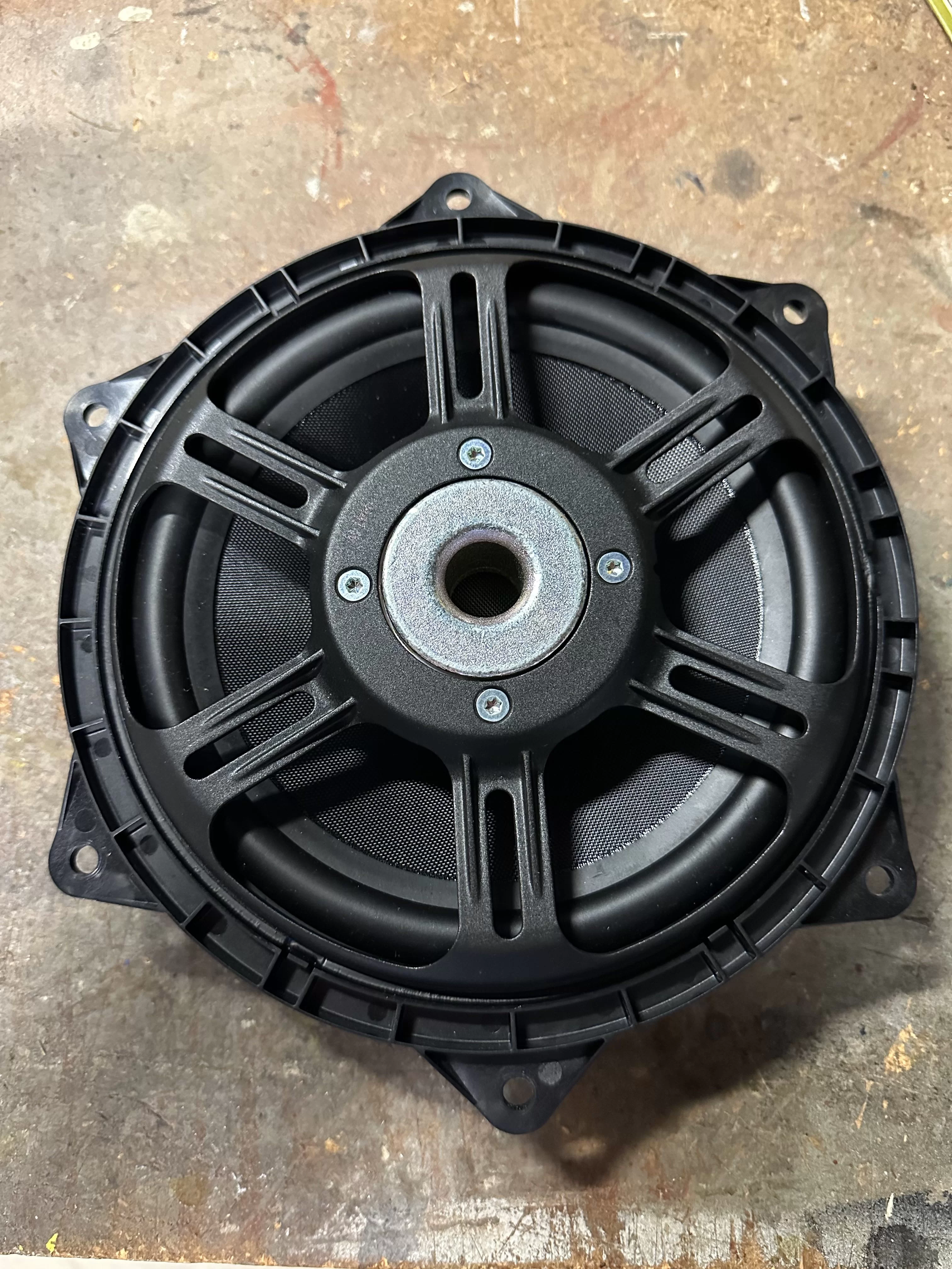

    • The "Subwoofer" in the back is basically an 8 in midbass driver with dual voice coils. Apparently it was crossed over quite high, running as high as 250hz down to 30 hz. This tune caused some phase issues with the front midbass drivers since they overlapped in frequency much more than typical for a subwoofer.
