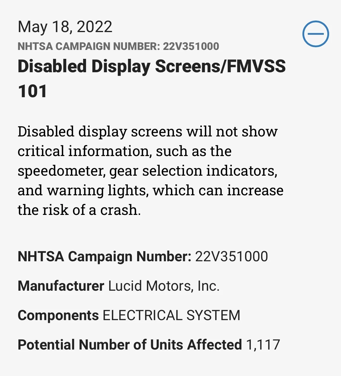

No, and you can't sell a car with an open recall either.
1,117 vehicles potentially affected. I guess we got our production number to date.
Although I wonder if this is just delivered cars or if they have to include undelivered cars.
I would say this is registered cars on the street, not in factory.
1117 - 131 (Oct~Dec) - 360 (Jan~Mar) - 300 (Apr) = 326 (so far in May)
Sounds about right….
And 180+ in AMP parking lot on hold
Just received this email
The attached notification letter is being shared in accordance with the National Traffic and Motor Vehicle Safety Act. We’ve determined that a defect relating to safety exists in certain 2022 Lucid Air vehicles.
Specifically, Lucid has determined that on certain 2022 Lucid Air models, the ethernet wiring harness for the Glass Cockpit instrument panel may not have been secured properly. The harness can become damaged by rubbing against another part of the vehicle, and disable the display screens. Disabled display screens will not show critical information, such as speed, gear selection indicators, warning lights, and other in-vehicle notifications, which can increase the risk of a crash.
Please reach out to a Lucid Service Center or contact Lucid Customer Care at 888-99-LUCID or [email protected] to schedule time to have your Lucid Air inspected as soon as possible. We apologize for this inconvenience and assure you that any inspection and remedy (if necessary) will be performed at NO CHARGE to you. Please contact a Lucid Service Center or Lucid Customer Care to schedule an appointment to have the vehicle inspected as soon as possible.
