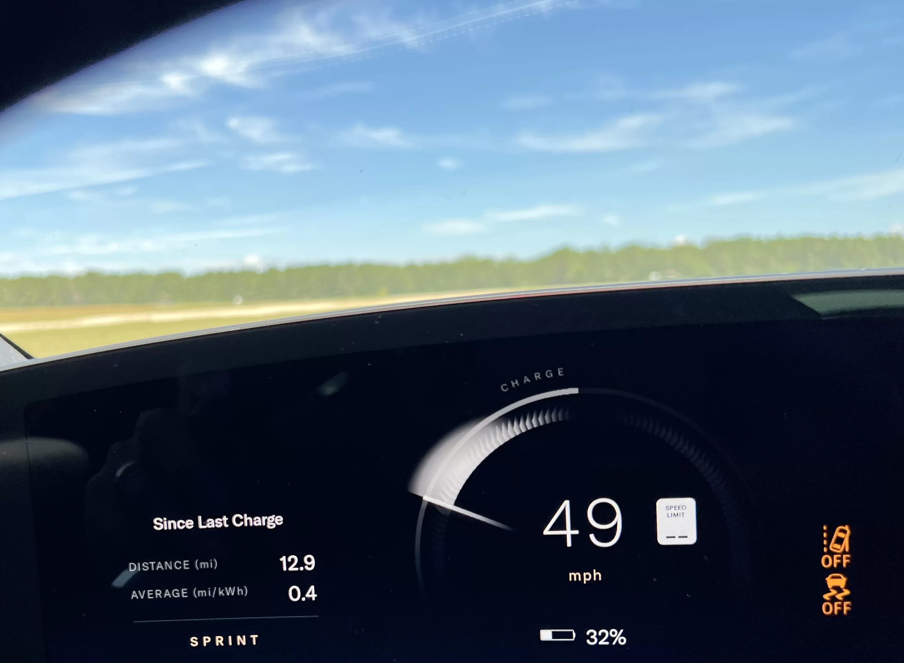

Hey B I feel your pain. My lucid air grand touring is experiencing the same drastic reduction in range. From the numbers you supplied, you’re using 167% of range per mile driven. My Lucid is also losing range at the same rate. I have been driving electric cars since 2014 and find this is not reasonably explained by any of the factors mentioned by those below. I’ve been driving my car on smooth 100% of the time On perfectly flat terrain in Naples Florida back in May and June with temperatures in the 70s and 80s. My car has been at the service center in Riviera Beach since June 13 and I have been completely unable to get a reasonable response ,or in some cases any response at all, from anybody at Lucid. The people at customer care are very nice, but have no expertise with which to help you and refuse to give you the name of anybody with any technical knowledge that you can contact directly. In short, my experience with Lucid service really sucks. I’m not sure what my next step is going to be but it will probably unfortunately be legal. This company is not ready for prime time.

Tesla adapter is a must if your going to road trip this car.
