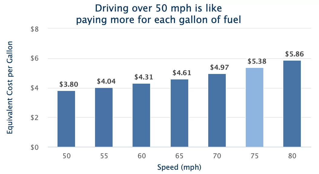

An EV is no different from an ICE car when it comes to the range penalty one pays as speeds climb. Below is a chart for ICE vehicles from the EPA website (www.fueleconomy.gov).
A speed increase from 65mph to 80mph in an ICE vehicle causes, on average, a 27% increase in fuel consumption, causing few ICE vehicles to attain their EPA mileage ratings in real-world driving. And in an EV, you'll be paying a lot less for the extra electricity (especially with home charging) than you would for the extra gas.
My understanding is the ICE vehicles have very high engine and transmission loss at speeds below 50 than EV. When I look at instantaneous mpg reading on my cars at 40mph vs 60 mph, I see a huge improvement at 60. I think EV is not as dramatically different in miles per KWh between 40mph and 60mph because EV is lot more efficient at 40mph than ICE. Does anyone have such info on Lucid Miles per KWh at different speeds to compare the % difference?
