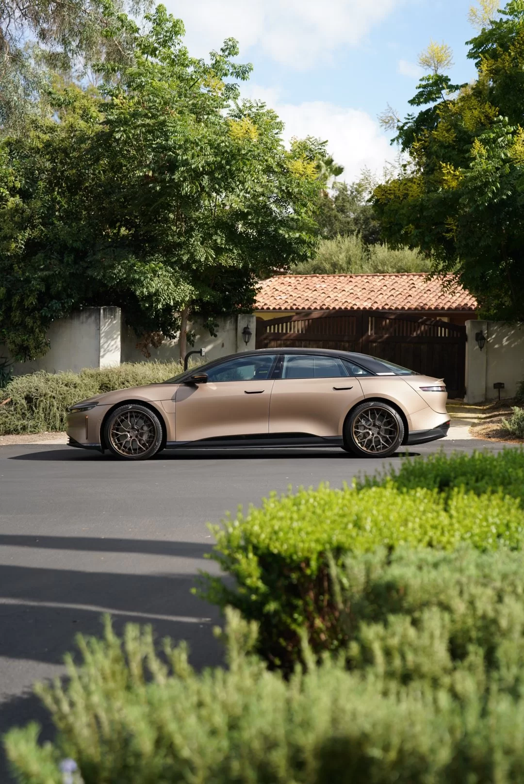

Put these one a few months ago thanks to AG wheels, but held off posting in hopes to find a lowering solution but none so far.

You want to go lowe?!?! I don't think you will be able to drive anywhere that has a bump lol. BTW that looks nice😎
GAHD! That is beautiful!

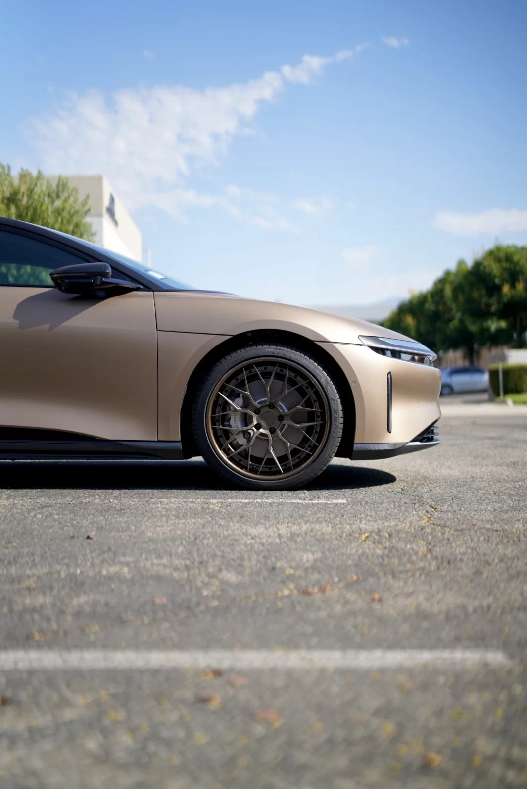

Just like an inch I can’t stand that wheel gap haha. Was hoping to add a front axle lift like Porsche does but KW wanted my car for 3 months to develop it and I’d need at least 5 other cars to make it worth the investment so looking for other avenues. If not will try to get the sapphire springs once those parts can be sourced. Thank you

4B411B0C-FDF5-4AA6-A5D0-53E6D58CC961.jpegYou can see the gap a little better here haha

Looks killer! What kind of range degradation are you seeing, if any?
Honestly not much at all. But that being said I drive it pretty hard every time so I wouldn’t be the best person for range. But I really didn’t notice a drop in range maybe 15-20mi lower for a full charge. The difference imo is negligible, I really was expecting to loose like 30-50mi or at least really notice the drop but I didn’t. I also went wider 21x9.5 front and 21x10.5 rear with 265 front and 275 rear tires.

Looks good!
Just an fyi, I have custom wheels but did not lower it further. Watch the offset as there is less space and travel than you might see on other vehicles. Essentially, wider across: body panel, gasket and inner wheel well. I know this as I have another set coming as the first set rubbed right above the door and fender part line and would pull the gasket out of place.
Discovered this with 5 adults in the car and rolling hills and some speed.

Oh yes it’s def a very tight fit had to swap tires a few times but we specd the size for lowering so we “should be good to lower” haha fingers crossed we’ll see but thanks for the warning
