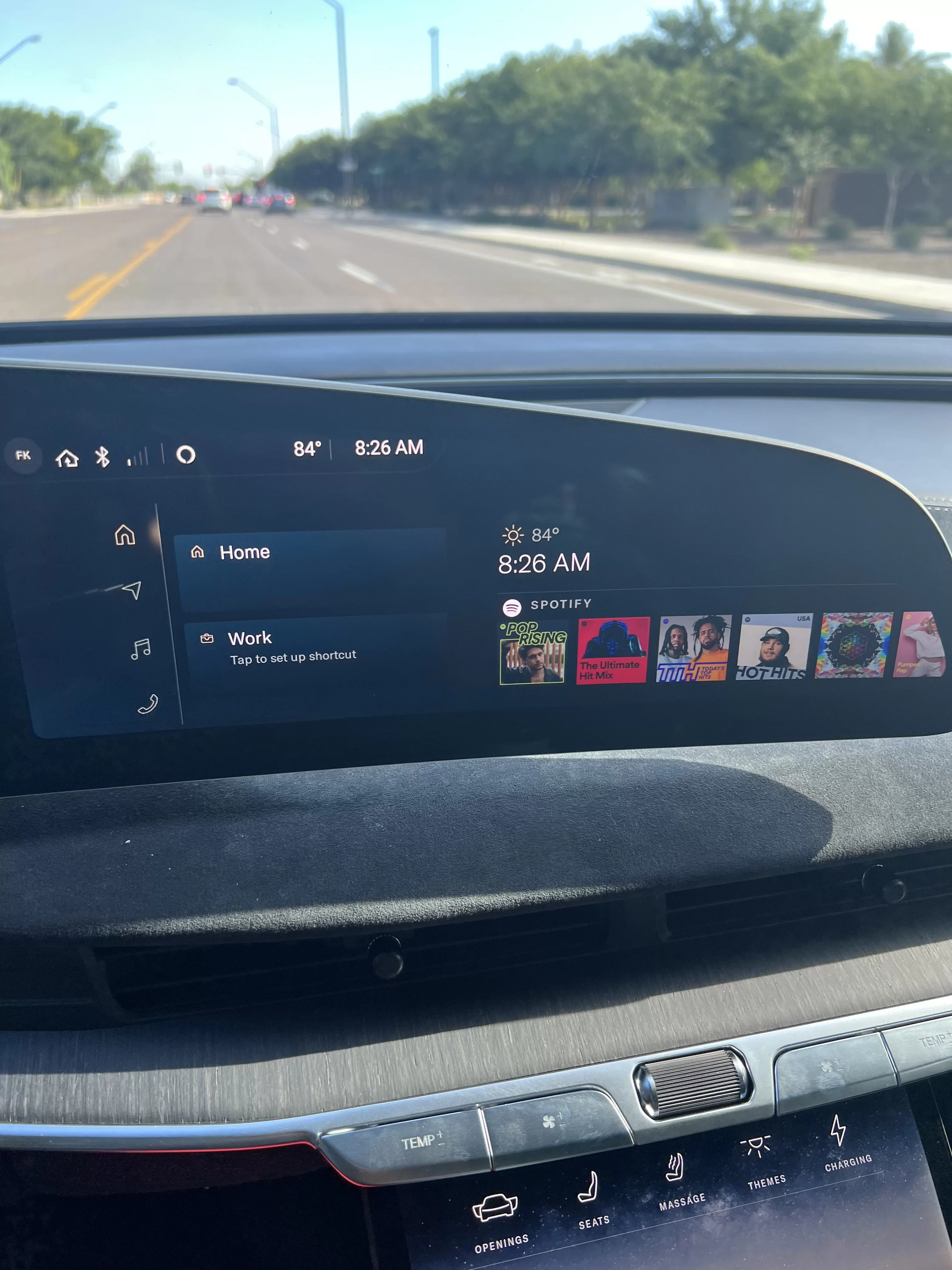

This is what I see happens in morning randomly my car play disappeared off Home Screen and don’t know how to get it back
Is this the same bug or diffent bug?
Randomly car play goes missing in home screen can I report it ??
Do you have two phones connected to the same profile?
This happens to me with my work phone and personal phone. Go back to devices in connectivity and select one of the two phones is what fixes it for me. Maybe you can try the same.
