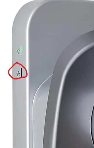

I’m seeing exact same thing on my CP with a new Touring. If I switch the breaker off and on, it works. But, I have to do it every time I want to charge.I have been using ChargePoint charger as well. Occasionally, you will see a RED light on the charger for unknow reason. The only way to get around is turn off the breaker and turning it back on.
You would see the solid RED on right side of the charger as shown below
The issue is with CP. Back when the Air first debuted and people were having issues, they replaced chargers with an updated version which didn't trip the internal breaker. Now they won't do anything about it.I’m seeing exact same thing on my CP with a new Touring. If I switch the breaker off and on, it works. But, I have to do it every time I want to charge.

If you keep turning on and off the breaker, you may cause damage and short circuit. Thats why I went back to using the Lucid cable and a plug in. Stopped using Chargepoint. They have a software issue with Lucid. Chargepoint needs to get together with Lucid engineers and figure out what the problem is. Listening Lucid? Please address this for your cutomers.I have been using ChargePoint charger as well. Occasionally, you will see a RED light on the charger for unknow reason. The only way to get around is turn off the breaker and turning it back on.

Lucid has nothing to do with this. This is a Chargepoint problem, and chargepoint has made it pretty clear they don't seem to care. Literally every other EVSE works fine with the Air, except Chargepoint. Moreover, Chargepoint has fixed it as mentioned by @hydbob; they just do not care enough to send the new version (which doesn't trip the internal breaker) to people who have the problem. So take up the issue with Chargepoint.Stopped using Chargepoint. They have a software issue with Lucid. Chargepoint needs to get together with Lucid engineers and figure out what the problem is. Listening Lucid? Please address this for your cutomers.
