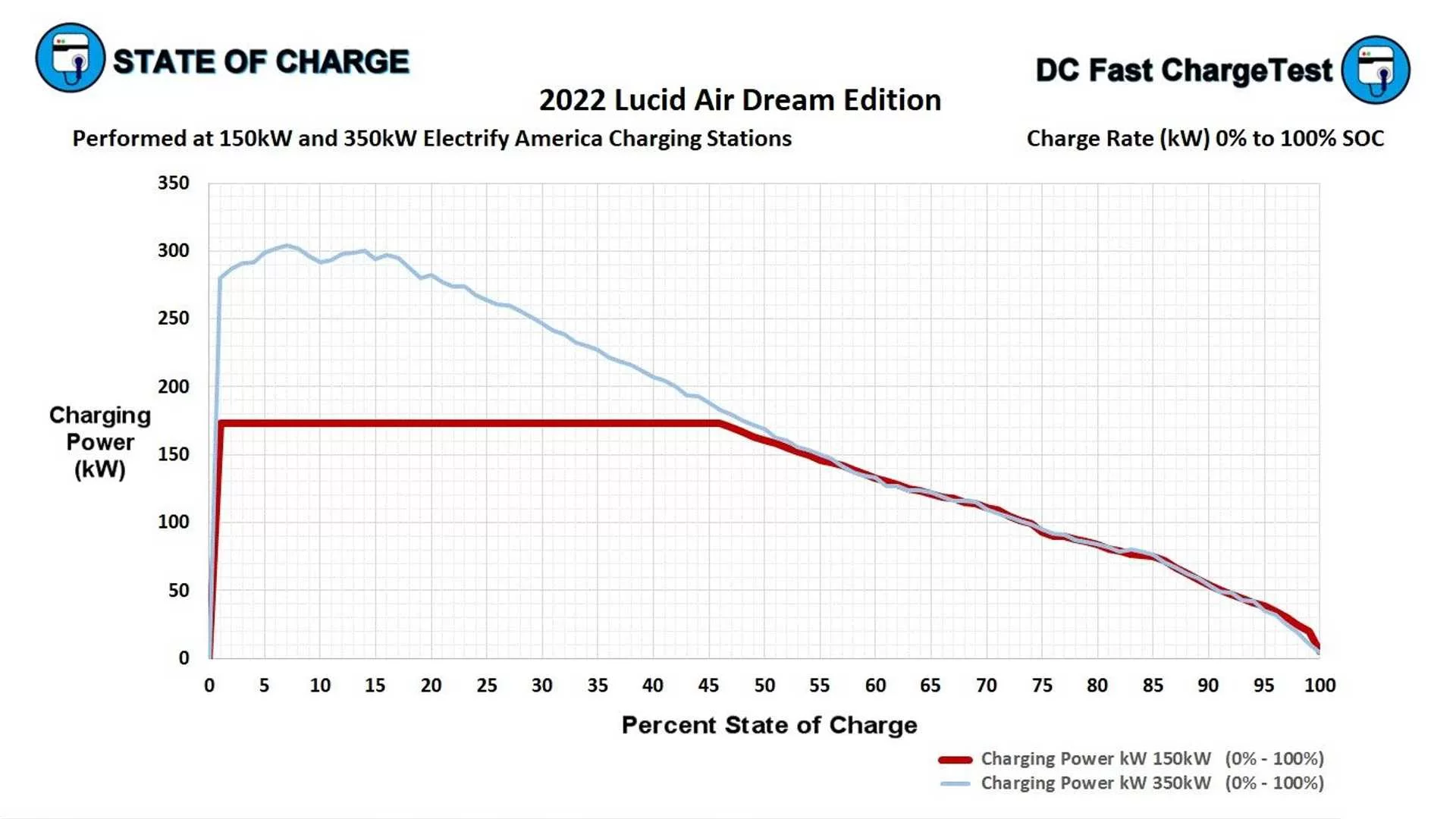

Am I doing something wrong or is pulling just 90wk normal?

Depends on your battery temp, ambient temp, load on station, etc. Here's an optimal charge curve right now, subject to change in the future through OTA.
This was such a great test because it showed that you only benefit from a 350kw charger if the car is less than 50% SOC and you’re in a hurry.
This is why I think the often down 350 chargers are not worth it. If you are at 10%, the 350 is going to be ~4 minutes faster to 45% 8m vs 12m, from there on they will be the same. You waste more than 4 minutes when the 350 doesn’t work and you have to move to a 150.
