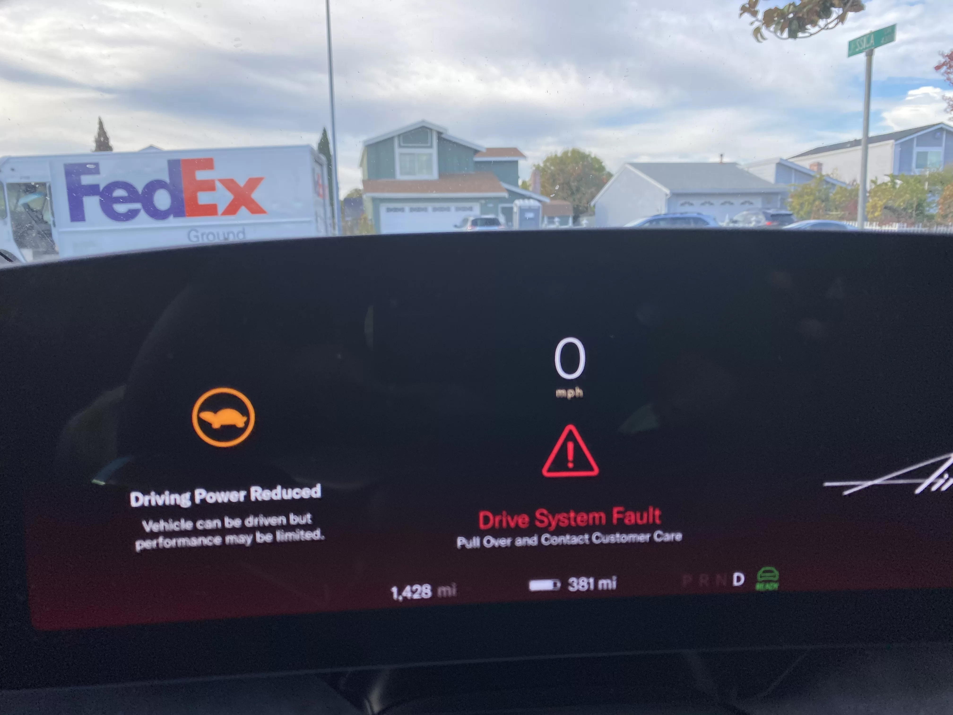

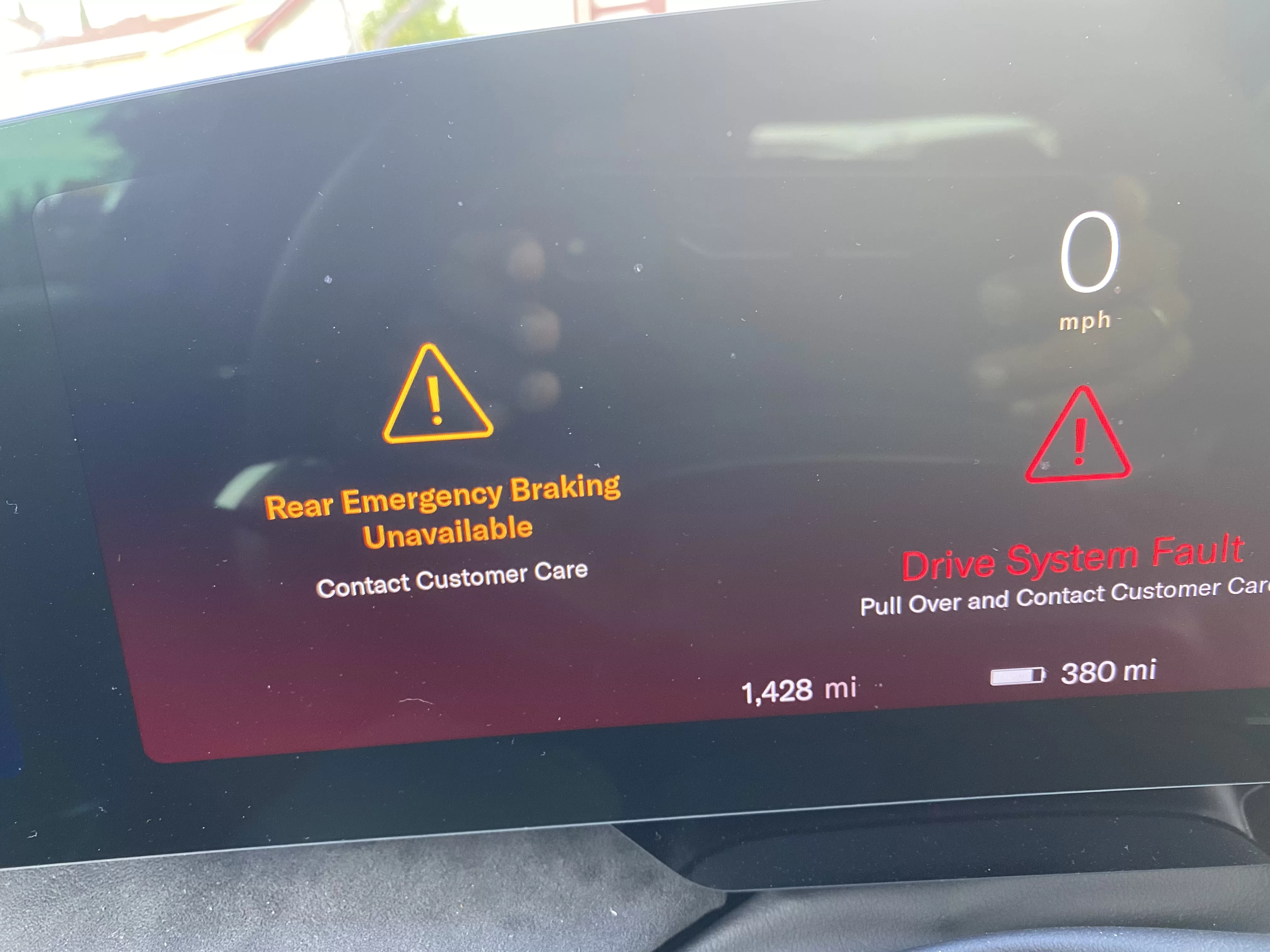

Anyone seen above?
There are forum members who have experienced this error. Sorry you are off to such a rocky start. Please let us know what they found.
First time after reset the problem went away.. it came back soon and this time there as a jerk … when parked car started rolling back..
Lucid has opened service work order for this… let’s see what they find

After power cycle error goes away but regen breaking feels weak and car is bit sluggish

Car in shop for more than 10 days, they had to create a fault ticket for engineers to look at
Lucid has not told me yet what the issue is as they are trying to figure it out … this is concerning
Of 6 weeks of owning the car, the car has been in shop for 3+ weeks on two issues
Lucid just confirmed, rear drive unit is at fault and will need to be replaced
