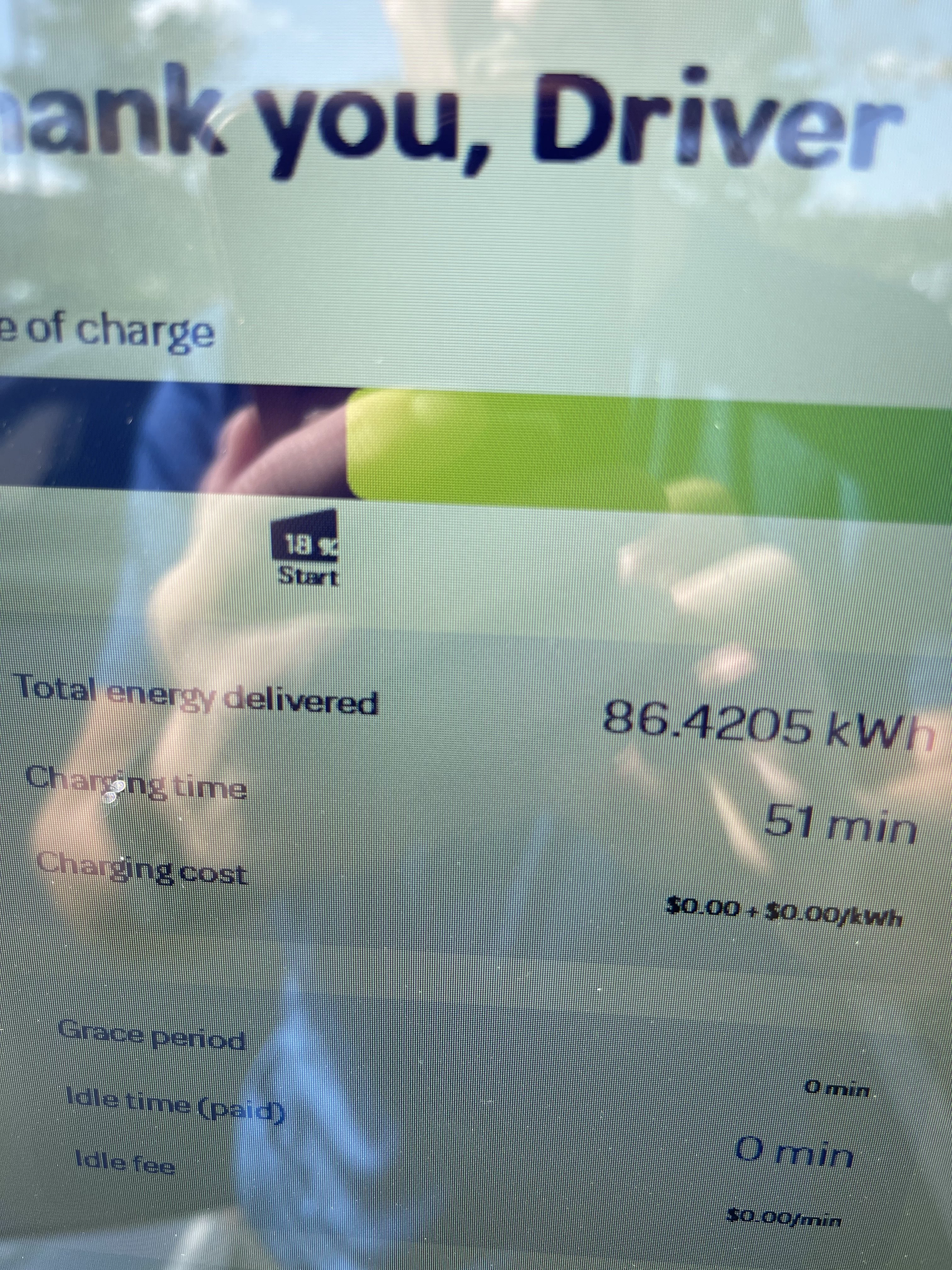

Just got home from EA. 17 -> 90% (long trip tomorrow). This was on a 350, max I saw was 145. The charger in Rancho Penasquitos (San Diego) has never let me down but I’ve never seen more than 145 on any of them. They were 2 out of 10 not working today. It was like a car meet (Car and Charging?) today, there was a Taycan wagon in a good looking burgundy, a Mercedes EQS SUV, an i4, and a bunch of Ionics and ID4s. There was a Model Y there and I asked him why he doesn’t just use the nearby supercharger and he said because it is much more expensive. The Lucid definitely got the most attention.

Several attempts to connect with EA 350 in Port. St. Lucie Successful on the fifth attempt! Didn't have to call either Lucid or EA so I consider it a success. Max'd out at 154kw.

Just did a round trip from Prescott to LA. Stopped at 3 EA locations. Quartzite, Indio and La Mirada. Had no issues connecting or charging. Max charge rate was 140kW, even on a 350kW. New style stations were all plug and play with no need to use the Lucid App to select station.
The issue was there being a queue to charge at all locations. Lucky for me, I didn’t have to wait long. Those behind me did. Biggest culprits being Rivians. Big batteries and charging much slower than the Lucid. All needing to charge to 100% to cross the desert.
