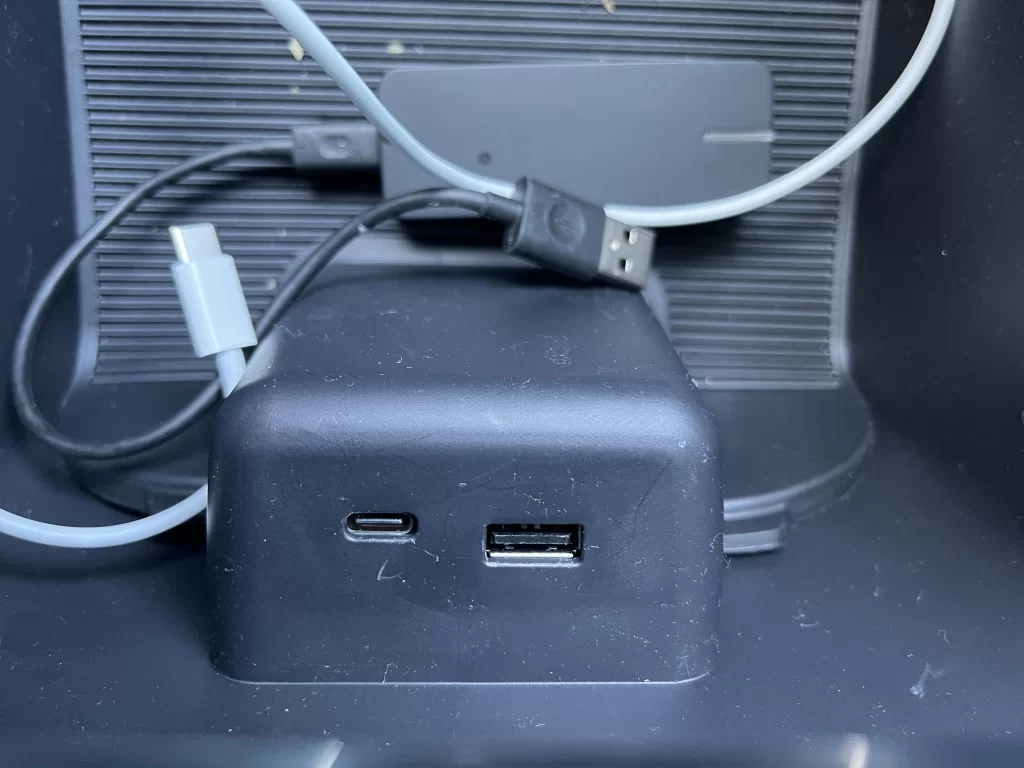

Also that thing with the wiggling is interesting ...can you shoot a close up photo of the USB-C port on the Lucid?

I now notice that the USB ports on the Lucid have a plastic gap...I wonder if that could be the issue that people with USB-C are having. If anyone has a USB-C to USB-C extender, can you please try and say if it makes a difference?
@xwave - can you confirm it does NOT work on USB-A too? If yes also what phone do you have? Might be a defective unit, although that's rather rare.

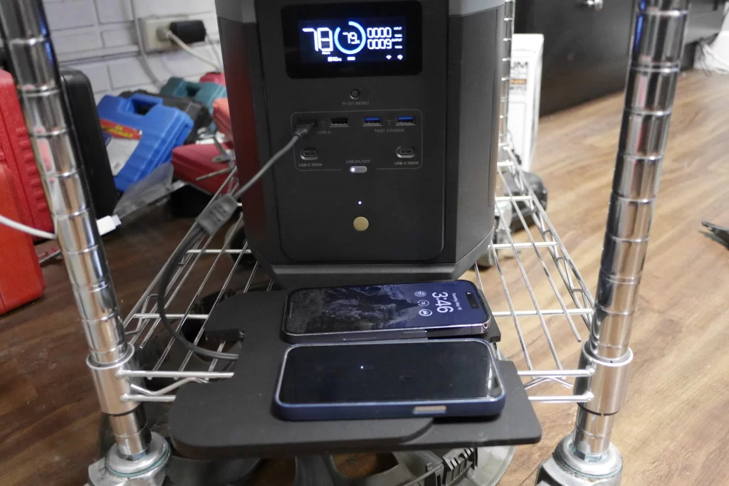

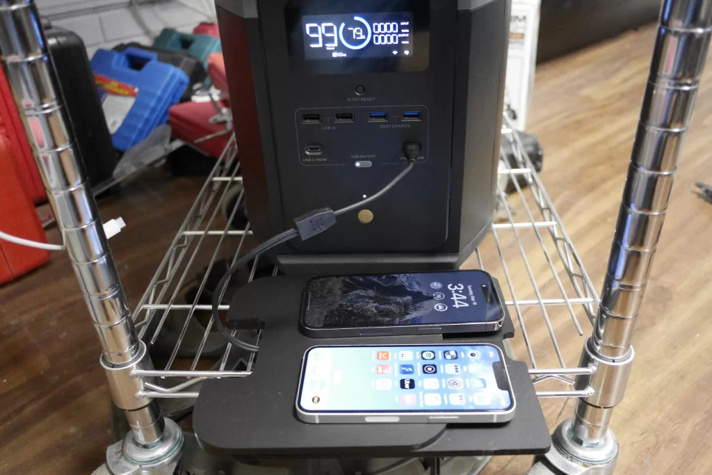

I tried two different iPhones and connected to the power bank.
usb-c still not working but usb-A is working now.

As discussed earlier in this thread, our current charging board only supports a handful of charging inputs & protocols so I am not surprised if it doesn't work on most USB-C ports, but it generally has to work on USB-C ports in cars sans some Lucids apparently. (We also do this for Mach-E, Rivian and Model 3/Y and it works fine there, so there is something different with the Lucid that I am yet to find out).
With that said, it must work on the USB-A, and gen2 which is a few months away should work on Lucid too, as gen2 will support almost any charging input under the sun.
