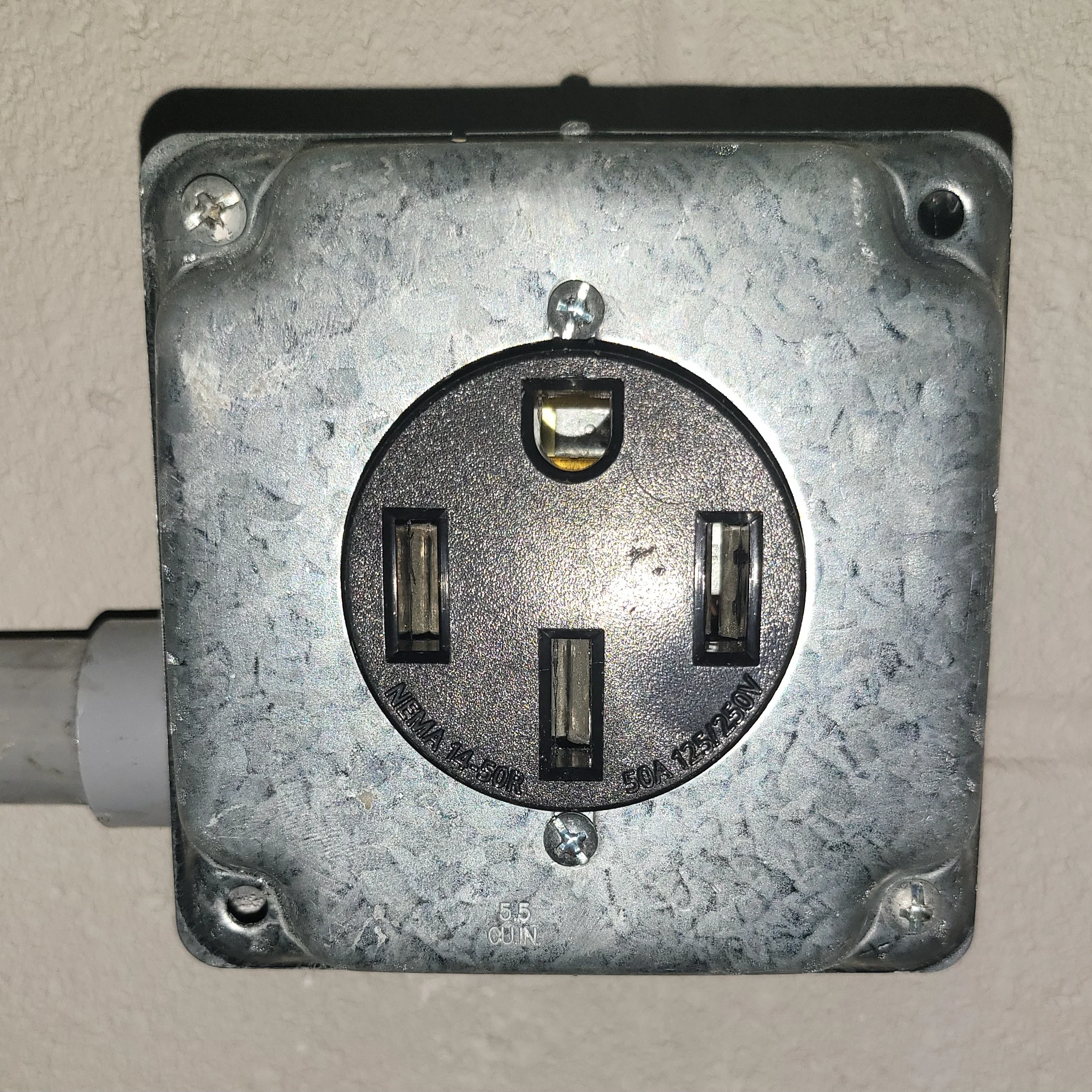

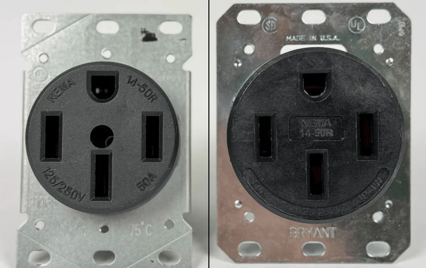

Well, I took a look at my 14-50R outlet (Photo attached) and it certainly appears to resemble the lesser-quality version (Searched image LEFT). It does not have the additional clearance around the blades. I haven't removed the cover plate to inspect things further.
Of course I made it abundantly clear to the electricians that I would be charging an EV at 40A continuous, but apparently they cheaped out on the receptacle. 50A breaker was installed as expected, and I can only assume the choice of wiring was appropriate for the current (Have to question that now, too, I guess.)
This work was done in August of 2024, and the throttling did not begin until May of 2025. I'm led to conclude that, in my scenario, either:
A) The software was updated to actually respond to dangerously high temperatures at the outlet. I was just "lucky nothing happened" for the past year, as I regularly charged at 40A.
or
B) The software/Control Unit has always been capable of throttling this way, but the outlet finally became damaged enough (as of May, rather coincidentally) to cause excess/uncontrolled heat and now I'm seeing an automatic response to this.

I think it's good that you posted, as we can't automatically assume it's the car software.
My own guess is that ordinary thermal cycling on your oven-rated receptacle has loosened one of the wire connections enough to start causing a problem. There's enough copper around that when the receptacle overheats, the heat travels into the plug and cable, which you can feel.
One of many old threads on the issue: https://lucidowners.com/threads/har...ant-cooper-14-50-receptacle-not-leviton.6537/

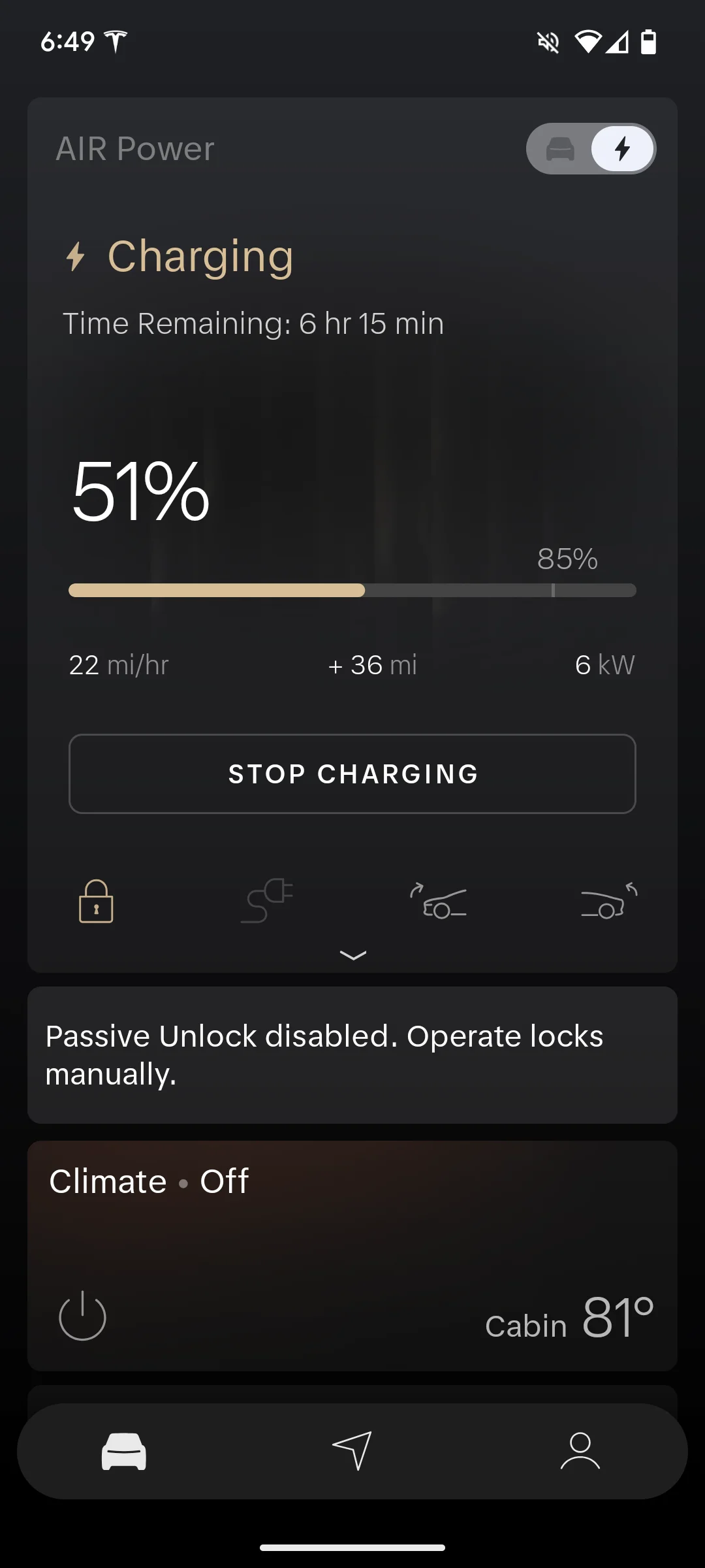

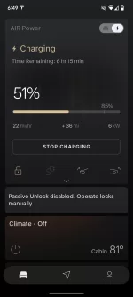

Garage is 75 degrees in the Seattle area. I have a fan pointed directly at charging port. I still got slow down after about 30 mins. From 11kw to 5 kw. This is on my 2 week old Touring. But the same behavior on my previous 2 yr old Pure after a software update maybe 6+ months ago. I know I'm not the only one. Hopefully a fix is in the works.
This is all really good data we’re compiling in this thread on this issue. The Seattle example above seems to strongly point to a software issue from that update just before 2.7.0. But as @DeaneG said, maybe it was intentional for safety reasons? I’d still like to know either way.
