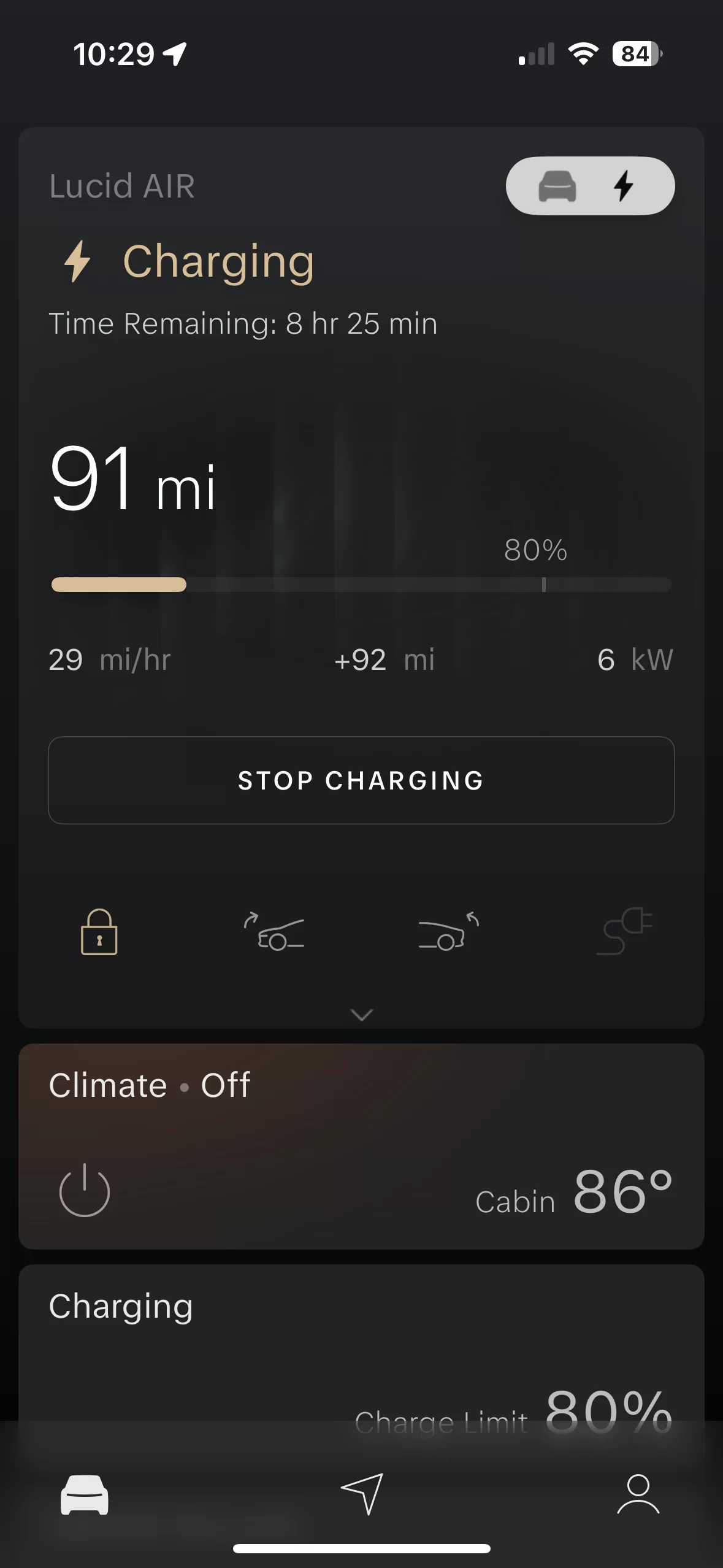

2023 Air Pure AWD. Using Lucid LCHCS. 100A. Same issue after recent OTA upgrade. Dropped off significantly to around 15 m/h and 3-5 kWh. Went from 1-2 hour time to charge up to 6-10 hours! I stopped the charging and noticed the AC running while it was charging. I turned off the AC, unplugged the cable and began charging. Immediate improvement back to old speeds. Now charging at 77 m/h and 18 kWh. Now 60-90 minutes to charge up to limit. Maybe this helps solve the slow charging issue many have experienced. Let me know if it helped you too.

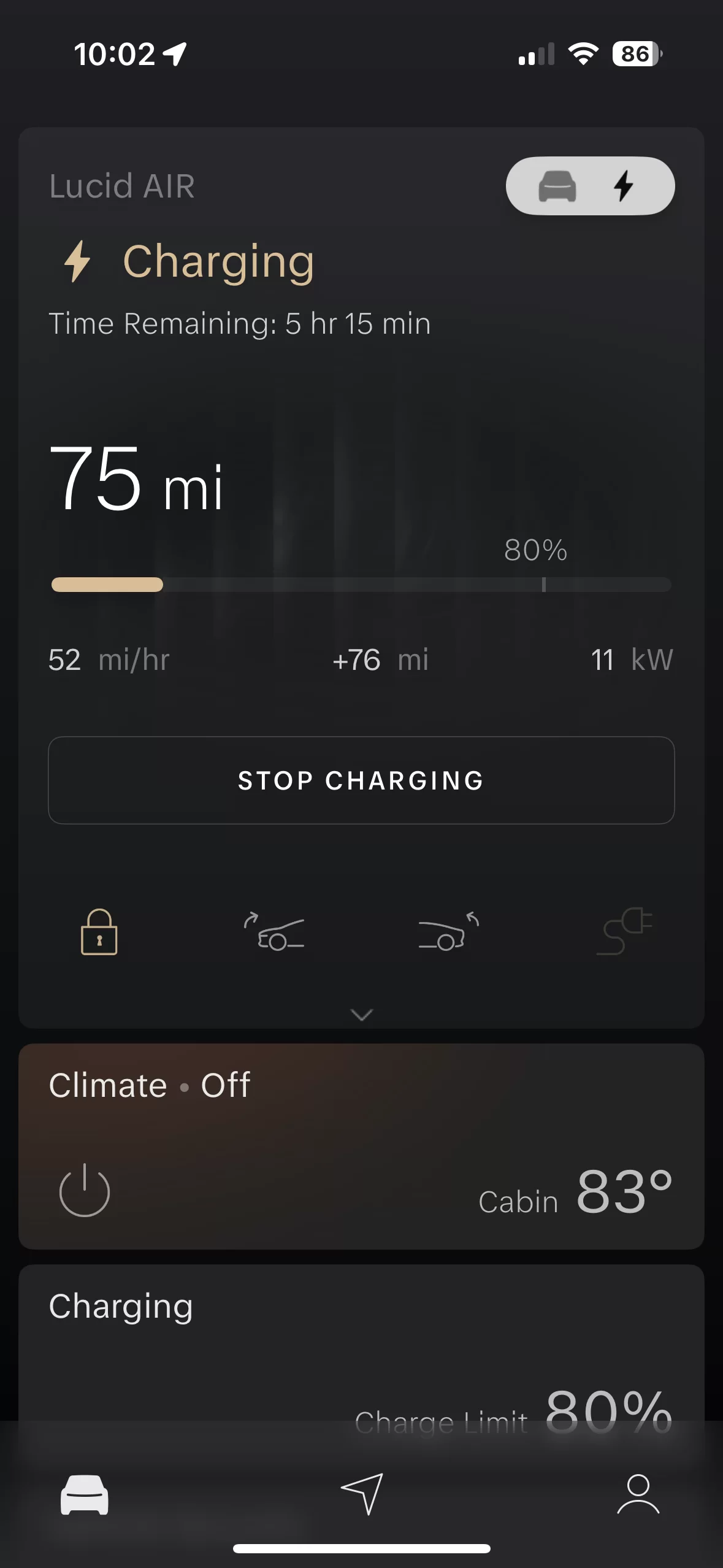

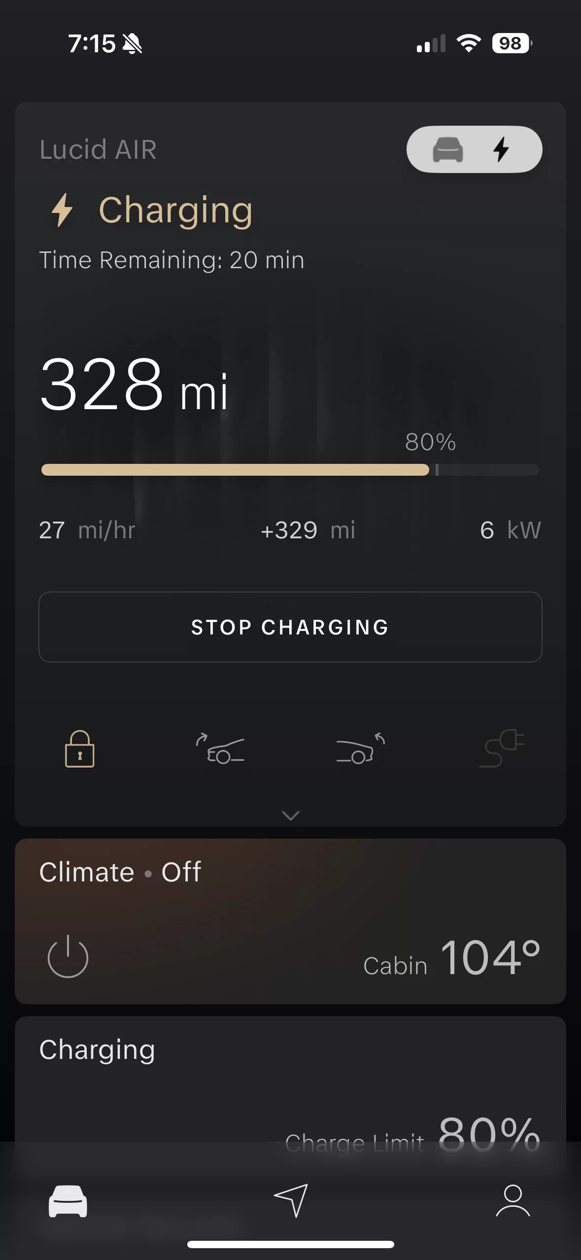

So here’s a perfect example. I was down to about 80 mile range so time to charge at home. The second screenshot is from 10 o’clock at night and you can see it starts off just fine at the full 11-11.5 KW from the Tesla gen three wall charger. Not 30 minutes later and probably less I just didn’t check it sooner you see it’s now dropped to 6 kW. I have a large grade dehumidifier I recently installed in the garage so the humidity is literally down into the 30s even here in Miami and the cabin temperature is overall reasonable for this time of year as well. The speed is gonna fluctuate the rest of the night between six and 7 kW.
This never happened in the first two months. I had the car starting in March of this year.

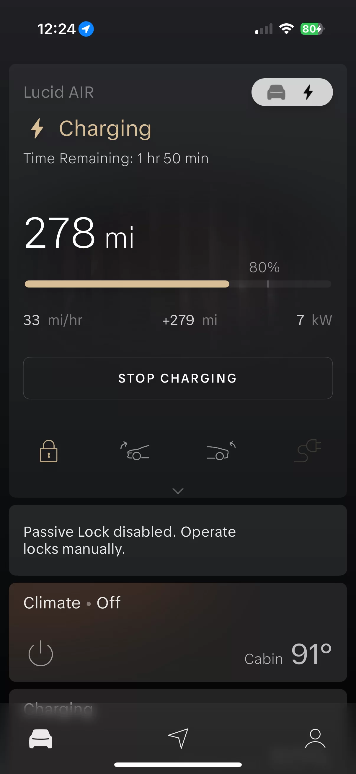

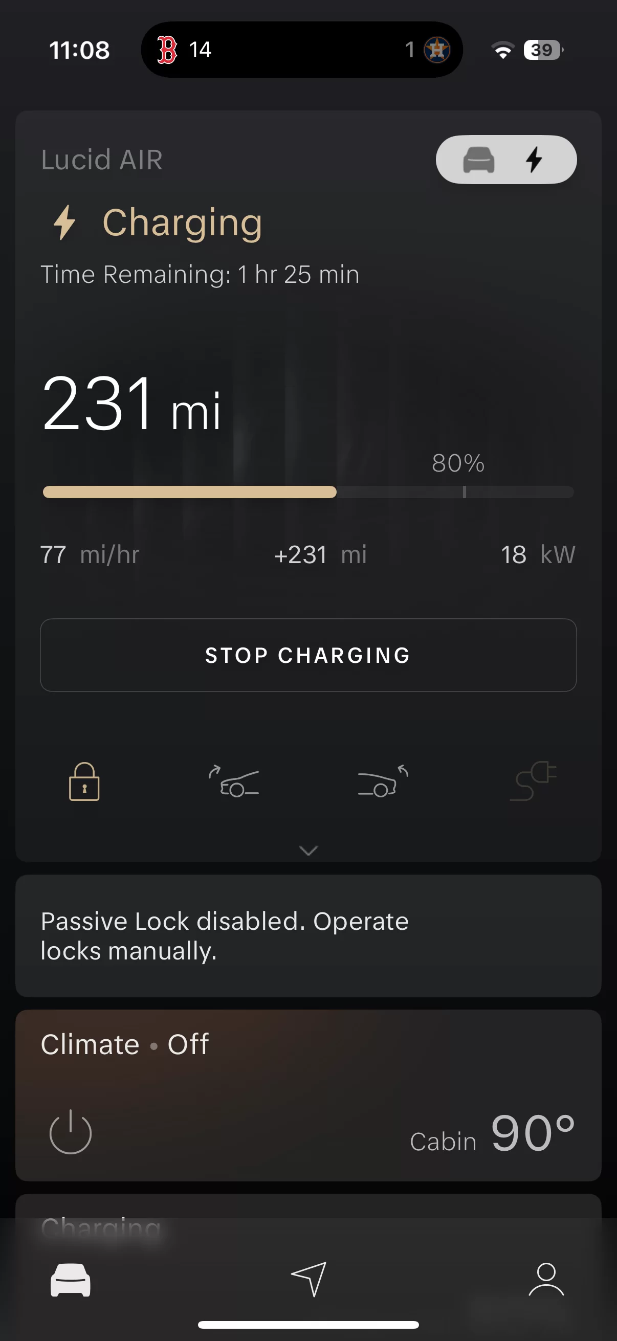

I’m on a 100a breaker with the LHCS connected to a sub panel installed by an electrician and properly torqued. Used to see 18kw dropping to 11kw occasionally for temp management but now I see 18kw dropping to 7 for extended periods of time.
Took maybe 3.5-4 hrs to go from 55% to 80% overnight. Didn’t pay attention to the exact times.
I can say though that it started at 11:08 pm at 55% SOC.
At 12:24 am it was at 66% and had added only 47 miles. At 11:08 the intial estimate in the app was 1 hr and 25 mins. At 12:24 the estimate was 1 hr and 50 mins remaining.

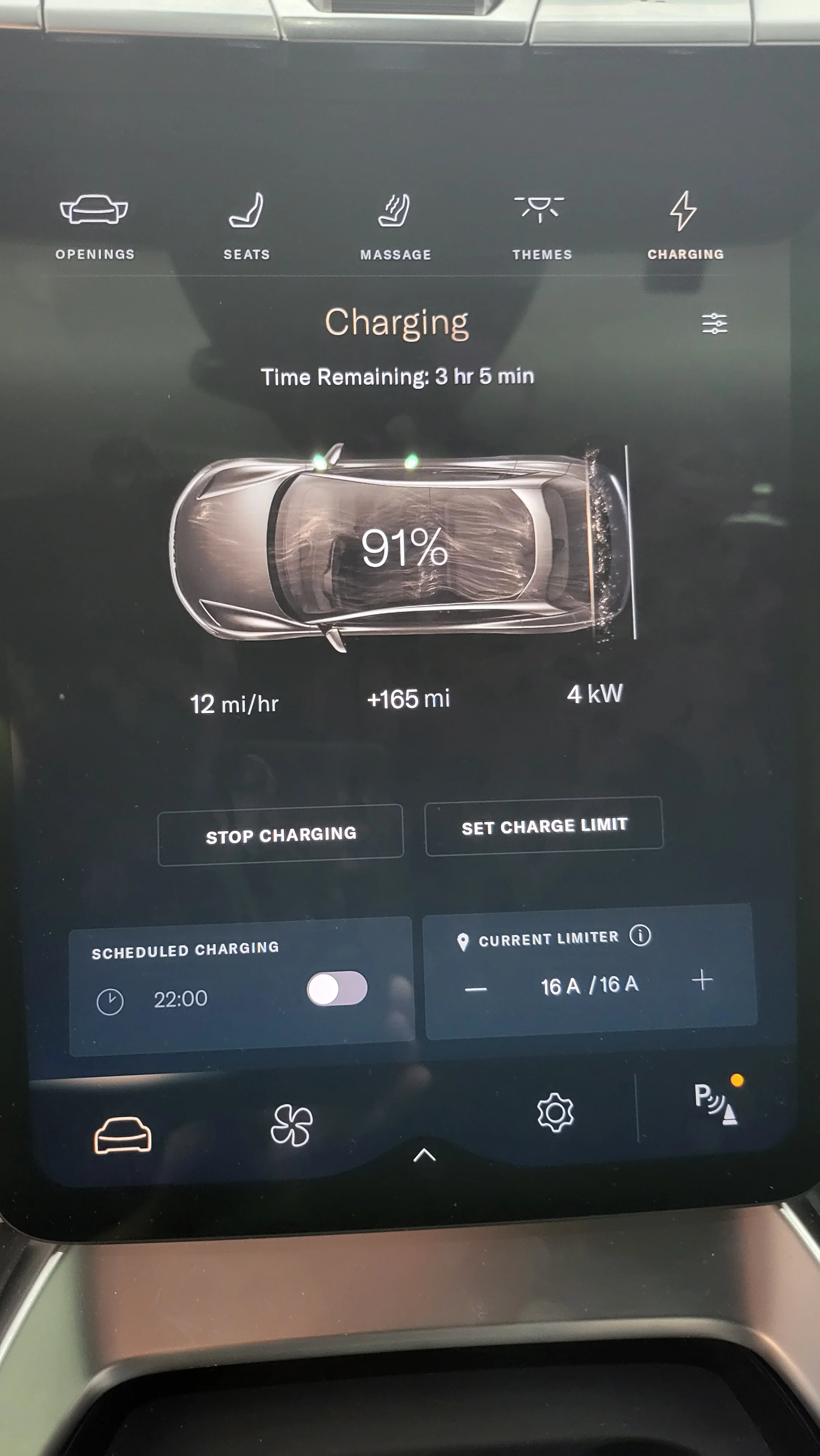

Thanks to the most recent update that allows us to view/adjust the Current Limiter, I was able to snap this picture which effectively proves the vehicle is in control of what's happening here. Normally, the limit is "80 A". When inexplicably throttling, the limit range is reduced to "16 A".
It's quite frustrating to wake up at 6AM for a 400-mile drive and find out that you're going to have to stop en-route because the car decided the original Time Remaining was far too soon and should have a few more hours tacked on.

I didn't even realize this thread existed; probably skipped past it because it immediately refers to the LCHC, which I do not have. I'm using the Mobile Charging Cable in a garage, and have run into this approximately-half-rate charging issue since May. I......Thanks to the most recent update that allows us to view/adjust the Current Limiter, I was able to snap this picture which effectively proves the vehicle is in control of what's happening here. Normally, the limit is "80 A". When inexplicably throttling, the limit range is reduced to "16 A"....
That 16/16 A indicates that the mobile cable is telling the car that the car may only pull 16 amps from the charging cable (the bottom 16 amp numerals), and that the car is doing so (the top 16 amp numerals).
The mobile charging cable is throttling the charge rate to 16 amps, likely because the 14-50 receptacle is overheating. This is very common if a residential-grade receptacle is used, and can result in a fire. The correct (EV-rated) type of 14-50 receptacle has a face diameter of about 2.44 inches. Residential receptacles that are not safe for EV charging have a face diameter of about 2.1 inches.
If after charging for a while, pull the mobile cable's 14-50 plug fully out of its receptacle in your garage, and touch the plug's prongs with your fingers. They will feel warm, but should be only pleasantly so. If they feel hot, the mobile cable prevented a meltdown and/or a fire by throttling down.

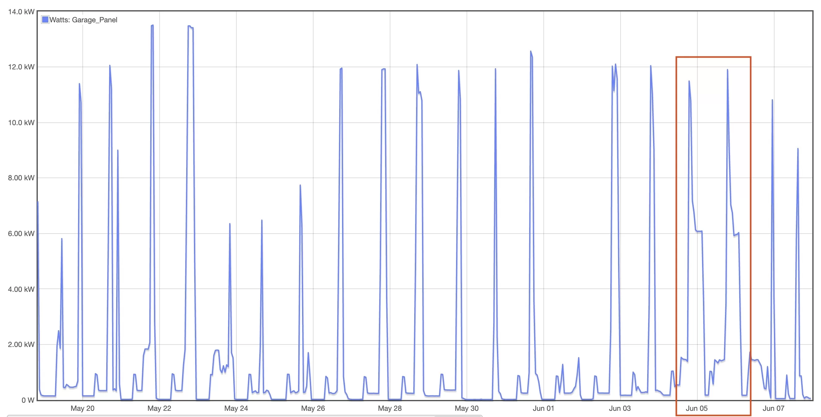

I just noticed a few nights ago that my car was only charging at 4kW when it should have been charging at ~9kW, and now I've found this thread. I am NOT using a Lucid wall charger though. I'm using a Tesla wall charger, v2, with a Lectron NACS -> J1772 adapter.

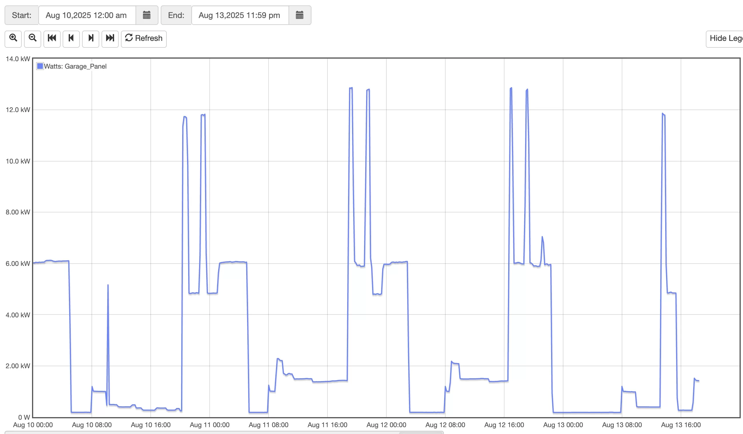

I have pretty good monitoring on my electric usage, but unfortunately I can't differentiate specific things connected to my garage subpanel. From historic graphs though, it appears this behavior started on June 4th:
The pattern looks pretty regular in recent times:
This looks like a software controlled thing to me. The shape is very regular.
