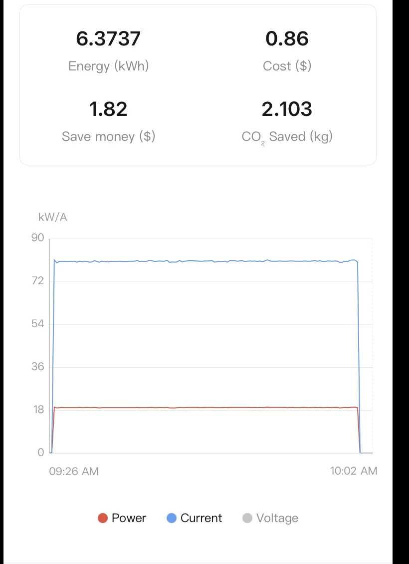

After reading your posts, I ran a test with my Autel Maxi Charger (80 amp). After charging to 80%, with the garage at about 90 degrees F, I charged to 85% to see if the charging degrades after 80%. Here is the charging graph for that brief charge. As you can see, the current held steady at 77 to 80 amps and about 19 kW. So I do not think that the car or software or temp is responsible. I thought y’all would be interested

That’s too short of a charge. It sometimes happens within half an hour, but sometimes takes 60-90 minutes or longer. You should test it on a proper overnight charge.

Good point, but I was checking to see if it was the temp or over 80% reduction.

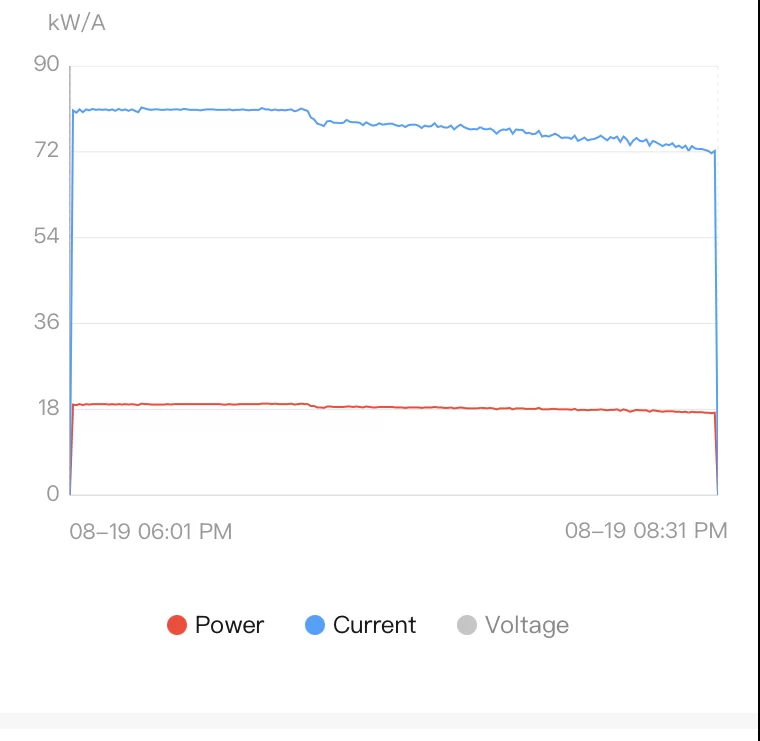

Cannot do overnight as the charger is so darn fast. Here is one where I was going on a trip and charged to 100%. Still at 80+ degrees F.
It did drop from 80 to 72 amps, but the kW was at 19 to 17 with an average of 18 kW. Adding about 45 kWhr or 40% during the session.
So again, I would look at the charger.

The second one was for 2.5 hours! Only a slight drop off. I do not see me getting below 20% anytime soon. The one above show from about 60% to 100%. Not sure it would be any different with 20%.
Just trying to help. It’s not the car! Probably the charger or electrical issues.

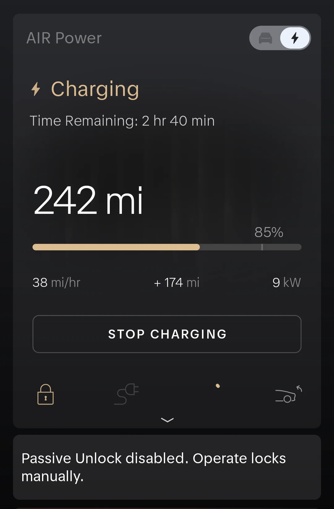

Alright I believe I've found a workaround to the charging speed drop offs. What I did was start charging normally then immediately set the charge limiter in car to 40/48 amps. It has been almost 3 hours and no slow down with a steady charge rate of 9kw (38 miles per hour). Not the usual 11kw I get before a slow down, but still better than the 5kw it would go to after about 30 mins of charging. Charger used is a Tesla Gen 3 wall charger with adapter. So for those of you that are experiencing the slow downs like many of us the past few months after an update, give this a try and let me know if it helps you.

I’ll try it! 9 is better than 6.
40a and 56a have worked for me without throttling.
Today ambient temp was 72F and on whim I pushed it to 80a with soc at 52% to charge to 80% and was throttled to 7/8 kw after about 25-30 mins of 17/18 kw.

Update, manually throttling down after starting a charge didn’t do anything for me.
once its in a high temp state, manually throttling down makes it charge at less than 50% of setting, irrespective of what that setting is. meaning, if you set it to 40a after its warm, it won't use it all. it will only charge at less than 50% of that because its already warm. its like its programmed to cut back to under 50% if it detects overheating (like some sort of exponential backoff). if you start it at 40a while temp is considered ok, it holds the 40a consistently. same with 56a.

No I understand. I started it at the full 48amp and then a min or two in I reduced to 40 and it still decreased about 30-35 mins into the charge session.
I’ve also just tried to start it much lower like 32 amp and same thing happens.
