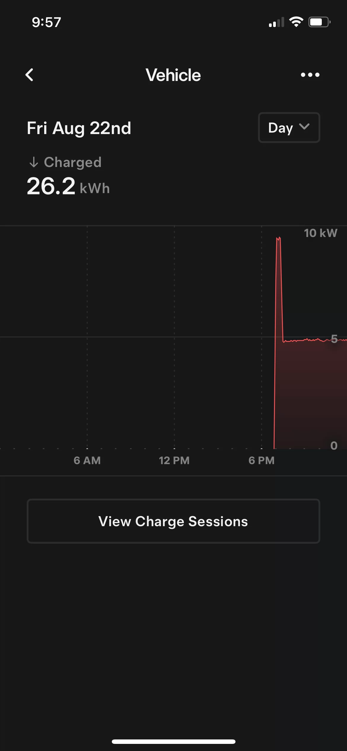

Basically Miami garaged vehicle on V3 Tesla Wall Charger that I used successfully at 48 amps on my two prior model 3 performances without issue. Only difference here is the lectron adaptor at the end of the charger.
Everything worked normal for the first two months I had the Pure beginning in March. Then sometime in May around the time of the update I THINK just before 2.7.0 it started this throttling behavior. There are several others in this thread who’ve had similar behavior begin around the same time in even cooler ambient temps then where I am.
That’s it in a nutshell.
I have pretty much the same set up. I had no issues for about 1.5 years. Then it seem like there was a software update and then I started to get the throttling. I'm surprised more people aren't speaking up on this.
Yeah, to me the key point through all of this is that in your case, and in mine and a few others that have popped up in this thread it appears that no conditions were changed before the problem and after the problem. That’s why I think we initially thought maybe it was the warming temperatures around May But there have been plenty of posts in this thread that make me doubt that especially post from people in Colorado and other places where although warm it’s not even anywhere close to where I am in South Florida. The common thread seems to be around Maytime, which leads me to believe it was a software update. Now, maybe it’s a safety thing that was intentionally pushed to the vehicles, but I just wish we knew that one way or another.
looking forward to a robustness update to address this. that would be a fitting release note!
