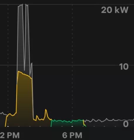

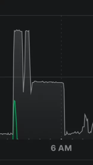

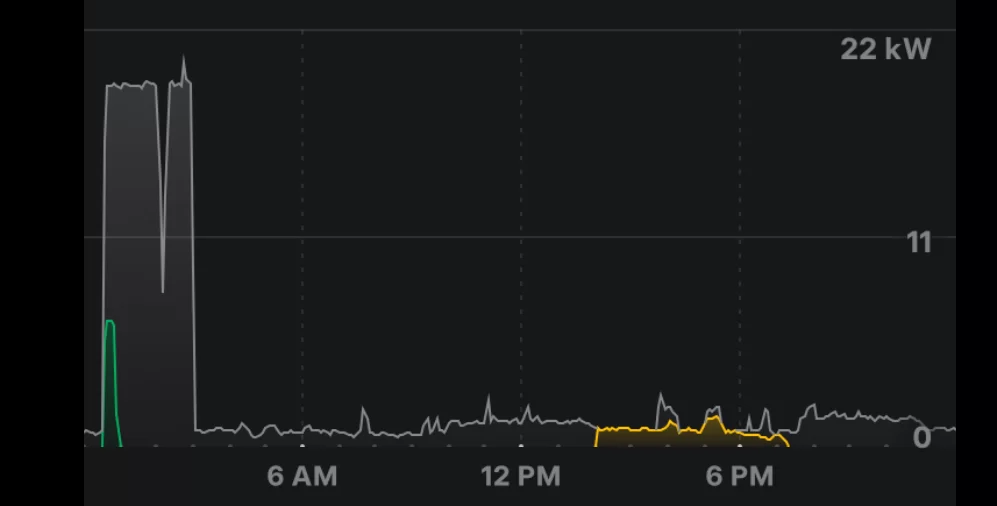

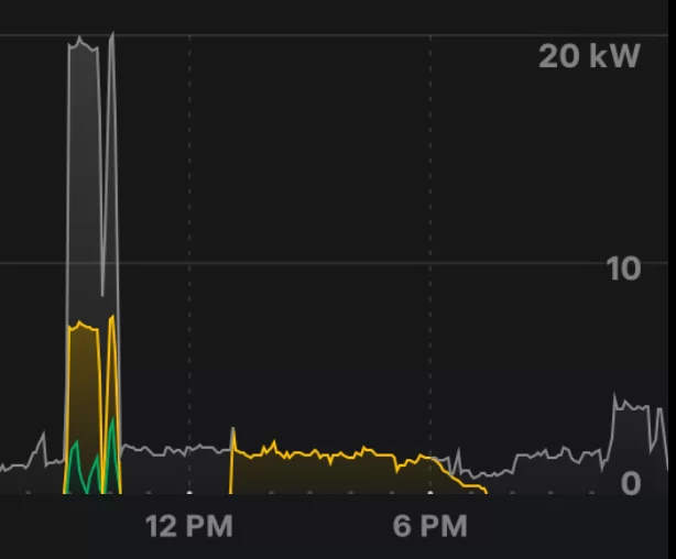

I have noticed the same thing recently. When charging overnight, it has alway run at 18kW or so. As of late, it will run at 18kW and then dip to 7, back up to 18, a few times during the night.
Some photos of the electric draw during charging. Lucid home charger for 2-1/2 years. Only recently is doing this. Has to be some update. Good to know others are experiencing the same thing.
