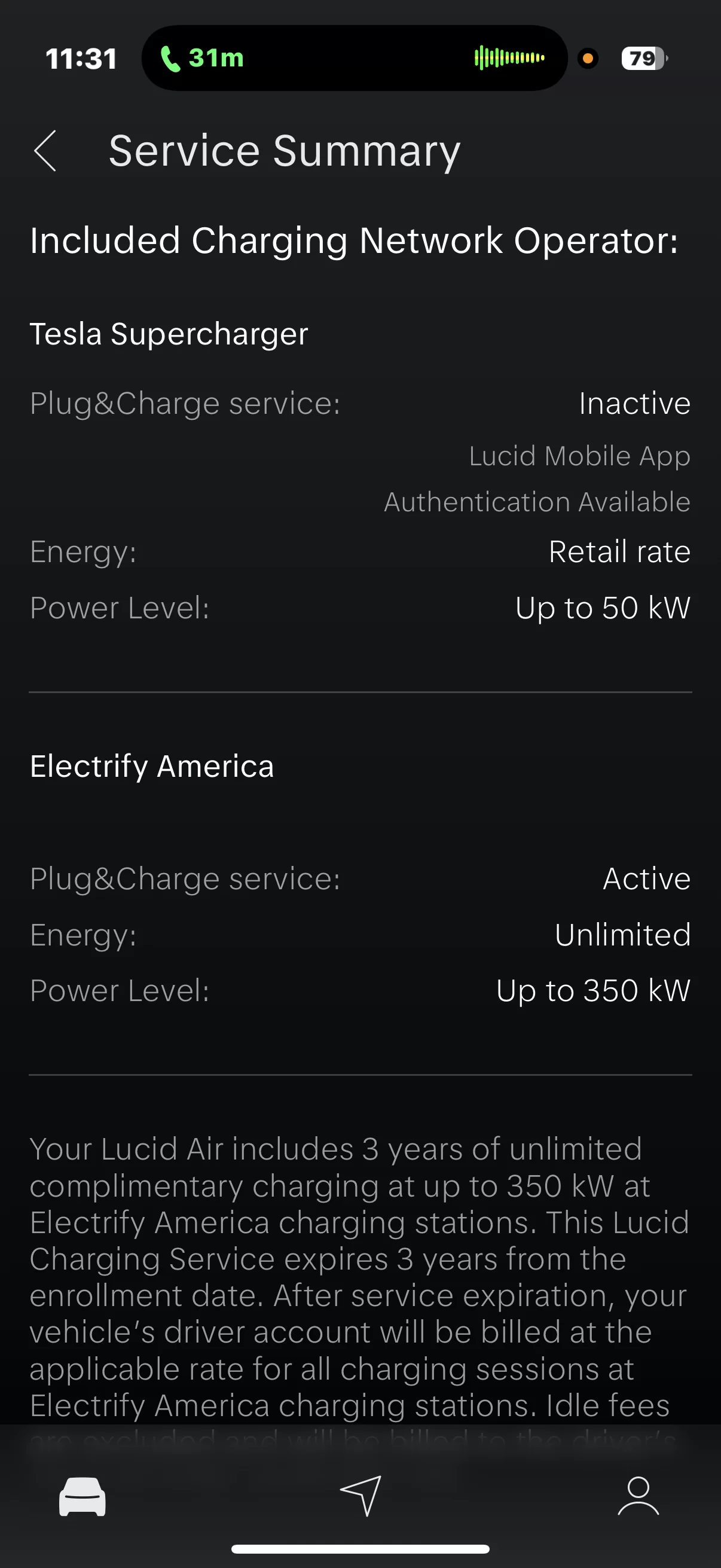

In the phone app, it says that Plug n Charge is "Inactive".

I spoke with Lucid tech support and sent them a screenshot of my Lucid app (latest version) showing PnC was not activated. He’s supposed to get back to me.
