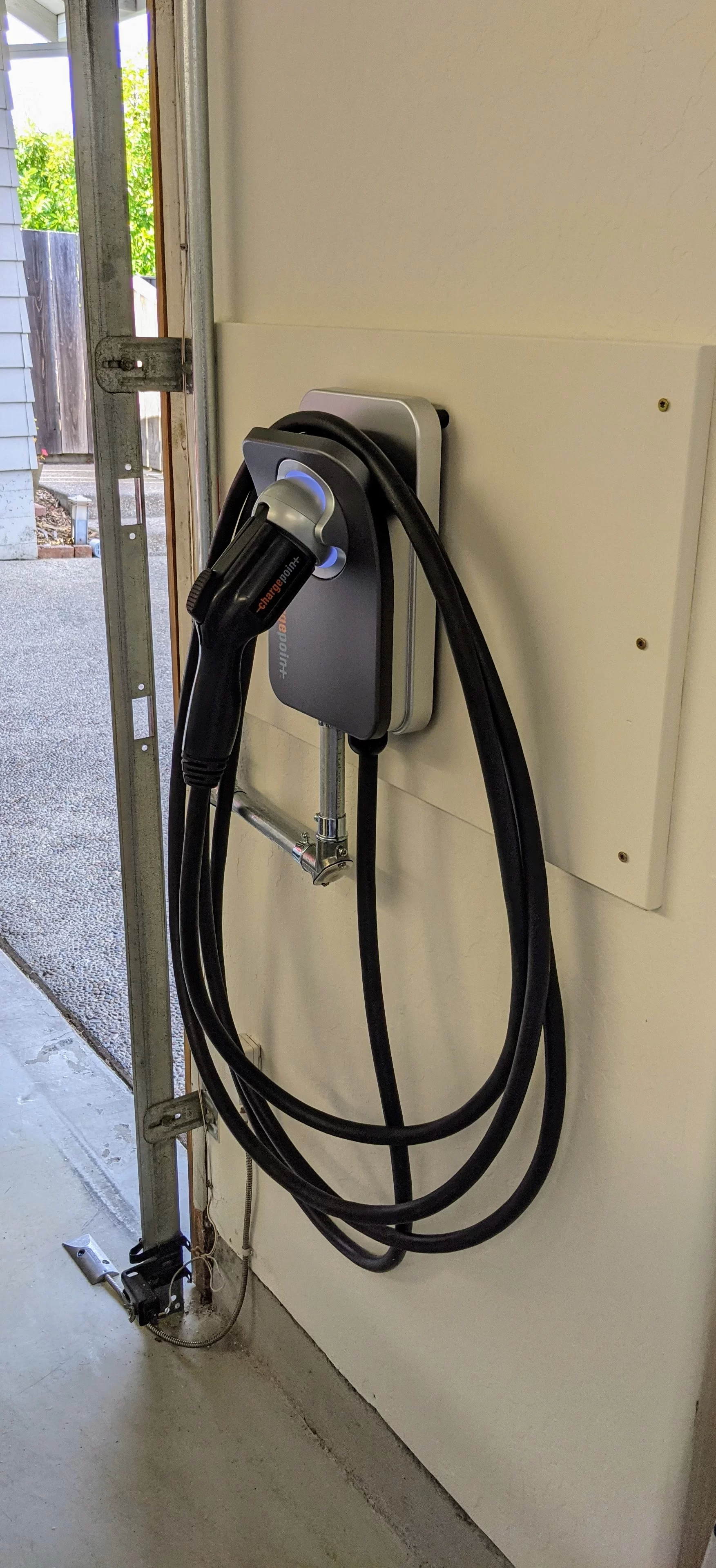

Nice clean installation. Why did you install over wooden base instead of onto one of the studs?
Thanks! After I'd finished I realized I could've done it nicer, but my wife was happy with the result (it's for her car). This location was a short wall with no studs where I wanted to mount the charger. Had to do the same with my Lucid charger on another wall.
