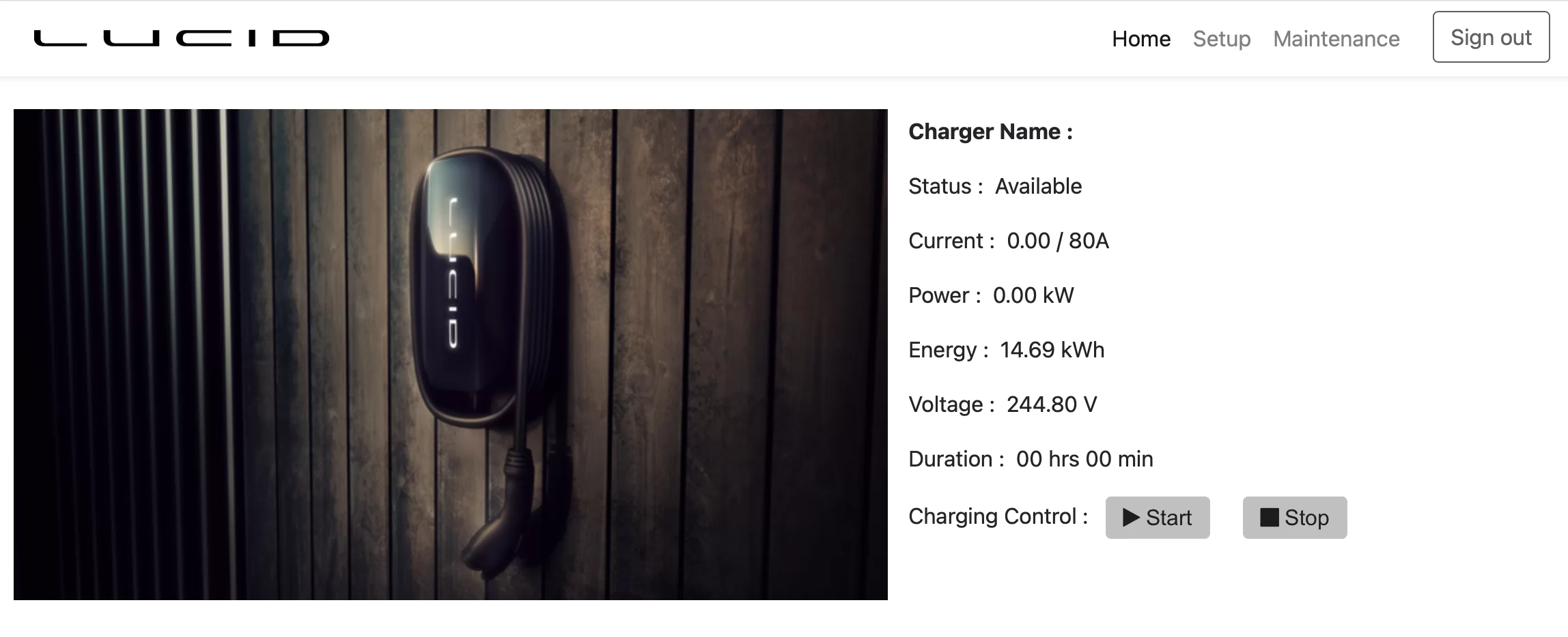

In my LCHCS, control panel i see these new start and stop buttons in the home screen. Also i see a new tab for Device info for the setup screen. Do you know what these are for? Also is there any separate thread for discussing LCHCS version and functionality details?View attachment 7718
I'd say let's start consolidating posts here
