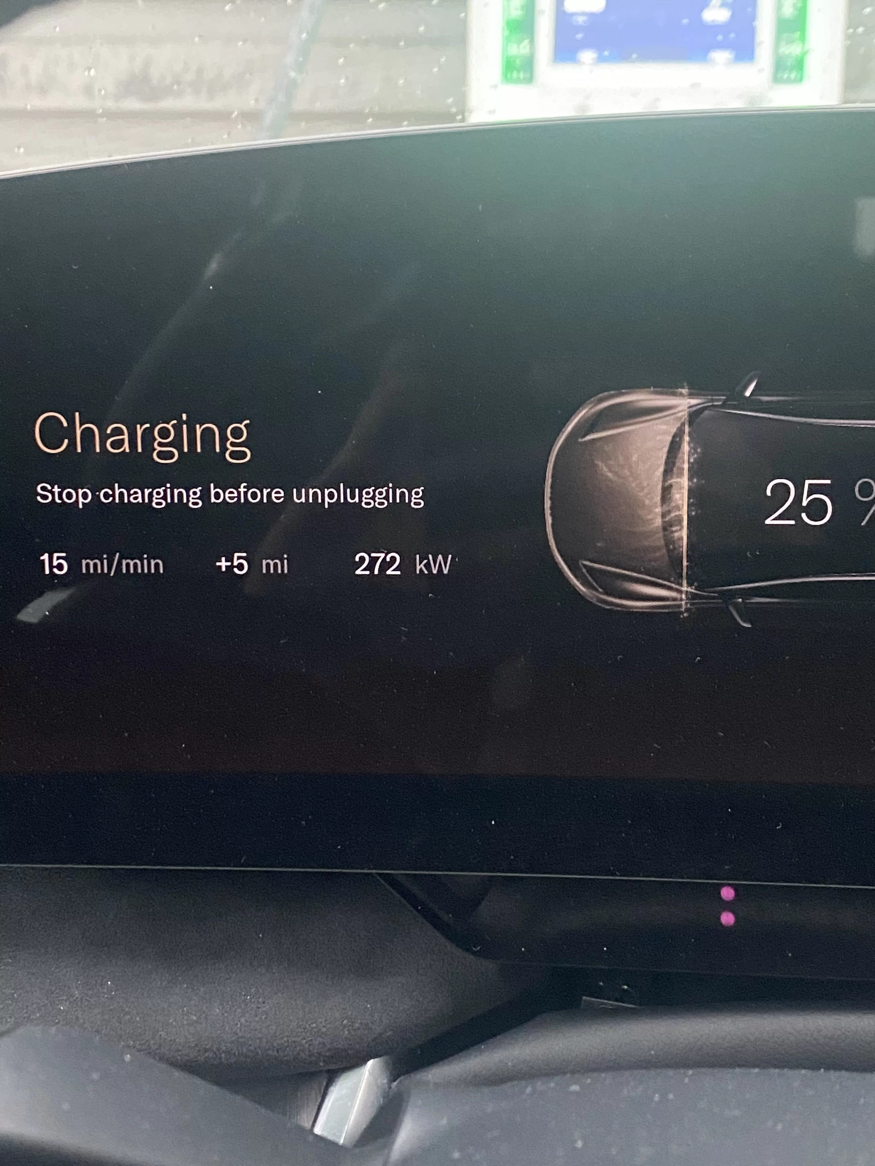

The charging curve has improved drastically. This was at the VW Academy/Research Institute in Chattanooga, TN. During the same trip, a station limited me to 150kw.
I've also seen 70+kw over 85%. Lucid is doing some dynamic adjustments vs strict adherence to the 0-100 curve.
Stations will eventually improve across the board. The software challenges are not easy to tackle. Think about it. A station has to function with a Porsche Taycan with no OTAs from 2+ years ago using old standards for protocol the same way as a new Lucid with latest OTA using the newest standards.
Companies hardly want to accept blame for faulty implementation. They will spend weeks arguing over a possible minor fix (1-2 working days) that could be checked by both sides. Throw in the ever growing and diverse offerings of EVs with their own teams plus a growing selection of EV stations... Madness will be the norm for a while yet.
