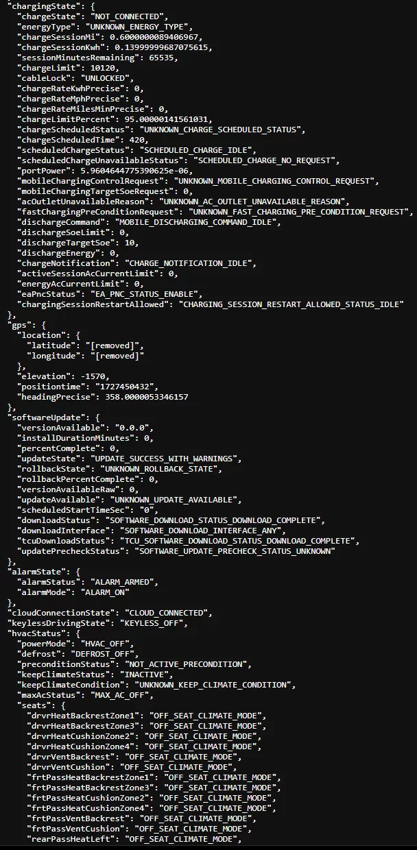

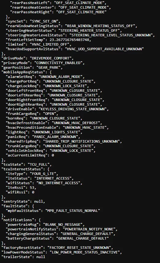

That’s super weird. Grab the state with testmycode.cc and see what it *thinks* it’s doing?
I logged in, I can see the gRPC json, not sure what to look for tho. Never used this tool before.
I logged in, I can see the gRPC json, not sure what to look for tho. Never used this tool before.View attachment 29550View attachment 29551View attachment 29552

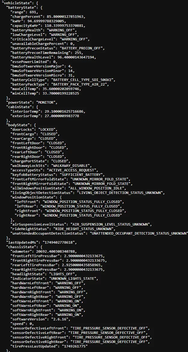

The `powerState` is what you’re looking for. You’re right; it isn’t in a `SLEEP` state but rather a `MONITOR` state.
That state occurs when the body control module wakes up from trunk/frunk access or interior movement (alarm), if the battery management unit calls for heating/cooling for the battery, or if HVAC is on with no keys detected.
Is your garage super hot or super cold?
Yeah, your batteries are between 92.6 and 96 degrees Fahrenheit, which is very warm. Not absurd, but quite hot. Would be nearly perfect for a DC fast charge right about now! Haha
I suspect your car is cooling off the batteries, and that’s why it isn’t asleep. Did you go for a long drive? Or is your garage really hot? The Air thinks the exterior temp is 80.6F or so, so either your Air’s thermistor is busted or your batteries are really hot from a long drive, or your battery cooling is possibly not working well.
Either way, if those battery temps don’t come down soon, you should call service.

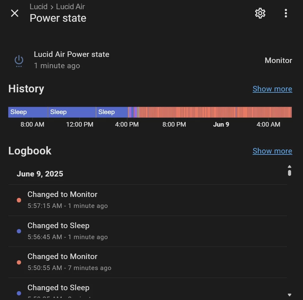

Mine's going in and out of Monitor state as well lately. My PAAK phone is in a cradle 20ft away. I'll turn off my phone and see if the car goes back to sleep.
