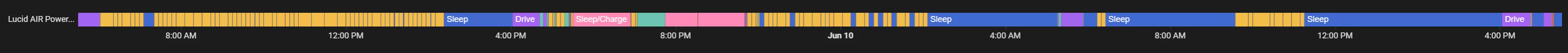

You can see the amount of time the vehicle was in MONITOR mode instead of SLEEP. It was constantly waking up from sleep and going to Monitor mode about every 6 minutes. Was fully charged at 86% on Sunday Evening, Monday after a 50 mile drive to and from work the battery was down to 53%. You can see I resolved the issue this morning around 10am when I discovered the Lucid mobile app was causing the problem. Since then no problems and the car sleeps almost immediately.
When service contacted me today they said they already had 5 other vehicles with the same problem. As everyone else has already communicated if you force stop the app and put in restricted battery mode (on Android) this will resolve the issue. I'm using Home Assistant in the interim.
