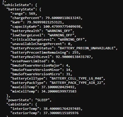

I used the 2.4.1 app to wake up the car. 8 minutes later checked mytestcode api and car indicates it is a sleep. So far looking good. Big thanks to Lucid Devs for a quick turnaround. They must be confident on the fix if being pushed on Friday. Last updated date show June 11th, 2025, so they had a fix on Wednesday already.

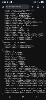

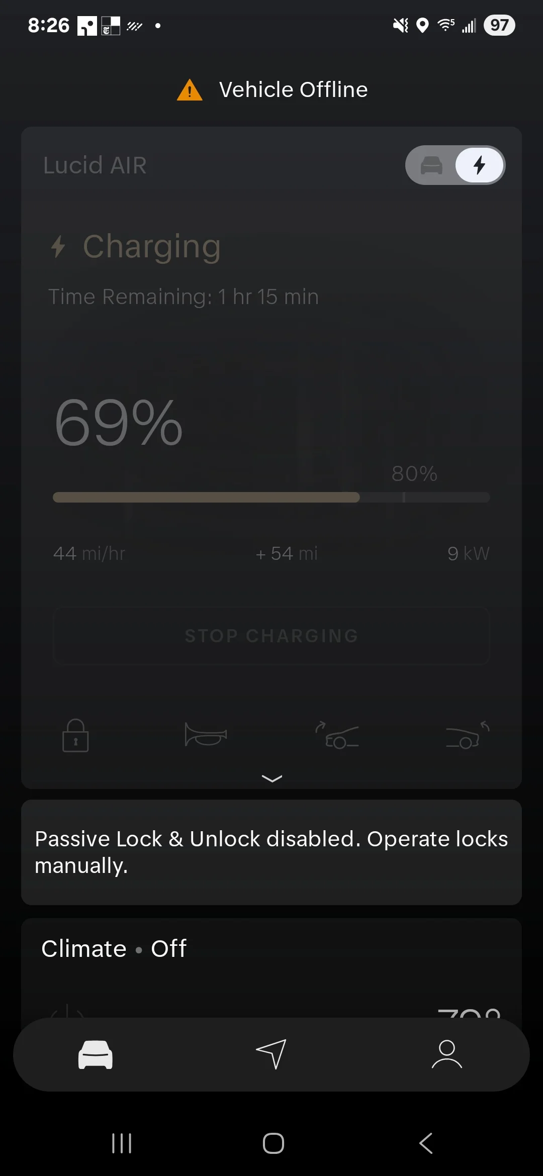

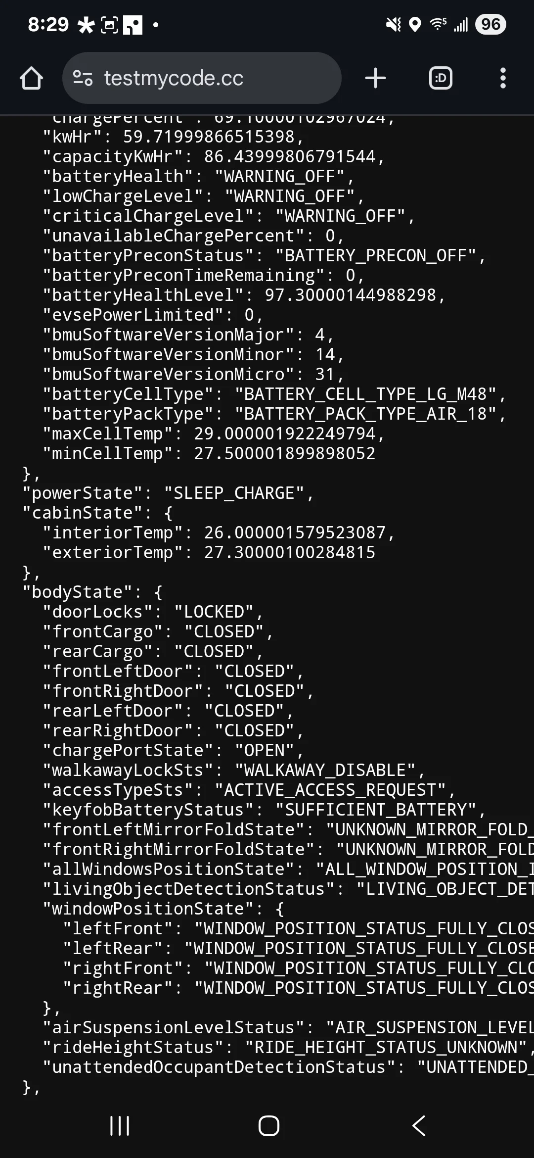

Fwiw while I'm not seeing drain or incessant notifications, the app won't wake up the vehicle from sleep. Powerstate is sleep_charge
View attachment 29696View attachment 29697
