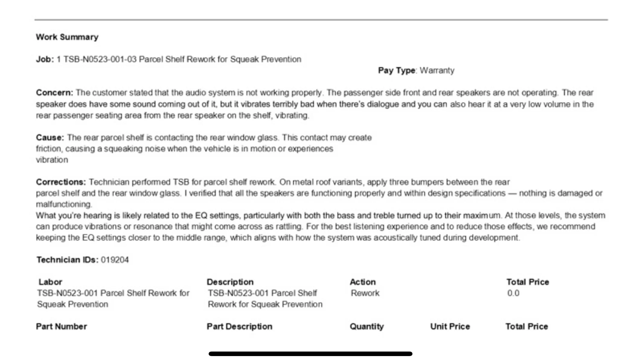

They changed mine last week and it still rattles. My tech says he cannot do any thing. Not sure what my options are now. Rattle is horrible.

That’s a weird experience, I’ve never had them say ā€œI cannot do anythingā€. I’d be interested to hear the why on the service invoice if you have it.
ā€œCustomer concernā€ and remedy side of the invoice would be helpful. Because anytime I’ve had something they try and fix it and the only time they haven’t fixed it was if they couldn’t replicate the bug, which is understandable.

Did you turn the bass and mid down? And still experience the rattle?
See, this is why I am not so quick to judge. Service is right - you should not have the EQ for bass and treble set to +6 on all tracks. You are spiking two specific frequencies at a much higher gain than the rest of the track, which is without a doubt going to cause the audio system to do odd things. The EQ is not linear.
On some tracks, it’s likely fine. On others, it will sound insane.
So turn down treble and bass EQ a bit.
