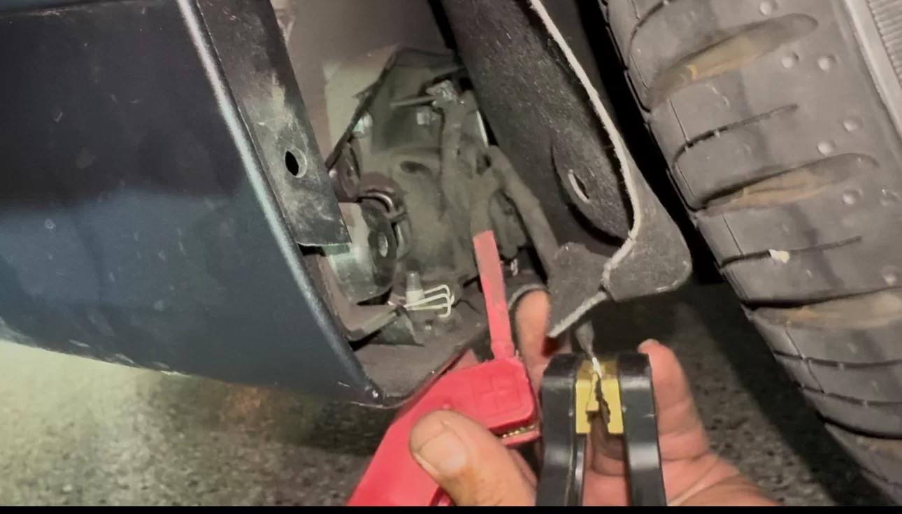

A quick update that hopefully helps any other Lucid-newbs who end up in the same situation, unable to unlock their car… my tow truck driver jump-started the 12V battery located behind the rear passenger wheel well, accessible via a pigtail with positive and negative leads. This eventually unlocked the car and allowed me to drive it out of my garage and onto the tow truck flatbed to be taken to service center. My Costa Mesa service advisor has been great so far. Hooked me up with an Enterprise rental pickup right away.
Apparently the root cause of my dead 12V battery is that I live in a 3-story townhouse where no matter how far I keep the keyfob from my attached garage, it’s within 40 ft m my Lucid which causes it to detect presence and constantly wake the car up. I’m shopping for a signal blocking pouch for my keyfob that is supposed to help prevent this from happening again 🤞
This is not correct. The car eventually turns off passive unlock after a number of “failed” unlock attempts, and you get a push notification. It does so specifically for this reason.
You may be waking the car up, but that is not what killed your 12v.
“Faraday pouch” is the term to search.
