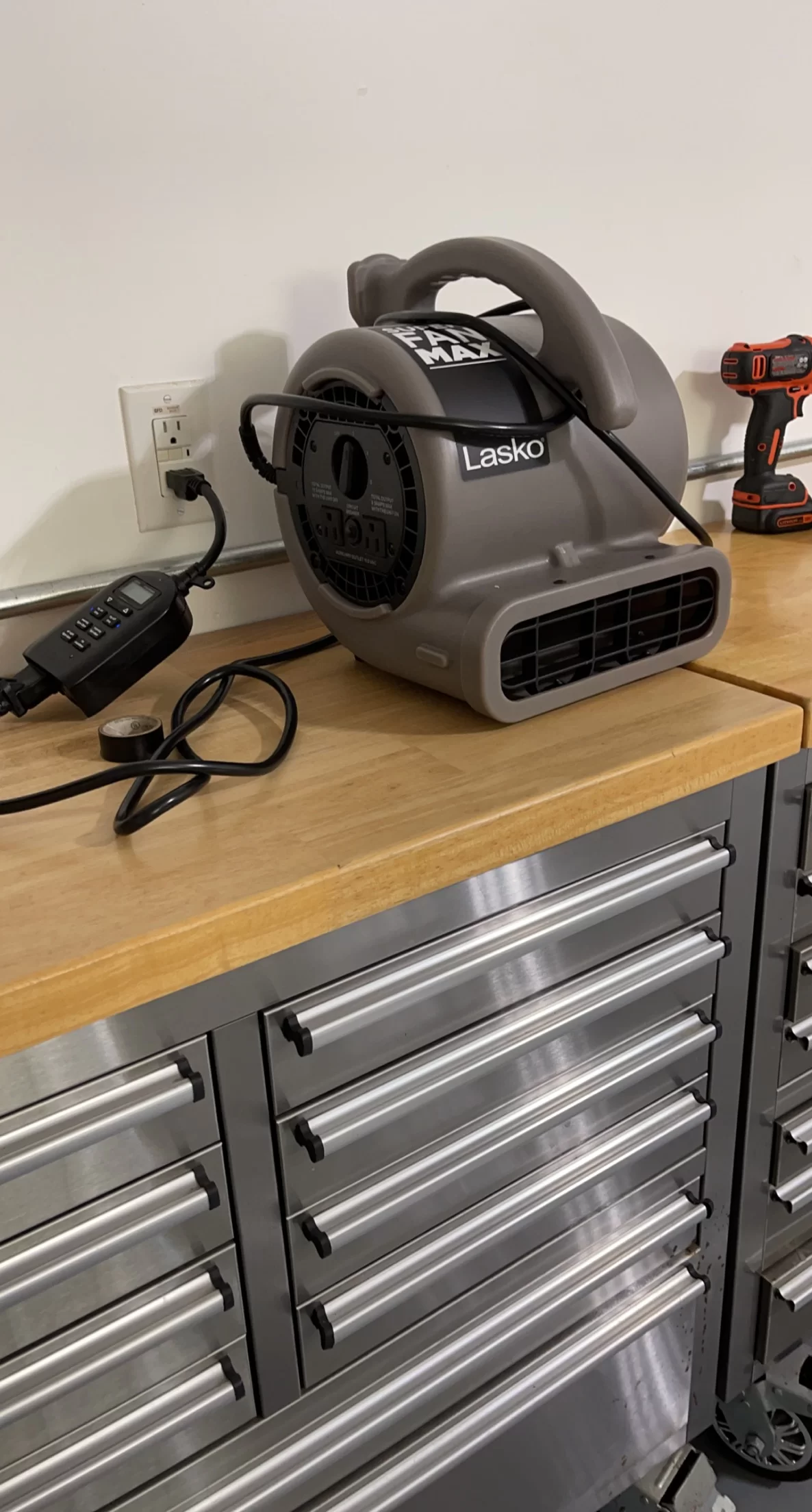

I have this small industrial fan timer in my garage from 12pm to 4am on GFCI outlet. It help make garage 5~10 degrees cooler and lesser AGT vampire drain. Small investment from Costco.

Fans cool by blowing air by a person but don't cool the room directly (to my belief). So how do you get a ten degree drop from just running a fan?

@Tesla2.0 where is it moving air to? Just around the garage or is it venting air out through a door or something else? Something like this could be an option for me.
Garage door is closed, I don’t have exhaust vent. In late afternoon, I will open a little garage door. It give general cooler feeling wheh air inside is circulated.
