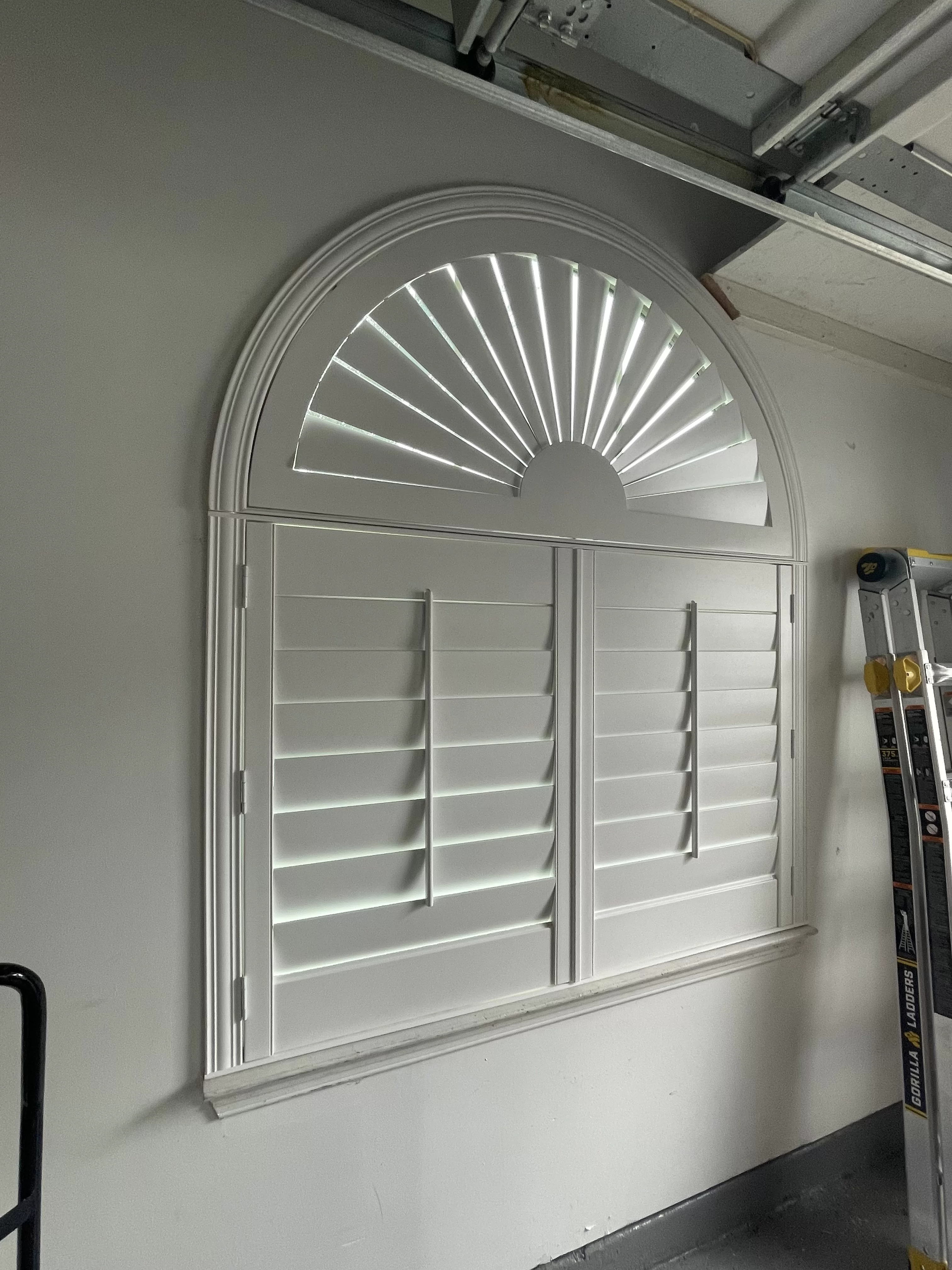

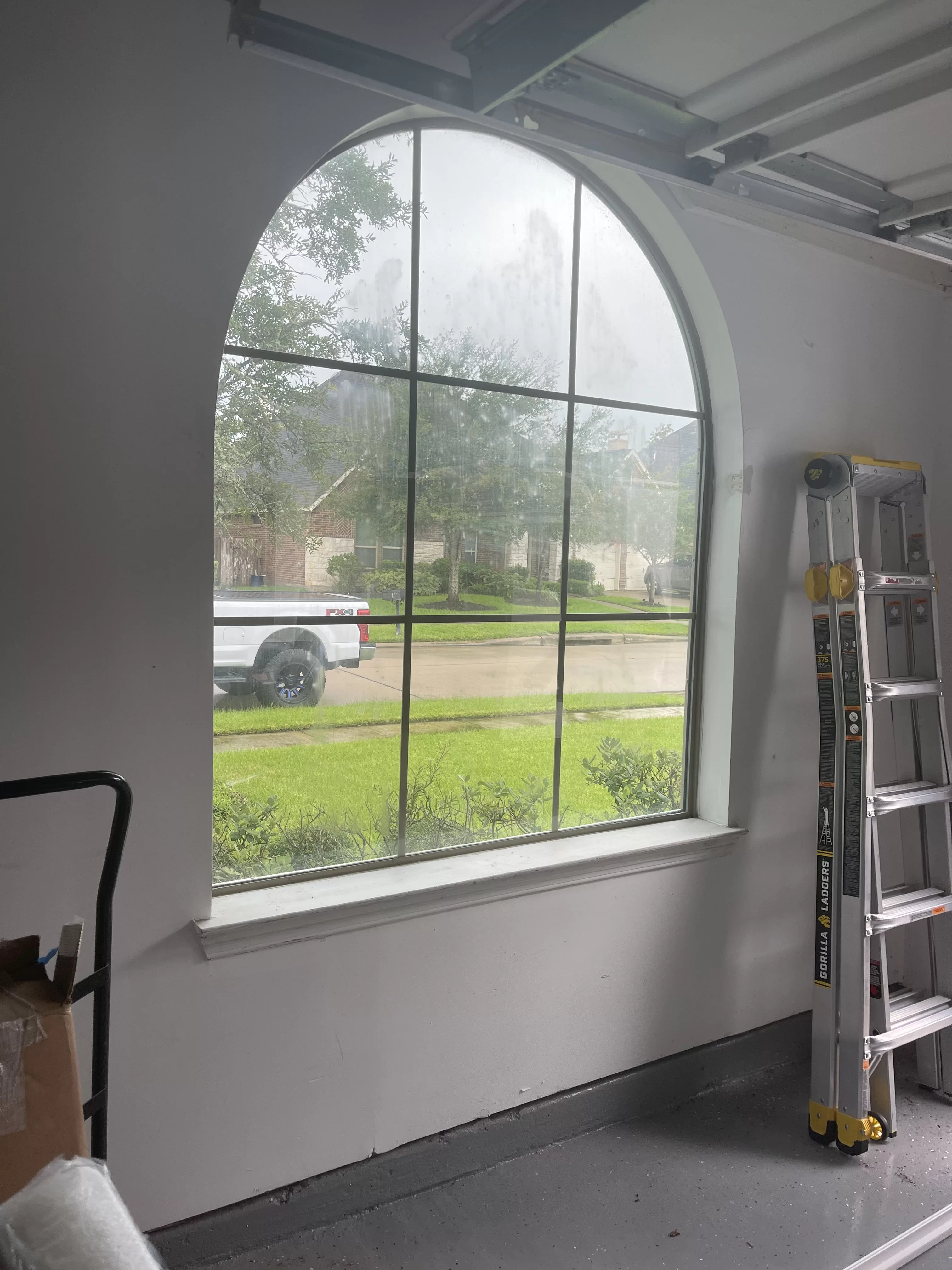

I have a huge glass arch window facing SW and garage facing W. My wife took out the tree in front of that window. I have ordered a shutter to block that window then insulate garage door. My last resort would be air hawk or exhaust vent. I have a non accessible attic above that garage.

to get the shutters in to replace my Venetian blinds and open arch in garage.

I see you took the pictures during our last monsoon storms. Great rainfall and green desert and mountains.
