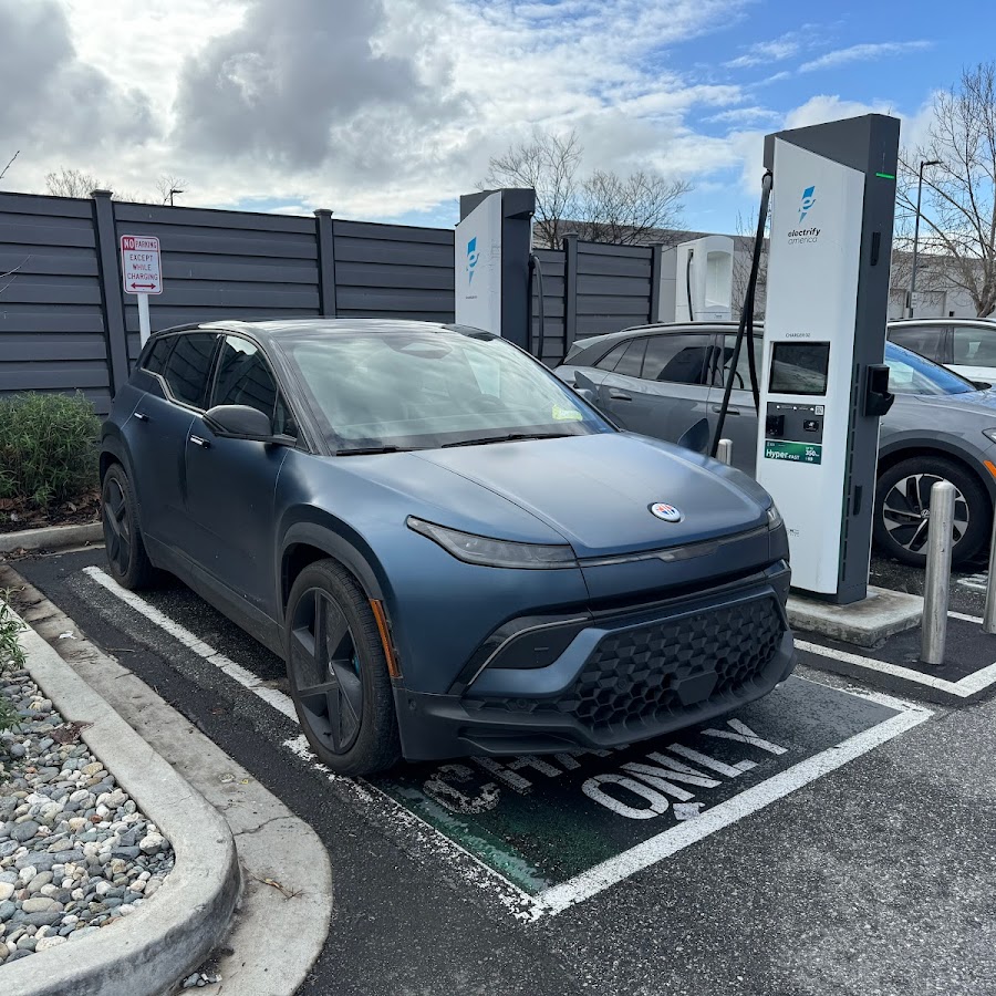

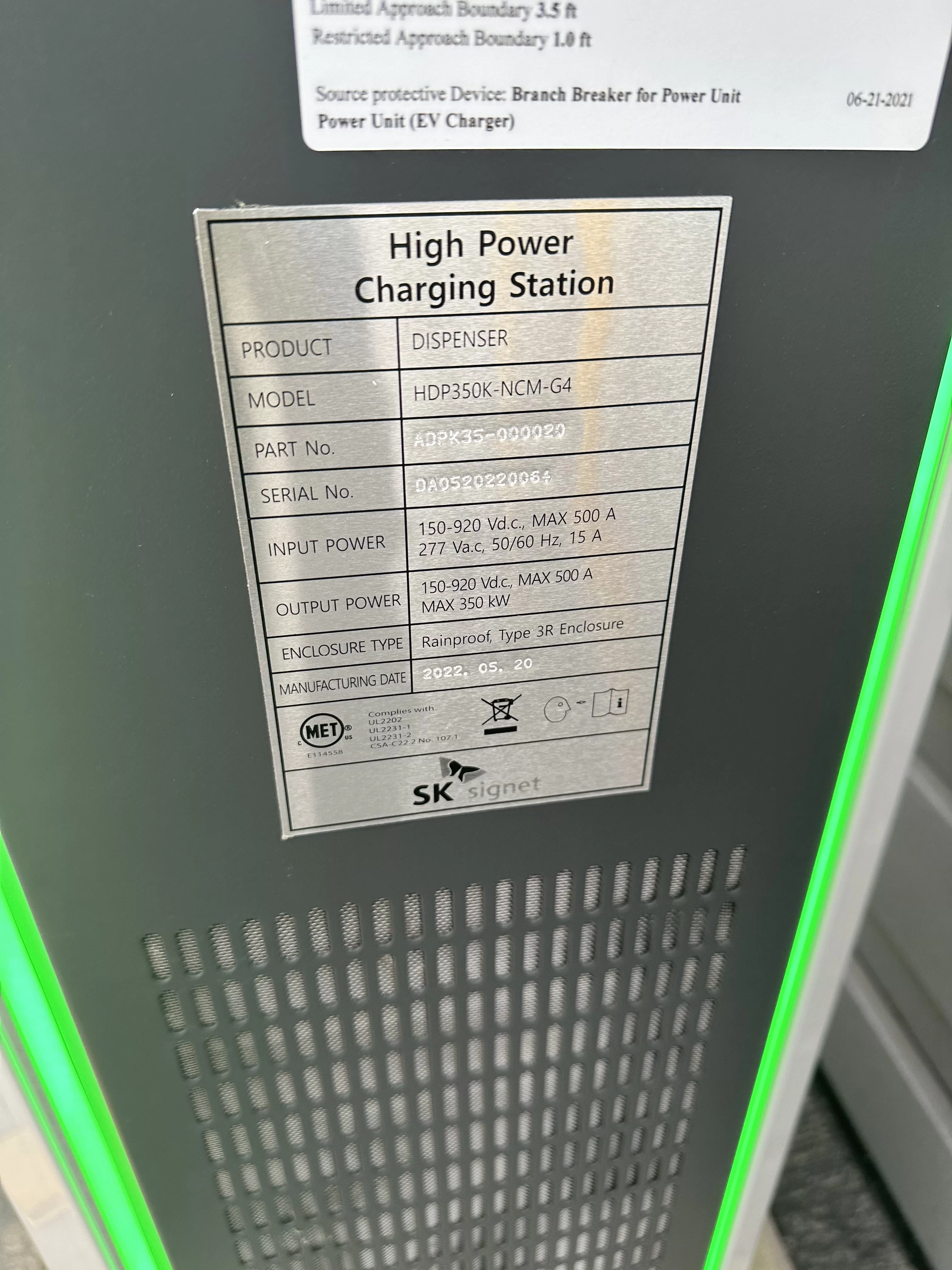

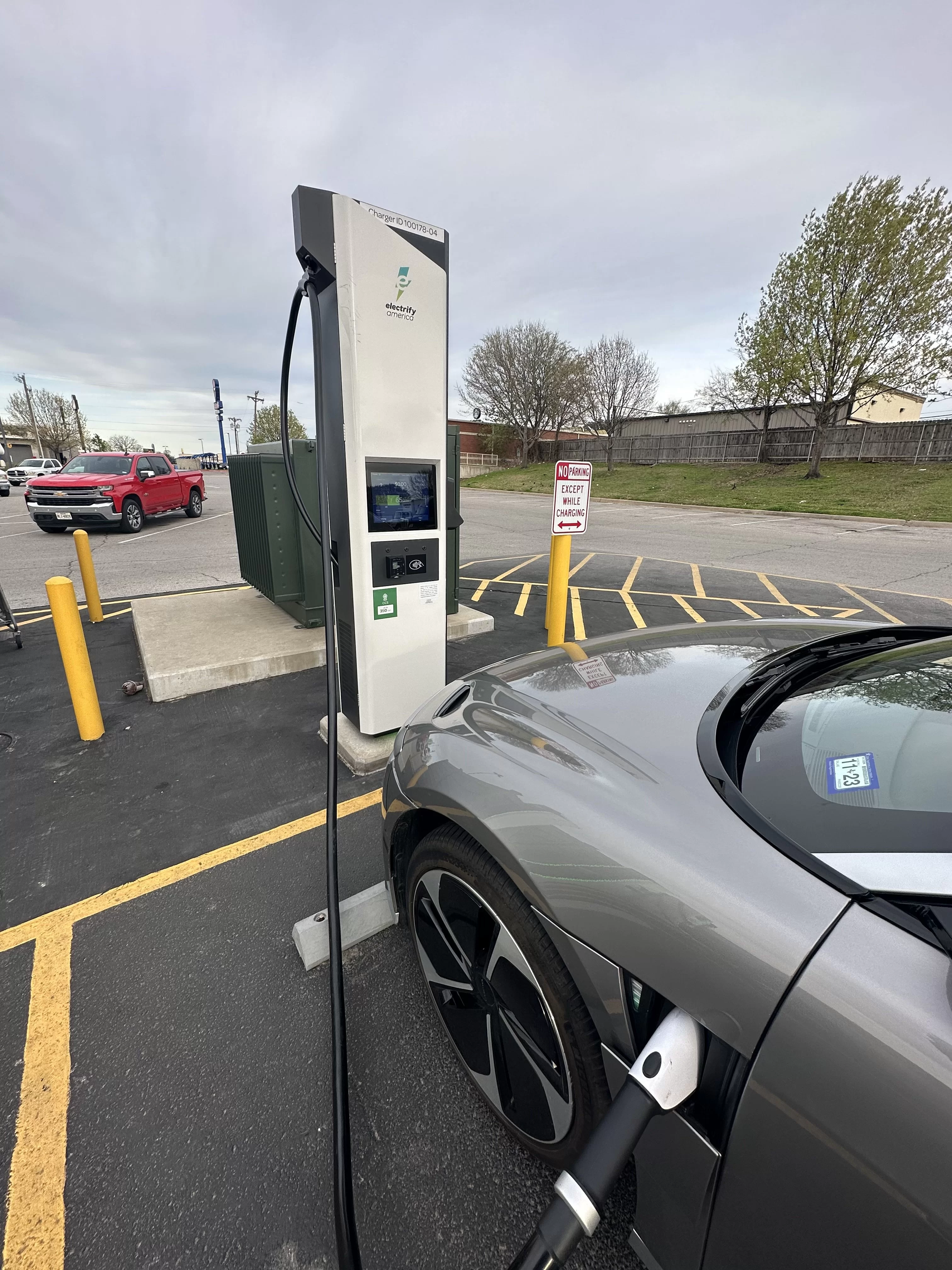

Thats great! Glad it worked for you! I actually went to Houston and back this weekend and PNC worked in Huntsville and Ennis. I'm still on .55 as my VIN isn't included in .56 but it seems like I don't need it. Ennis has the brand new EA SK Signet chargers:
View attachment 10511View attachment 10512
You are actually using my favor stall #4 in Ennis. That stall never fail and consistent fast output whenever I go to Dallas.
It was a lucky choice on my part! All four stalls were open when I arrived.
