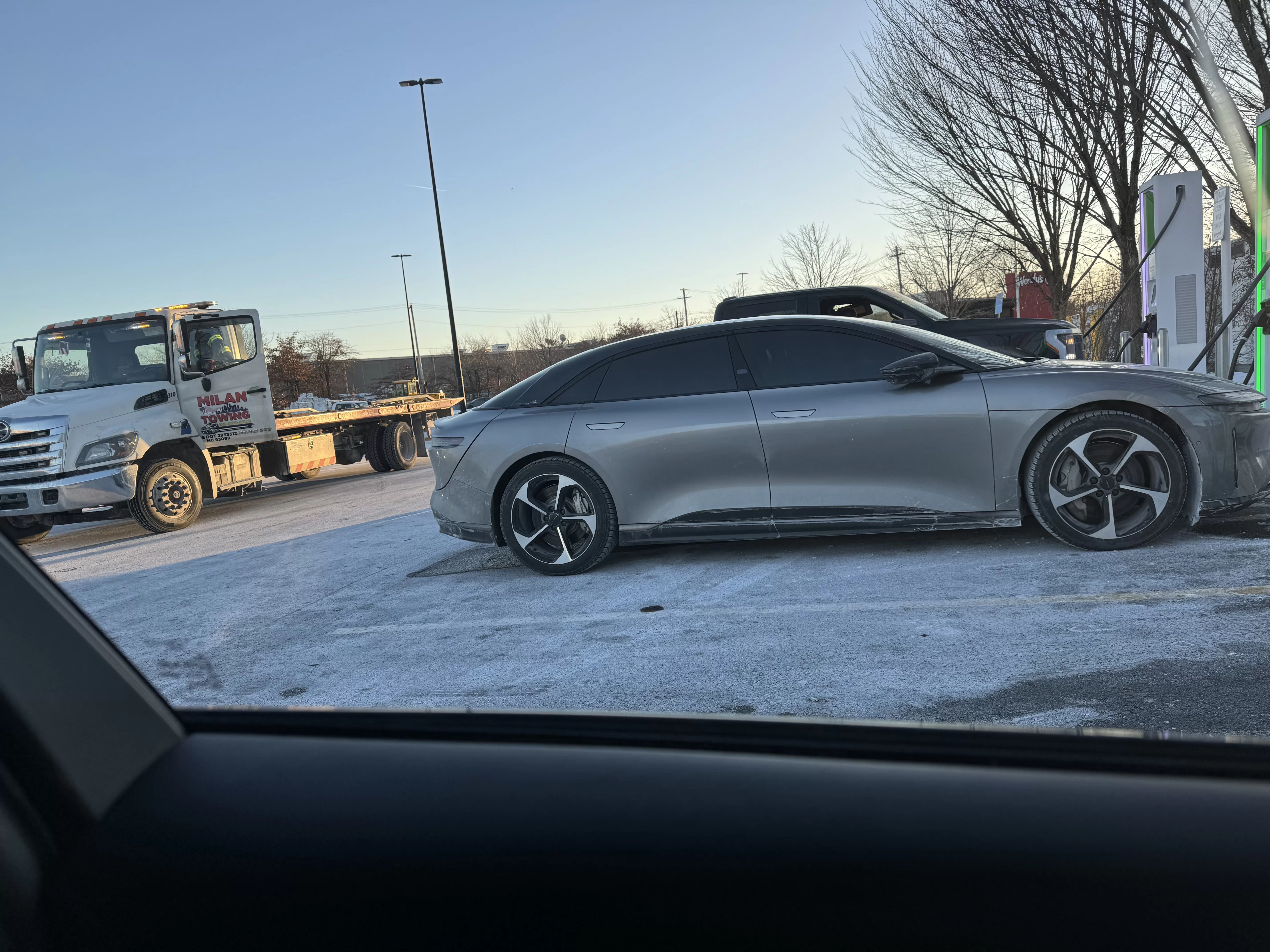

This post is not about my car, which was charging just fine at my local EA at 4pm today in 20 degree temps, but the Lucid that was next to me. I thought everything was fine until I saw a tow truck pull up! View attachment 17793
The owner was not there, I looked at the charger and it had been there 298 minutes and incurred $118 in idle fees! The car was dead, locked, and the charging cable was stuck, with a line of irritated EV owners waiting for the spot. The poor tow truck driver had never seen a Lucid before, and there was a bit of a language barrier. I called Lucid service to help him out and they answered instantly, pretty impressive for 4pm on a Sunday. He didn’t understand there was an emergency release for the cable, which you can’t access in the frunk if the car is completely dead, but then Lucid told me the 12V battery on this car had died so it just needed a jump and should release the cable. I showed the tow driver the section of the manual showing how to jump the car and he thought I was crazy when I said the 12V cables are behind the back right wheel well. It’s not easy so I don’t blame the guy for initially not wanting to let me help him out because this car is Area 51 level engineering. I moved my car so others could charge, and a line of EVs backed up. He initially wanted to leave and say he couldn’t figure it out and he had two other jobs, but the Lucid employees were persistent and kept him on the line, and finally he agreed to let me show him how to jump the car. You have to pry out with a flathead screwdriver the bottom 3 plastic wheel well clips behind the right rear wheel, it’s a very tight spot, then you have to pry out both plastic buttons that secure the red and black 12v cables, then connect red then black (no ground!) and use a booster box to jump it. Finally that booted up the car and released the charging cable and Lucid service was then able to remotely unlock the car so he could tow it. While all this was happening the car got quite a lot of attention (luckily my fully functional GT was there so it didn’t look as bad), and this WalMart EA stayed on script and sure enough a crackhead on a bike came by asking everyone for $. An Ioniq 6 owner made her day and gave her some cash. I hope whoever this Lucid owner is that their car gets to Natick OK and it’s just a silly 12V issue!
Also, before anybody levels any criticism, 12V batteries die on ALL cars ICE or EV, especially when it’s been 13F out for days. There’s already been reports of KIA EV9 owners having 12V die 2 weeks after delivery, so this is not a Lucid problem. If yours dies and you ever need a jump, the instructions are in the manual under “Roadside Assistance>Instructions for Transporters>12V battery” and there are illustrations. You’d probably do best to try and be with the car as I wouldn’t expect any tow driver is going to be able to figure out how to jump it without guidance!

The Tow driver had a Milwaukee portable jumper, not sure the power on it but once it was connected shortly thereafter the doors unlocked and car came online, stayed online.
