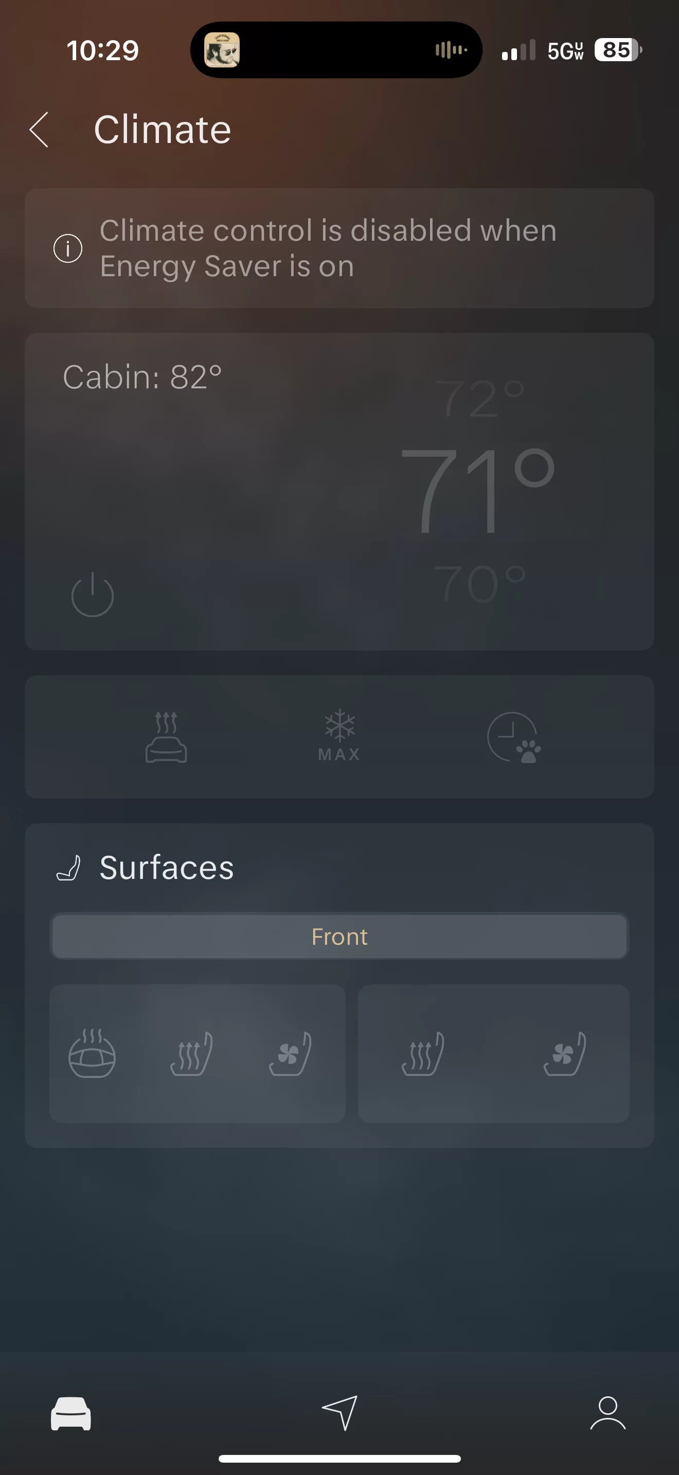

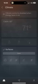

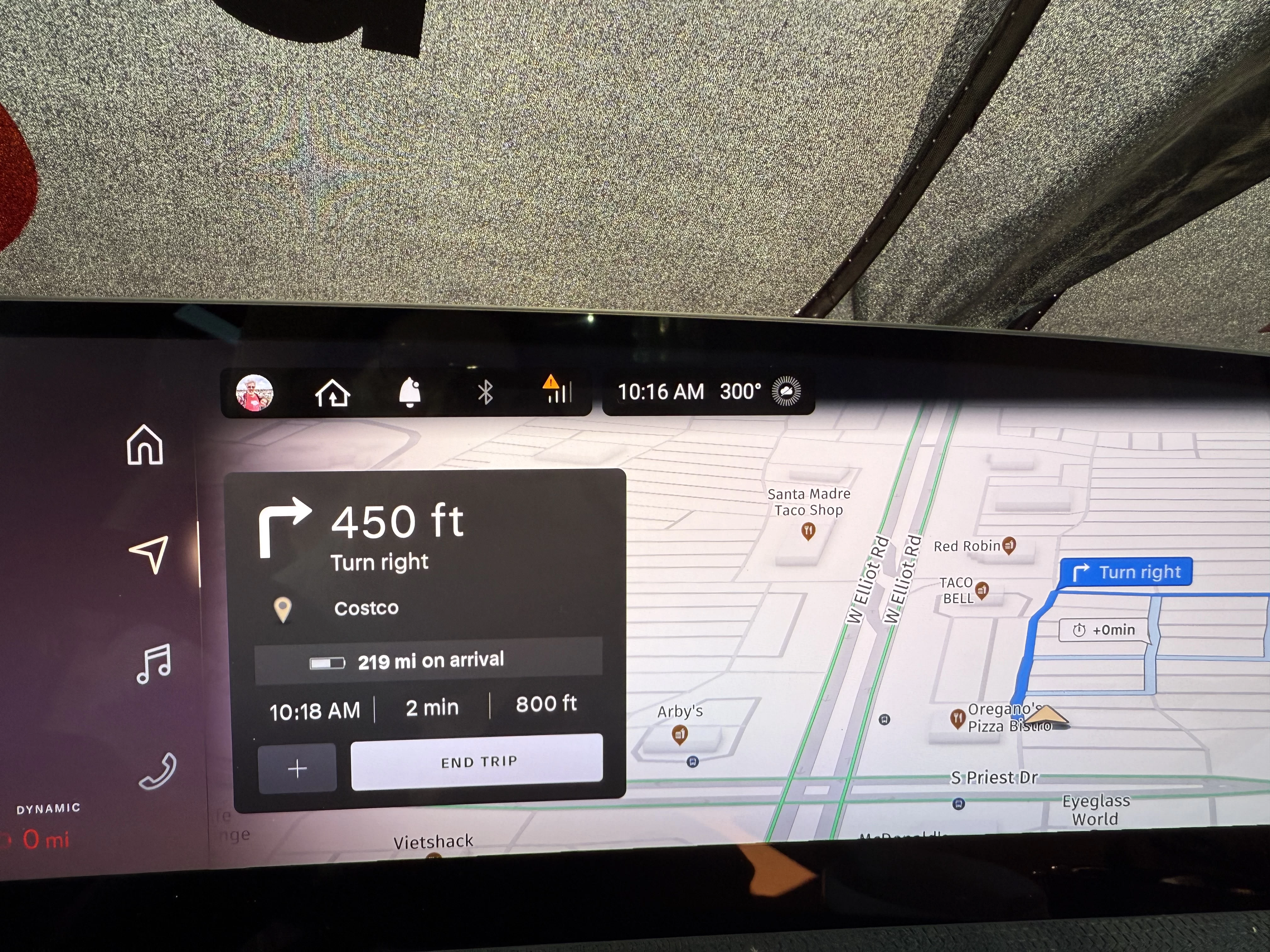

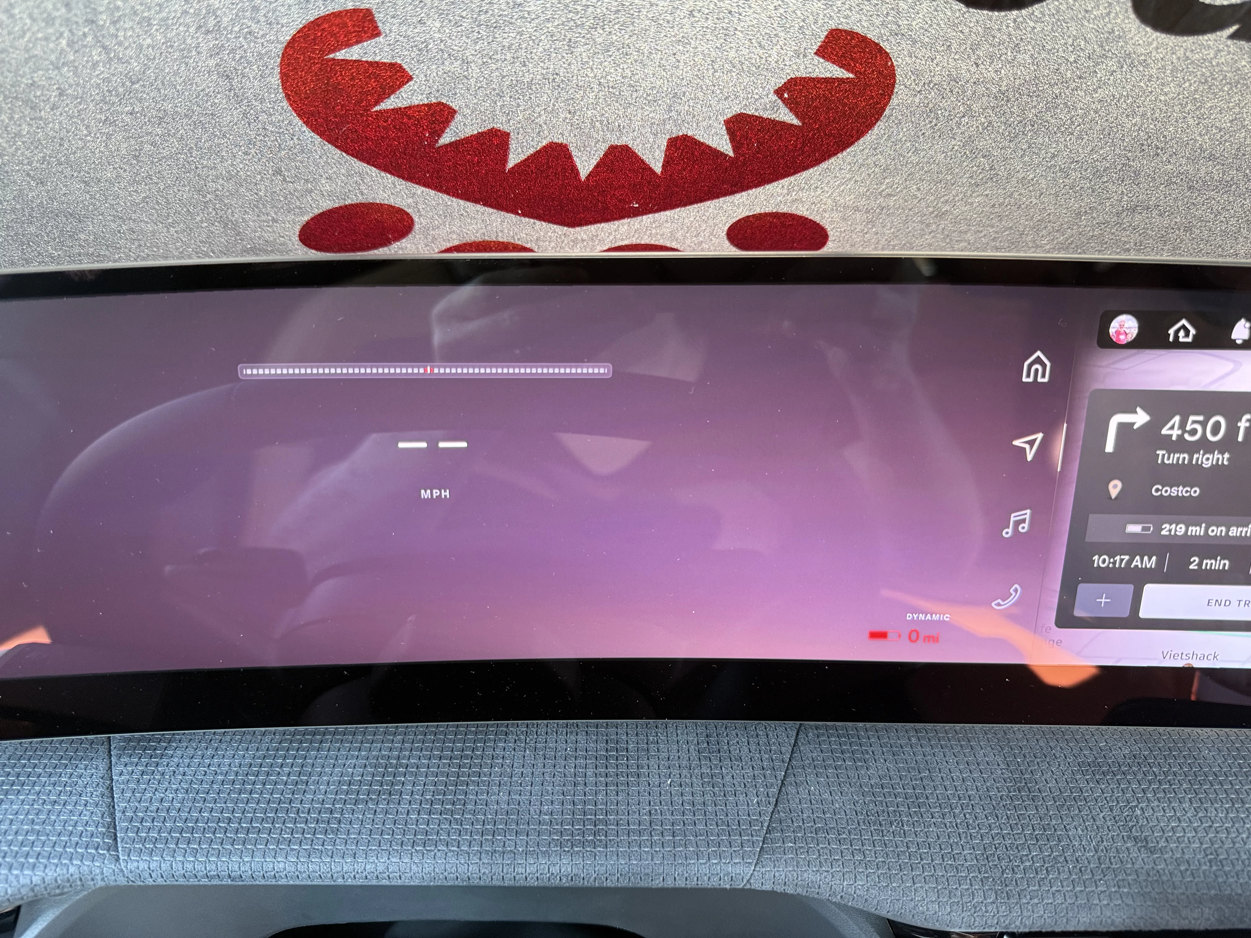

Do you have a specific service person at your service location that you can call? I had near this exact same thing on Friday. The car opened and the center dash screen said zero miles in red. All other screens looked normal but nothing would work. The a/c was on but I could not adjust via the app.
I called my service person and they pushed something to my Gravity and I was up and running in about 30 minutes.
