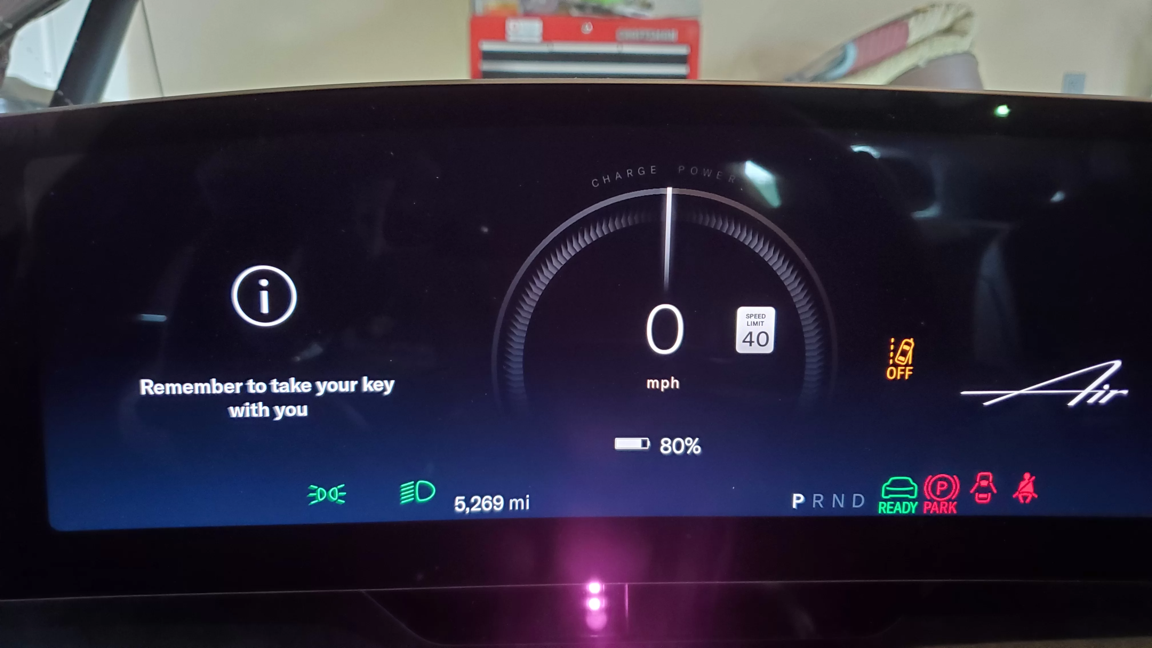

When set to 80%, or daily, it gets to 80% drains down to 76% then recharges back to 80% approximately 3.5 hours. I'm going to test starting tomorrow night if this is consistent.
Here's the issue:
9 kW for 3.5 hours of charging again is $4.095 here, $124.64/month and $1,495/year
If one of the purposes of going electric is being responsible this is a waste of energy.

Here's the issue:
Something is very wrong if it takes 3.5 hours to add 4% to the SOC with a 9 kW charger. This should take about 35 minutes assuming 85% charging efficiency.
