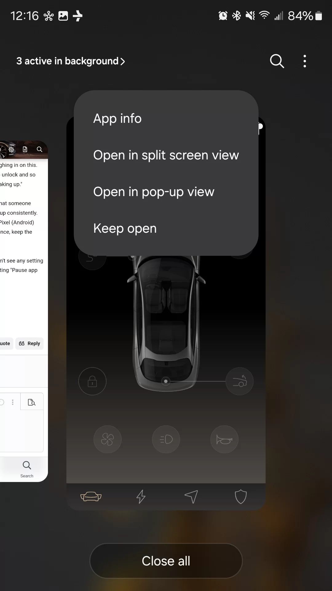

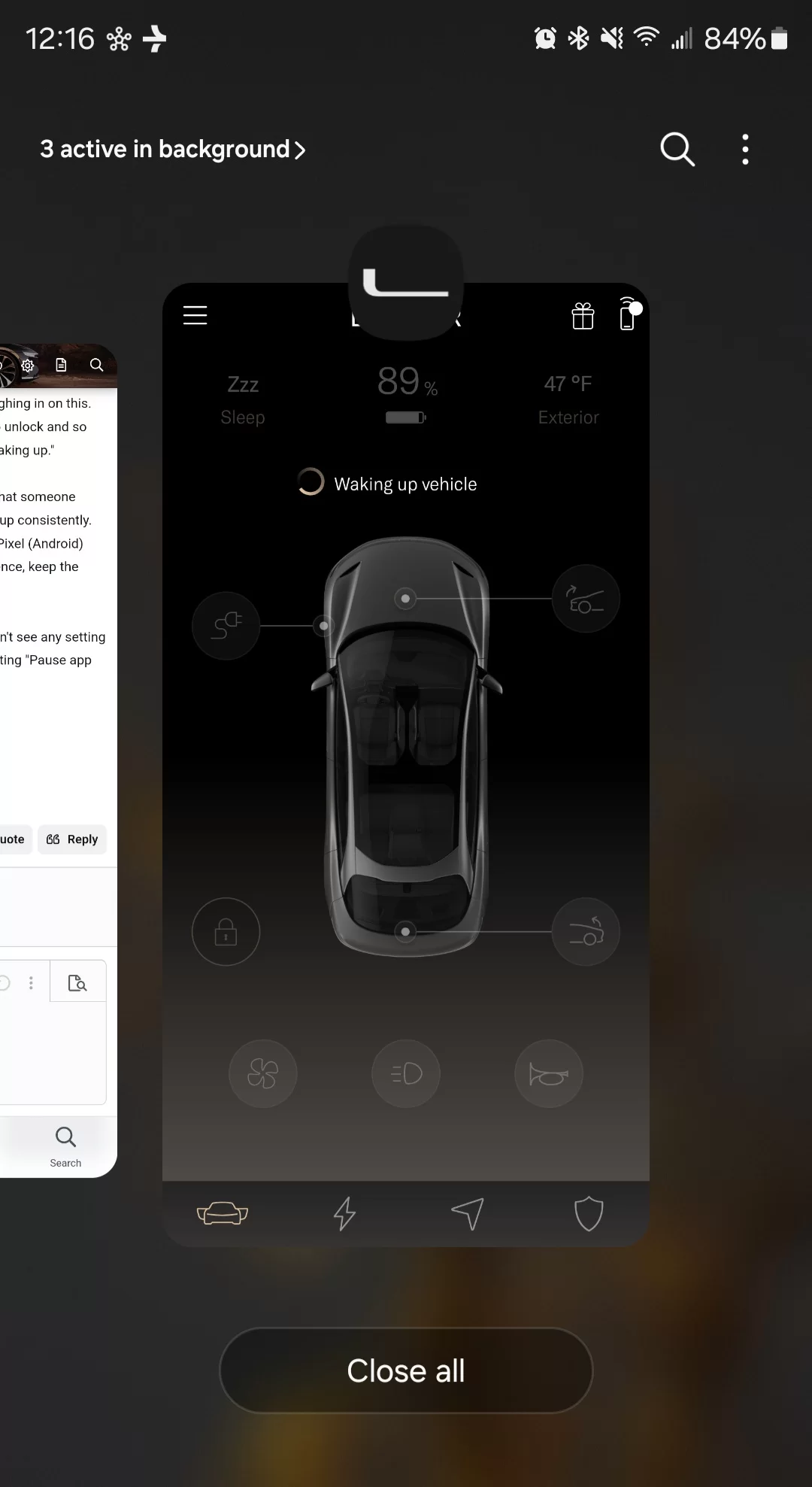

What you need to do is go to the app selection menu- on my Samsung it's the sideways hamburger to the left of the home button and select the lucid app and tell it to stay opened. Screenshots attached if helpful. You'll see a lock on the icon if successful.
What you need to do is go to the app selection menu- on my Samsung it's the sideways hamburger to the left of the home button and select the lucid app and tell it to stay opened. Screenshots attached if helpful. You'll see a lock on the icon if successful.View attachment 24989View attachment 24990View attachment 24991
Thanks Pyle. I have something that looks a lot like that first screen shot. But nothing in the hamburger selection that allows me to keep the app open. All I have in the hamburger is::

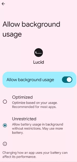

I found this setting in Battery Management:
I just now changed to to "Unrestricted" from "Optimized". Let's see if it makes a difference.

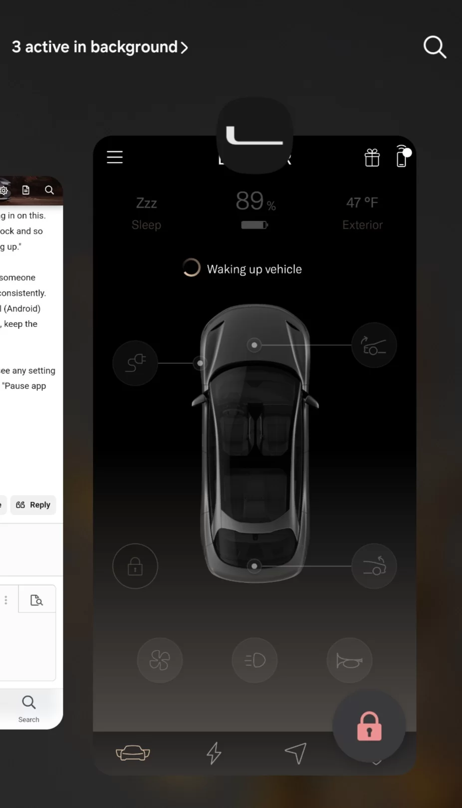

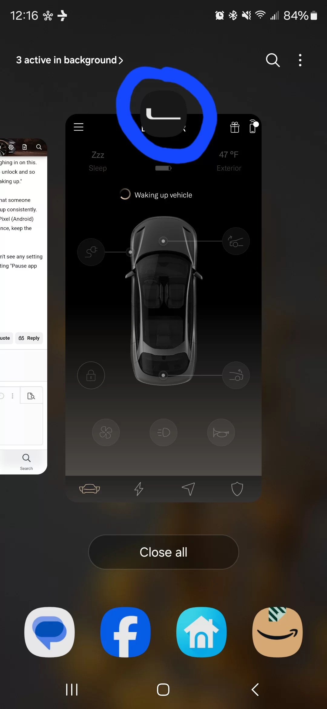

Sorry I wasn't clear. To bring up open apps on a pixel follow these directions, then tap on the lucid logo at the top of the screen to bring up the app monitoring menu.
  1. Swipe up from the bottom, hold, then let go.
    • If you’re on Android Go with 3-button navigation, tap Recent apps
  2. Swipe left or right to switch to the app you want to open.
  3. From this screen select the lucid app logo as highlighted below. You should see the prior menu that I screenshot'ed above
Tip: Another way to switch is to slide the Home button to the right. See an interactive tutorial on how to switch between apps.

I think half of my "early-adopter" problems (as Kyle has in his 2025 GT video review) with the mobile key were caused by not knowing the Lucid app was running in the background on my Android phone .
This is why the car kept unlocking / locking when I was near. The key fob, running on radio, was doing the same thing, but you can't "turn off the app" as on the phone, so you need to put the fob in a Faraday cage when you are near the car but do not want to enter, or remove the fob battery.
so, if you want to stand around your AIR and make a video : ( talking to you, Kyle )
1. turn the mobile phone Lucid app off. It's probably running in the background off- screen.
2. put your key fob in a Faraday cage.

However, the option to allow Lucid to run in the background "Unrestricted" that I posted on Friday seems to be working. Yet, I think I still get a message from the Lucid app telling me to run it in the background.

No worries Science! I made a quick video on my Samsung that might help. Getting to open apps might be slightly different on the Pixel.
I found this setting in Battery Management: View attachment 25005
Here's a report from ten days after I found that setting. NO JOY! Car does not wake up from Android app or iPhone. Presumably the app is running in the background on Android (Pixel 6).
