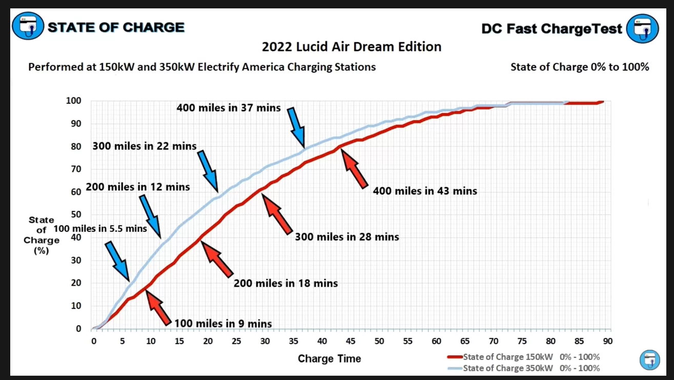

State of Charge also did an excellent comparison between 150 and 350 charging:
Spoiler alert; unless you really need to charge and dash, the difference between the two is not super substantial:
The 150 vs 350 charger I have dismissed somewhat as I am sure there will be firmware upgrades to the Lucid that will allow quicker charging, and a better curve in the near future. I believe the video mentioned this as well. To my understanding, Lucid has limited the rate during the first while to monitor the vehicle and Battery Management. I seem to recall them saying that it likely can take a lot more than it currently allows.
Thanks. This is a very useful chart for me. 99% of the time, all I would want is a quick charge boost so the first five or ten minutes are what I am most interested in.
