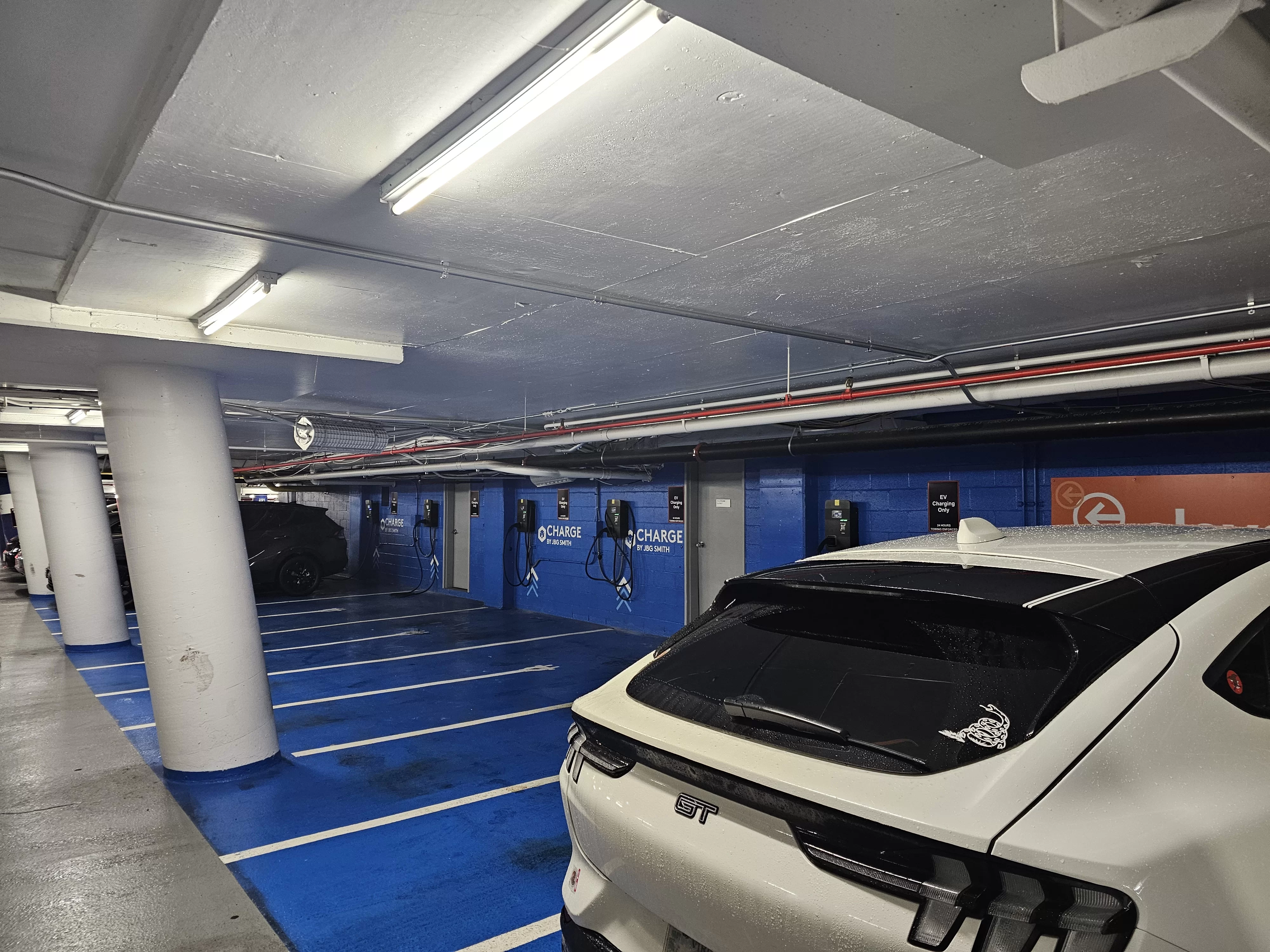

We have a bank of 6 EVSEs at my office building that have been "free" for probably 10 years. I could hardly ever find a spot and usually 4 or 5 of the cars plugged in were fully charged. They arrive in the morning, and refuse to move when their cars are fully charged. They sit there all day. A-holes. I hate free charging.
About a month ago they replaced them with pay EVSEs. It now costs about as much to charge there as the local EA or SCs chargers. It is much cheaper to charge at home. Guess what happened?
