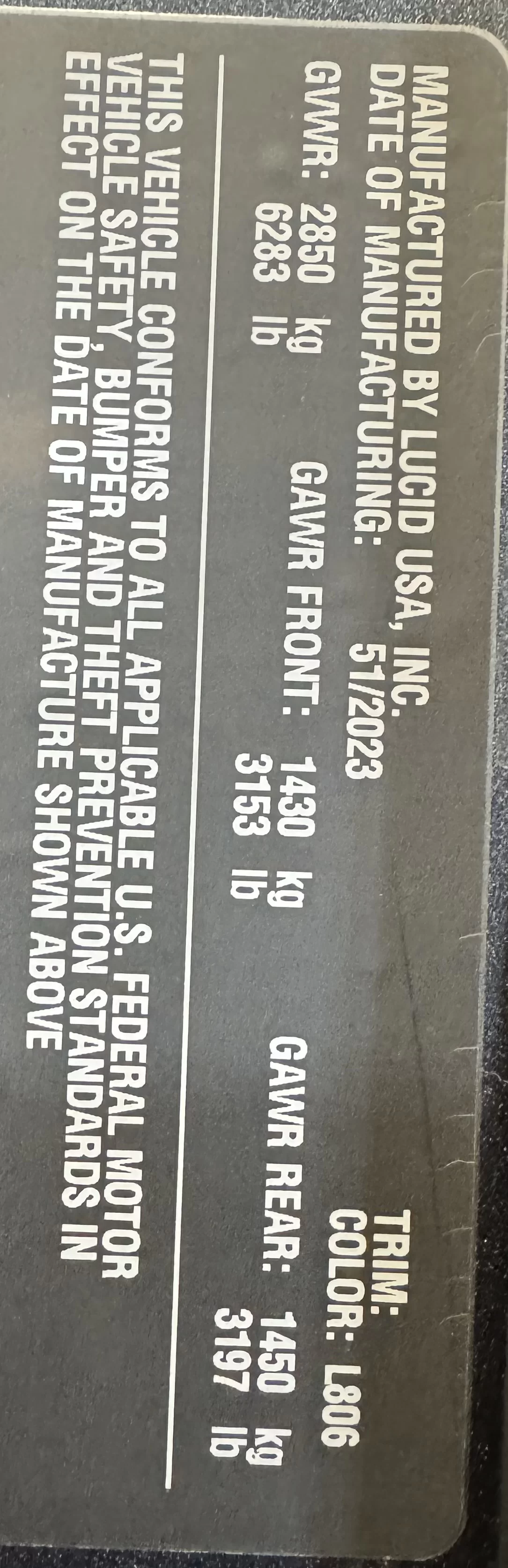

I'm happy to submit my sample, but I first need clarification as to what the date of manufacture is. Normally I thought it was a month & year, but to me this looks more like the day of the year followed by the year. So perhaps the 51st day of 2023? I'm open to other suggestions for dates. Not enough placeholders to be May 5, 2023.

That number may indicate the week, like tires. The problem with this survey is the very small sample size compared to the overall ownership. As you know, folks that have issues are overrepresented on forums such as this.
Bobby, I’d agree, but the 51st week of 23 would mean a manufacturing date well after my car was delivered. I know Lucid was trying to push out cars faster, but this would represent a breakthrough in car manufacturing. ;)
I think the 51st day of 23 makes more sense.
It does make more sense but I have never seen that done although I have seen the week thing done on more than tires.
