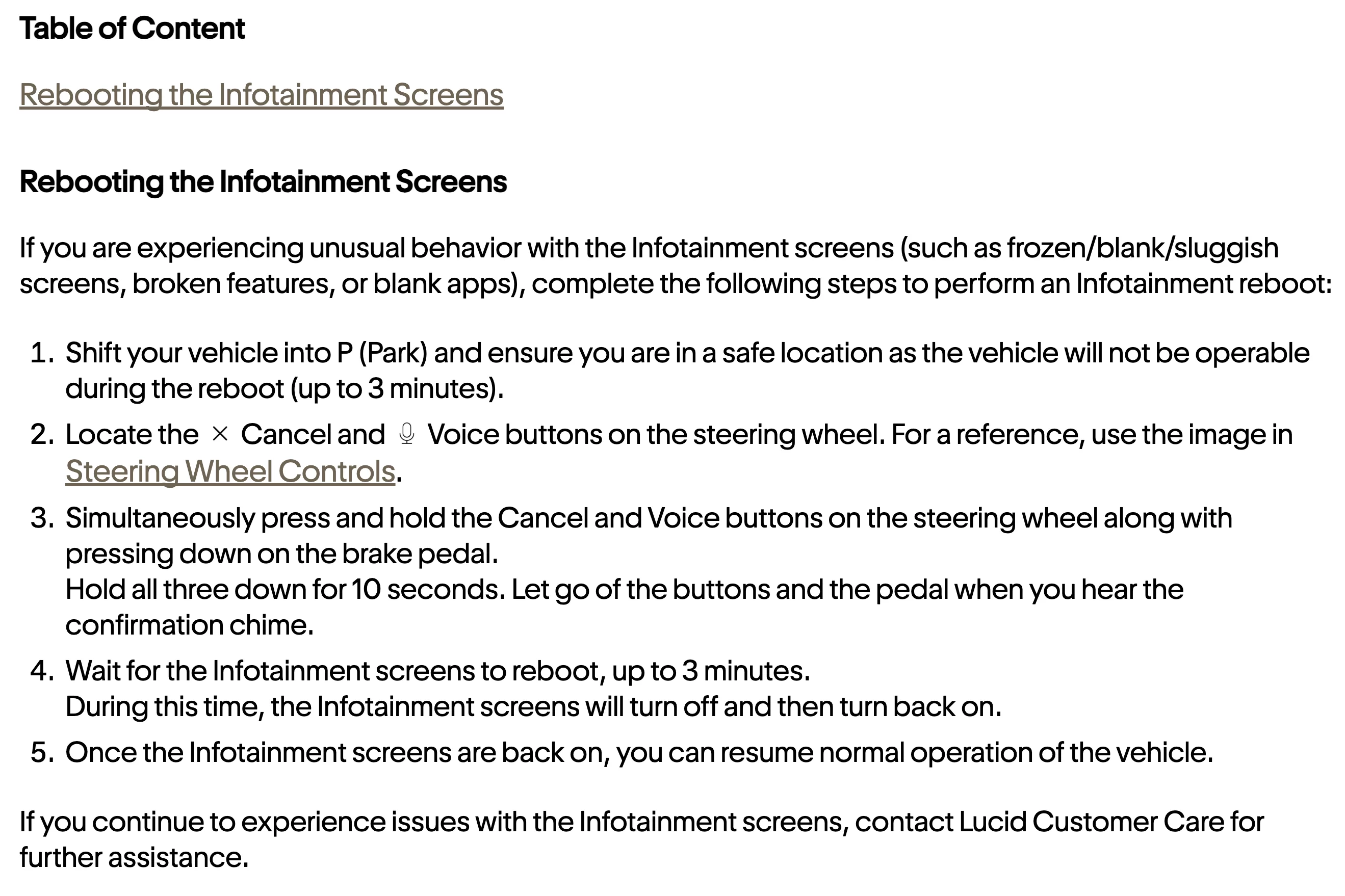

One time, my pilot panel and top right screen went dark while driving. The car drove fine but I could not even change a channel as the screens were down. I pulled over but could not do a logo reset as the screen was non responsive. So I did the steering wheel microphone, cancel button and press the brakes reset described on the manual. Everything booted up after about 20 seconds of holding all three things. That reset worked for me. Maybe also try that next time.

WOW I hadn't heard this one. I guess I missed this reset method in the manual.
Not sure, is it good that we have another reset method or that we keep having to do SW resets.

That's the nuclear reset, and lucid doesn't recommend doing it. Hence why in my post I was asking for anyway to hard reset without it being dangerous to the vehicle.
There needs to be a way to do a full hard reboot without exiting the car.

That is no longer the case. CS and service have both recommended the “nuclear” reset in the past, and it is now an acceptable method of reset, though not the most preferred.
It is unlikely to damage the car, but it may delete logs Lucid would very much want; think of it like unplugging the power cord to your computer directly, without shutting it down “cleanly” first.
That is the only method of “hard resetting” the car other than getting out and letting it fall asleep, to my knowledge.

Thank you! That actually helps a lot and I was scared of doing it in the past. Didn't realize it was like that. Maybe I can run some various tests with a watermelon in the seat and see all the different reset methods and make a chart
Guys if you check your manual on the Lucid App. Go to Infotainment and then to Reboot.
There it is. It works.

Agreed. I had no option as my screens went dark. I stopped on the side of the highway and did this reset. Worked great!
So it is! I pulled it up on the website and took a screenshot just to make it a bit easier to read:
Nice find!
Interesting that it says you'll hear a confirmation chime. That must be new; it never used to chime.
Thanks to both! That reset was never mentioned in the manual before. It seems it's safe enough they're okay with people using it now. That didn't seem the case before. Or at least it was hidden, unless you called into CS
Nice find!
Thank you @Andretex for the find and @borski for the formatting! THIS is a solution I've been looking for because of the bugs that can happen to make the pilot panel unresponsive and therefore access to that soft reset unavailable. I was about to start a new thread when I found this one! Good job!
