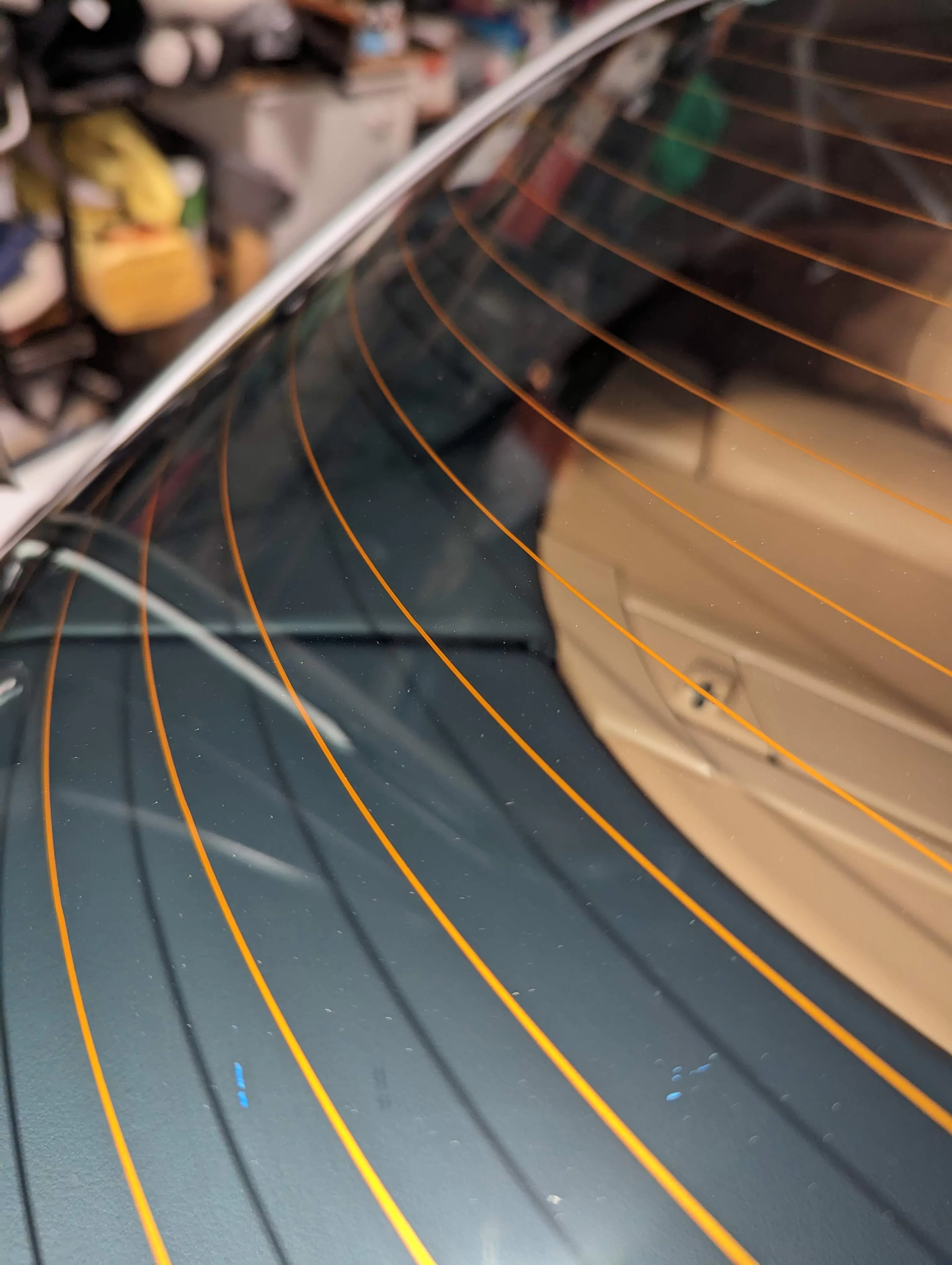

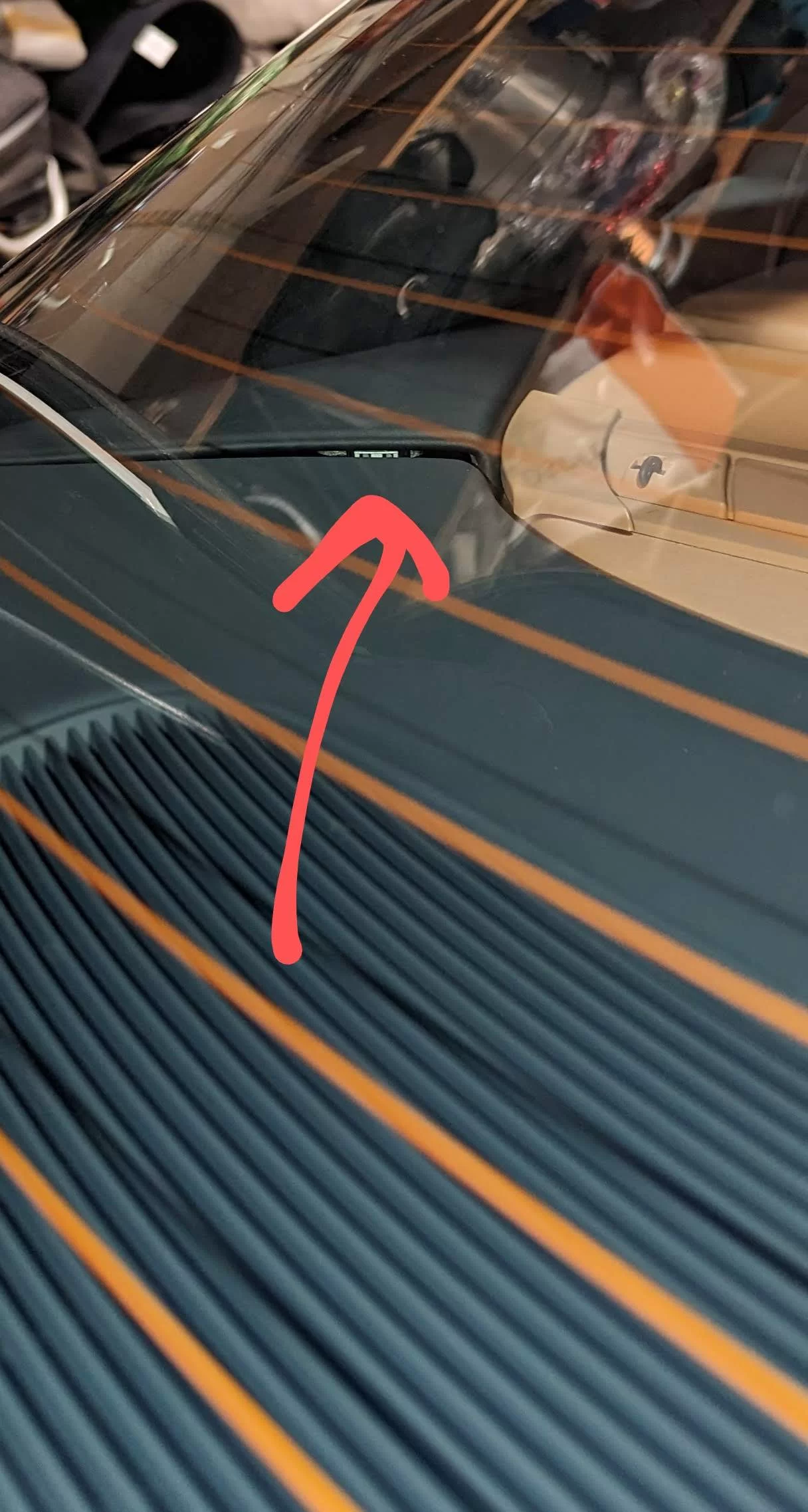

I happened to be putting something in the trunk and saw that the rear deck was installed correctly, I wonder if this may be the source of the rattle.
I went to take a picture of this last night and could not see it until I had the trunk open and crouched down. I wonder if this misalignment might be the source of the noise.
In the picture below you will notice that if you are not at the correct angle you will not see the problem.

The misaligned part may be a separate issue. My car is in for service for this, otherwise I would have uploaded pics of where the glass and rear deck make contact (and consequently there are markings on the inner glass surface left behind from the frequent rubbing).
