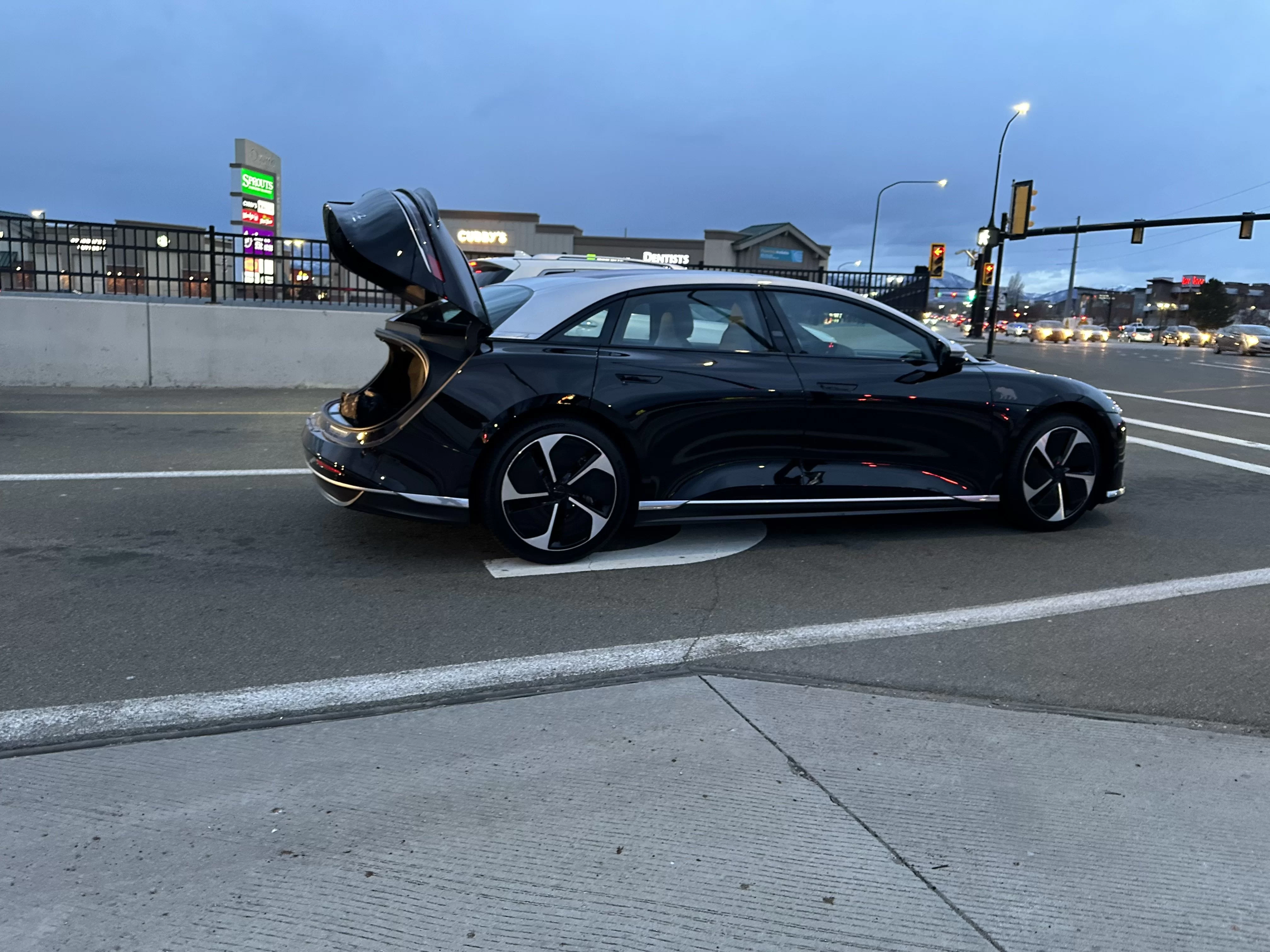

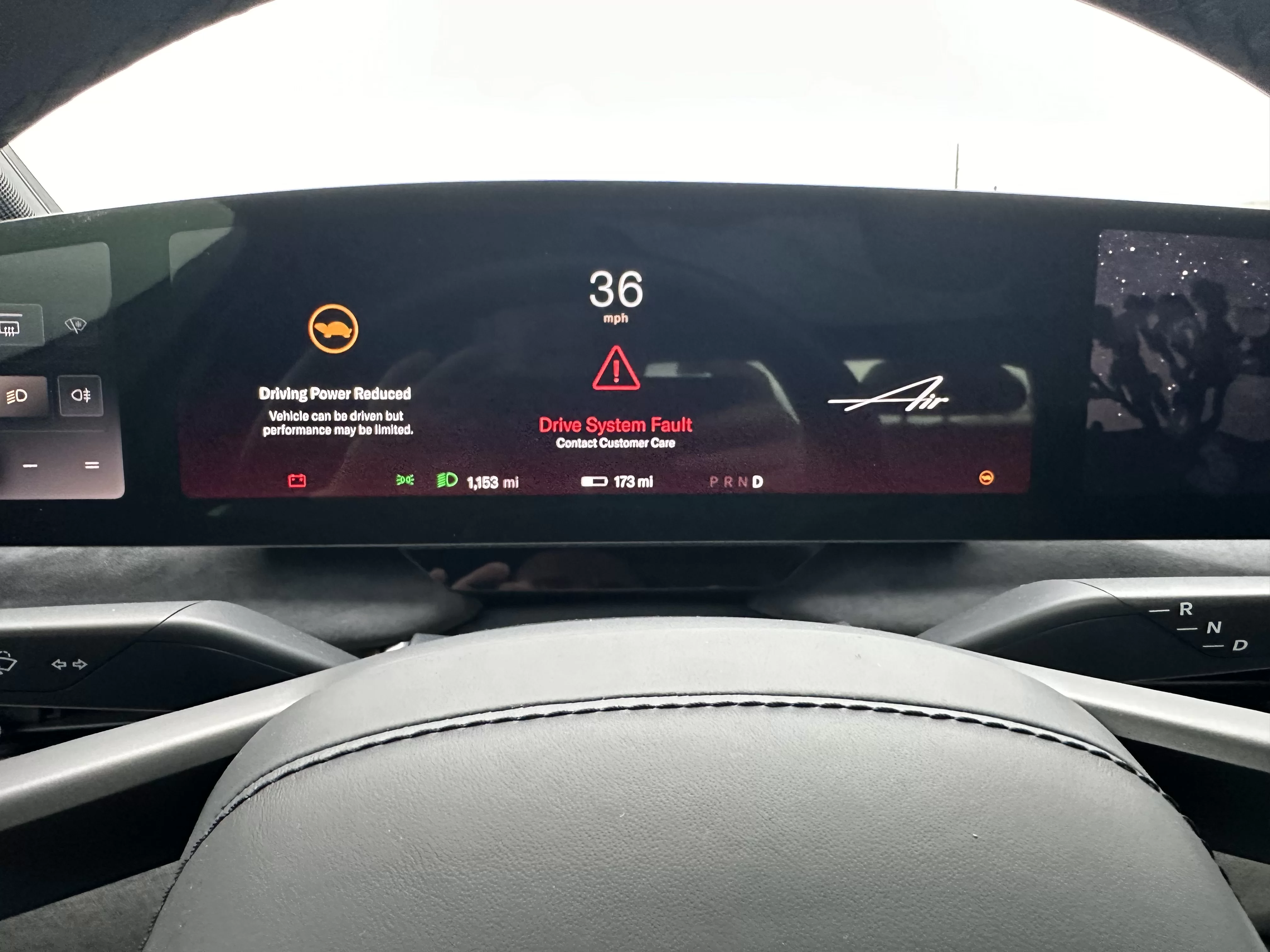

Was doing 80 on the highway and then heard a thunk sound, all screens went black, lost all power which was pretty wild tbh. So I pulled over to the left as the systems rebooted and took an off ramp. Drive system failure. The whole turtle mode thing also came on so I thought I’d be able to drive slowly to a safer spot, no dice. So I ended up being that asshole that has no hazards on blocking one of the lanes. View attachment 18078

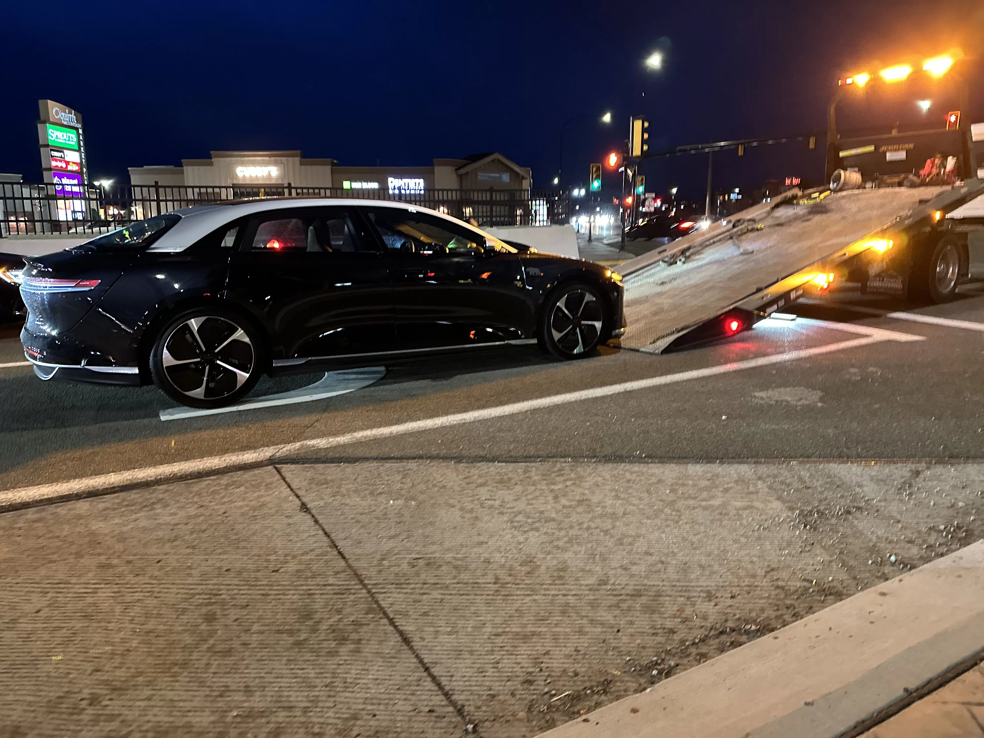

Was prettty freaky, especially with my 11 year old in the car with me. Ended up taking almost two hours to get a tow truck there. Since I’m in Salt Lake they want to ship it to Colorado to diagnose.
Car has less than 1200 miles on it, I’ve had it for almost 3 days. Love the car, but this is a huge bummer.

Towed to service and got an enterprise rental. Probably gets looked at early next week after they dig out of their queue.

Lucid got back to me today. It seems like a fuse blew, I missed the name of the fuse, or the service engineer didn't mention it. Doing some research, I guess Tesla has a pyro fuse that blows and creates a popping or bang sound. They ordered a replacement and will be letting me know if they find anything else as they disassemble the vehicle. Has anyone out there have had a similar issue with a fuse blowing or going bad? If so, was there anything else that was affected by its failure?
So they replaced the Pyro fuse, and boom car fails during validation testing. Same error, no word on if there was a pop sound like before. They have to go back to diagnostics again :mad:.

So they only replaced a blown fuse - a device that's entire purpose is a failsafe in case of another failure that would cause too much current - without trying to figure out why the fuse blew and fix that??? 🤦‍♂️
Chill... the first step is replacing the fuse in case it was just a faulty fuse. Then when it blew again, they knew there was a deeper problem and are now investigating. Bad fuses do happen, regularly.
Take a breath, this is the right order of investigation, lol.
