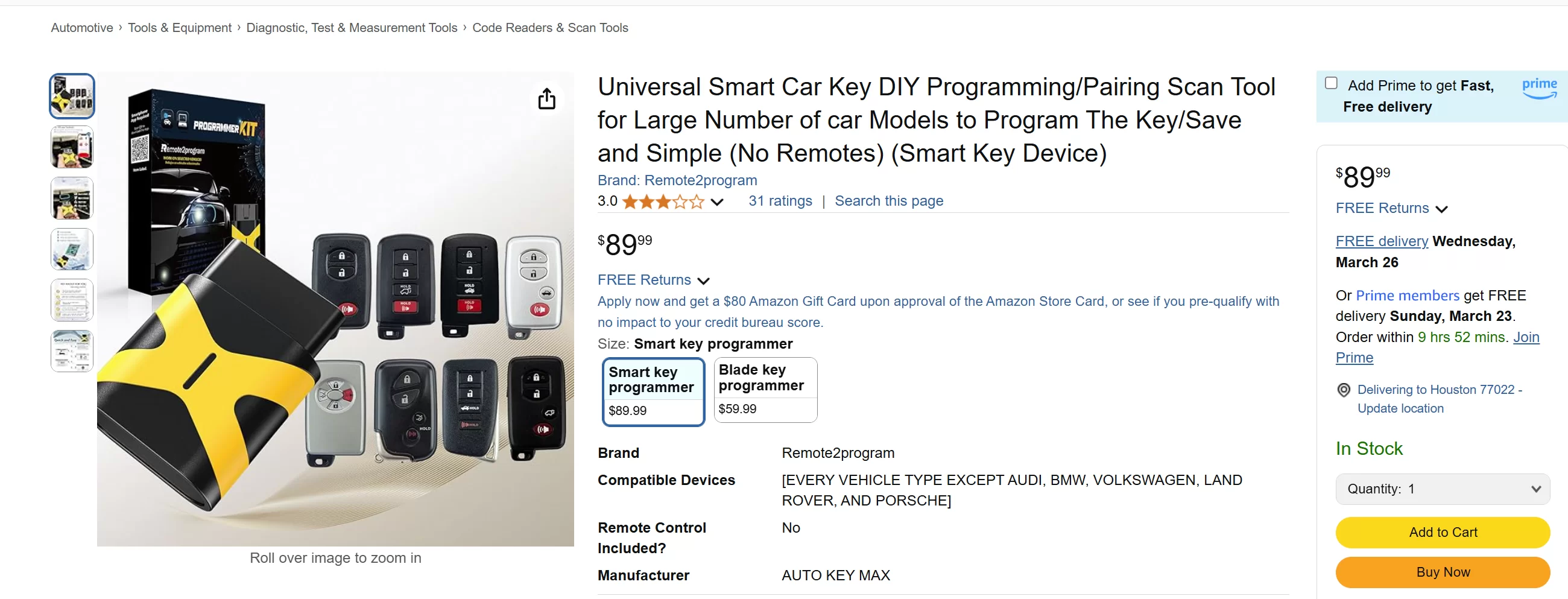

1) I don't think the Air has an OBDII port.
True....but there is actually a OBDII to Ethernet converter. And the new FOB will have a couple of years of battery life!1) I don't think the Air has an OBDII port.
