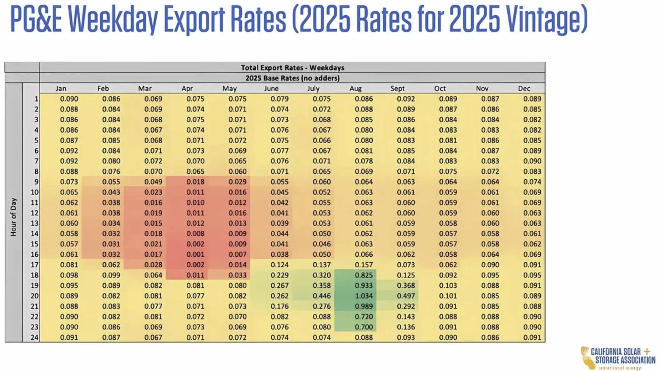

Due to a recent PV installation, we are on E-ELEC for electricity we buy, but are reimbursed at NBT rates for excess electricity we sell. NBT rates, which are based off wholesale costs to purchase generated power, can be as low as one-tenth of a cent per kWh at certain times for certain months (the red area in picture below), thanks to the large amount of solar PV installed in the western part of the USA. I imagine costs will someday go negative as it has from time to time in Europe - you'll be paid to use power.
We generate a far amount of excess PV power most days of the year and I'm careful to dump this into our EVs rather than letting it flow to the grid far too cheaply. Since I'd make very little by selling it to PG&E, how much does the power cost me to charge my cars? I'm not motivated enough to figure out my amortized cost per kWh for PV energy for my system's expected lifetime, or mine!

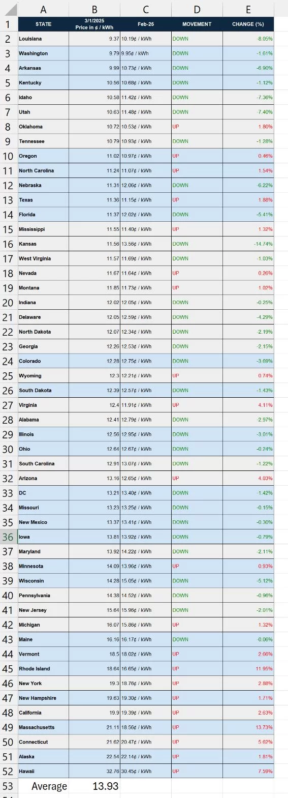

California is in the top five most expensive states (including Hawaii and Alaska) for electricity according to the "Electric Choice" website https://www.electricchoice.com/electricity-prices-by-state/ Part of what Californians are paying for is the result of "kicking the can down the road" for so long when it comes to maintaining the electrical infrastructure.
Here's that data ranked from cheapest to most expensive. The average price is 13.93 cents /kWh with the median being 12.4.

That chart is wrong for Rhode Island. Prices (generation + distribution charges) is like $.32/kwh in winter and $.24/kwh in summer. Winter is higher due to large natural gas contribution to generation, and NE nat gas prices rise in winter due to heating demand and limited supply. No consumer TOU plans either.
I'm not sure who in CA is paying 19.4 cents per kWh. I'm paying an average of about 50 cents.
